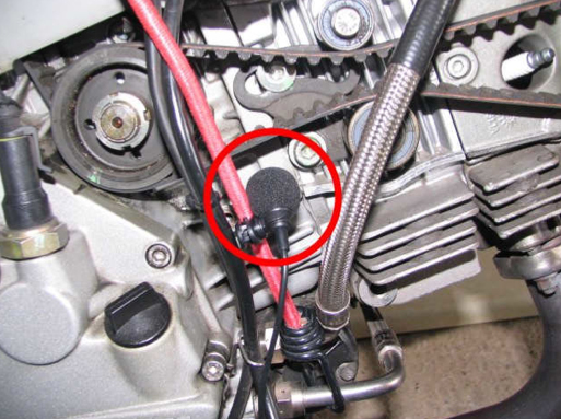

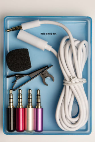

  12. Do you think adding a microphone would help in this respect?
    Just like using a laptop with a microphone on a lead so you can get close, maybe doing the same on the phone would work?
    Like this kind of thing:
    (taken from this page: Google Maps)
  13. Sounds like good news.
    Thanks for the feedback
    i was thinking that you can't really add a microphone lead to a phone but of course some earphones have microphones incorporated for hands free calling, so maybe it is possible.
  14. It can be done but you need to use an adapter to use an external microphone. Here's a Youtube clip which explains why and what you have to do.
