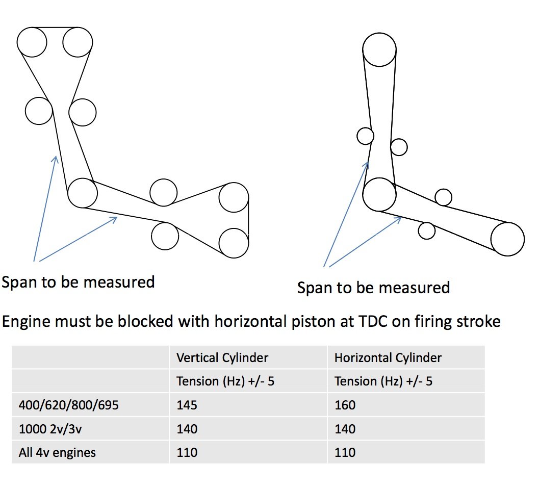

  4. I guess you will be wanting to measure belt tension by frequency rather than clearance over the tensioner roller or 45° belt twist? In which case I would recommend the Gates Carbon Drive app for your phone.

  6. This will help if you go down the belt-frequency route, as the bit to 'twang' wasn't obvious to me. 4-valve head on LHS obvs!

  8. Please do own research to confirm.... but ....the tensions should be set with the relevant cylinder on TDC firing ....so there is no influence from the helper springs on the cam pulleys .... Also if using exact fit belts the tension is lower.
    With the marks on the driving pulley lined up ...the horiz cyl is on Tdc firing .....

  13. Don’t forget the distance between the crank pulley and the cam pulley/pulleys varies with temperature, as does the register length of the belt (kevlar has a negative coefficient of thermal expansion).
    Not a lot, but enough to affect tension.
    The linear difference in distance between the pulley centres between zero degrees and 20degrees is around 0.25 - 0.30 mm on a Ducati twin.
    So, - obviously, you should only ever work on the timing tension on an engine at ambient temperature, but a basic rule of thumb is if its winter / cold in the garage, work at the bottom of the tension spec range and if its summer / hot work up near the top of spec range.
