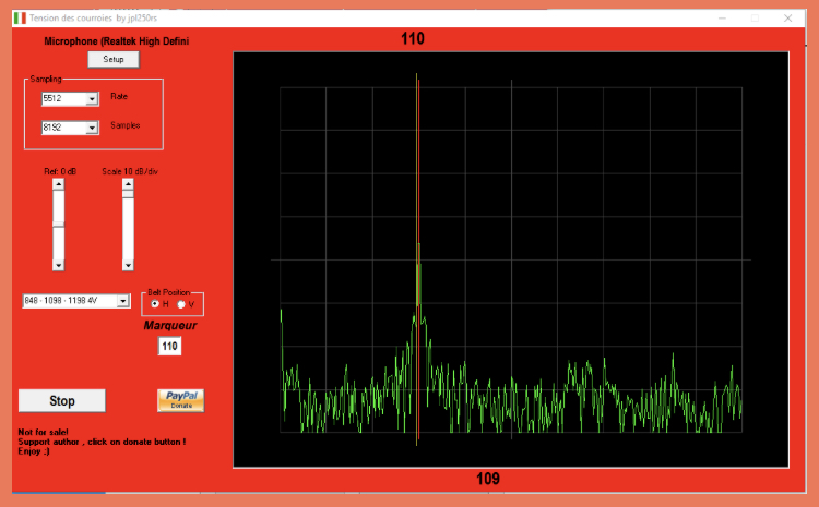

  3. The Gates Carbon Drive app isn't bad but I prefer the belt tension feature of JPDiag using a USB microphone. Seems to provide more consistent results.
