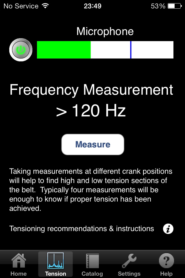

  17. I downloaded the Gates carbon drove app, but don't have a pretty sine wave, I have a horizontal bar instead !
  18. I downloaded the Gates carbon drove app, but don't have a pretty sine wave, I have a horizontal bar instead ! ImageUploadedByTapatalk1426205065.708306.jpg
  19. Same here and as above it doesn't go above 120db, although not a problem in itself. The Android app seems better to me.
  20. What advantage is there in a pretty sine wave and why do you need
    a frequency higher than 120 Hz?
    What I like about this app is how easily it picks up a frequency.
    If gStrings does that just as well and has a prettier display, then use gStrings. Those of us without Android don't have that option.
