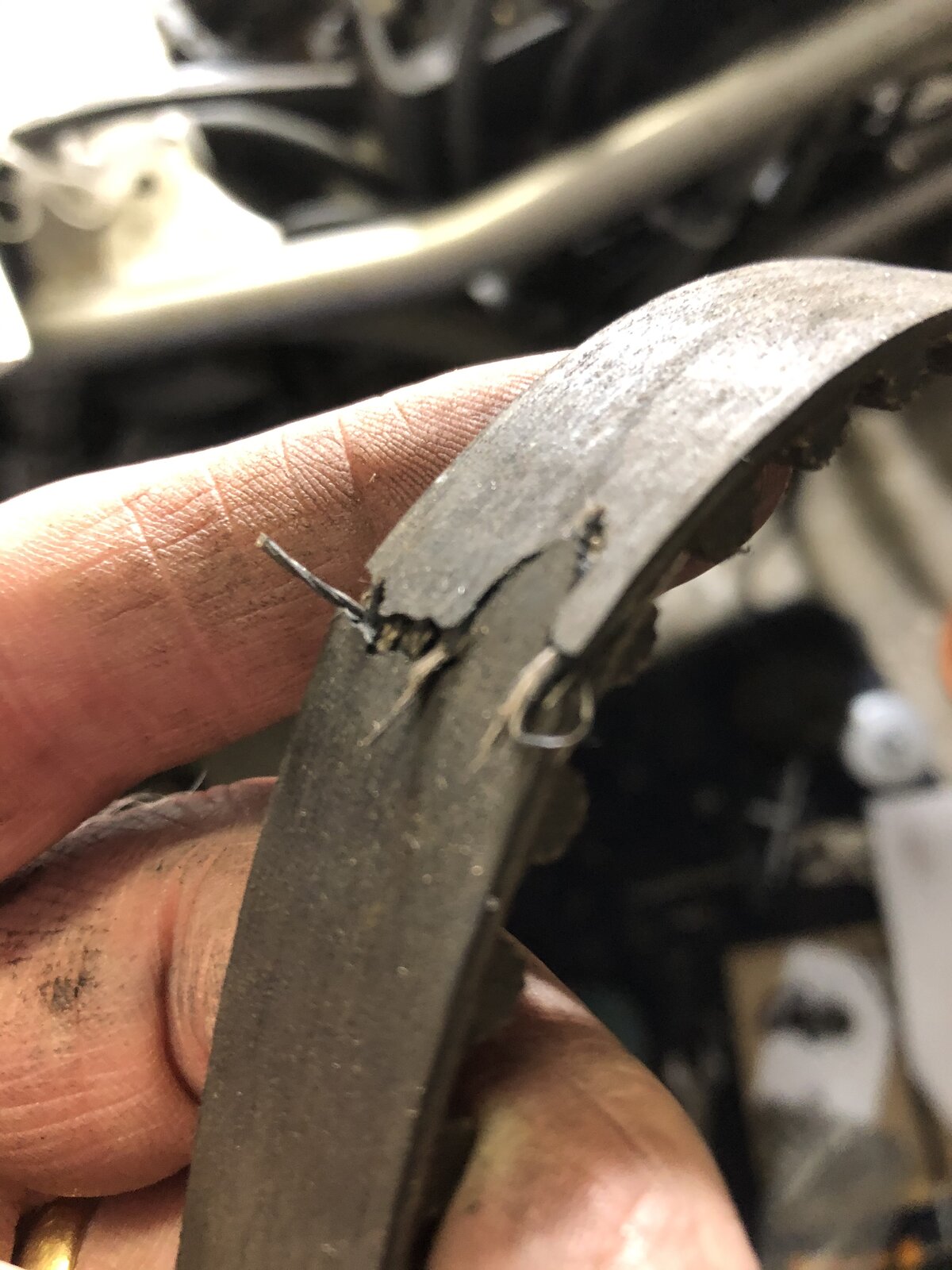

  1. My recent to me 900ss is undergoing a minor overhaul to return it to the road so I have been having a go at checking valve clearances and changing the belts. I have had a few issues and wondered about previous levels of maintenance. The belt on the vertical cylinder was almost broken (see picture) and the first valve I checked (inlet vertical) was at 0.005 on the opener the closer was free and less than 0.003. The difficulty I had was sliding the rocker over when the clip was off needed me to rotate the cam and slightly depress the valve to get it to slide over, also when I loosened the belt tensioner I really struggled to get the belts off, they were original Ducati belts and the horizontal belt was in good condition. Could the cam timing have slipped? Could it have the wrong belts fitted? Would the tight valve have caused the belt damage? I had the bike running before I started stripping it and it ran ok.

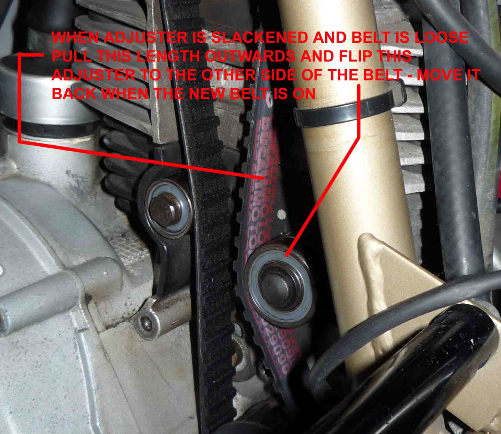

  2. Getting the belts off the easy way without cutting them.......
    See below.....when the adjuster is slackened off, the belt will be loose; so pull the belt outwards and flip the adjuster from the outside of the belt so it is on the inside of the belt.

  6. That belt is not just nearly broken, it’s shiny instead of matt and all the lettering has worn off.
    Has the adjuster or idler pulley seized perhaps ??
  7. Certainly investigate the tensioner bearings but maybe the belt was too tight?
