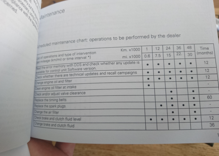

  15. My Hyperstrada 821 is 5 years too. :)
    My Panigale is.......never. :) :)
  16. Thanks guys. That makes me look a tit then. I was confident it was 2 years.
    Oh well, no discount for that then.
