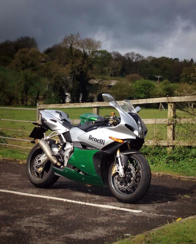

    @domRusty cracking looking bike especially in that colour scheme:upyeah:

  15. Yours looks great with that zorst. Stock zorst on that model is absolutely horrific!
  16. Considered a 999s? ;)
  17. Ta :upyeah: Yes - the stock exhaust is a big long straight thing, typical of the time but really spoils the rear end. Mine's a Micron 'hydroformed' can, originally for an R6.
