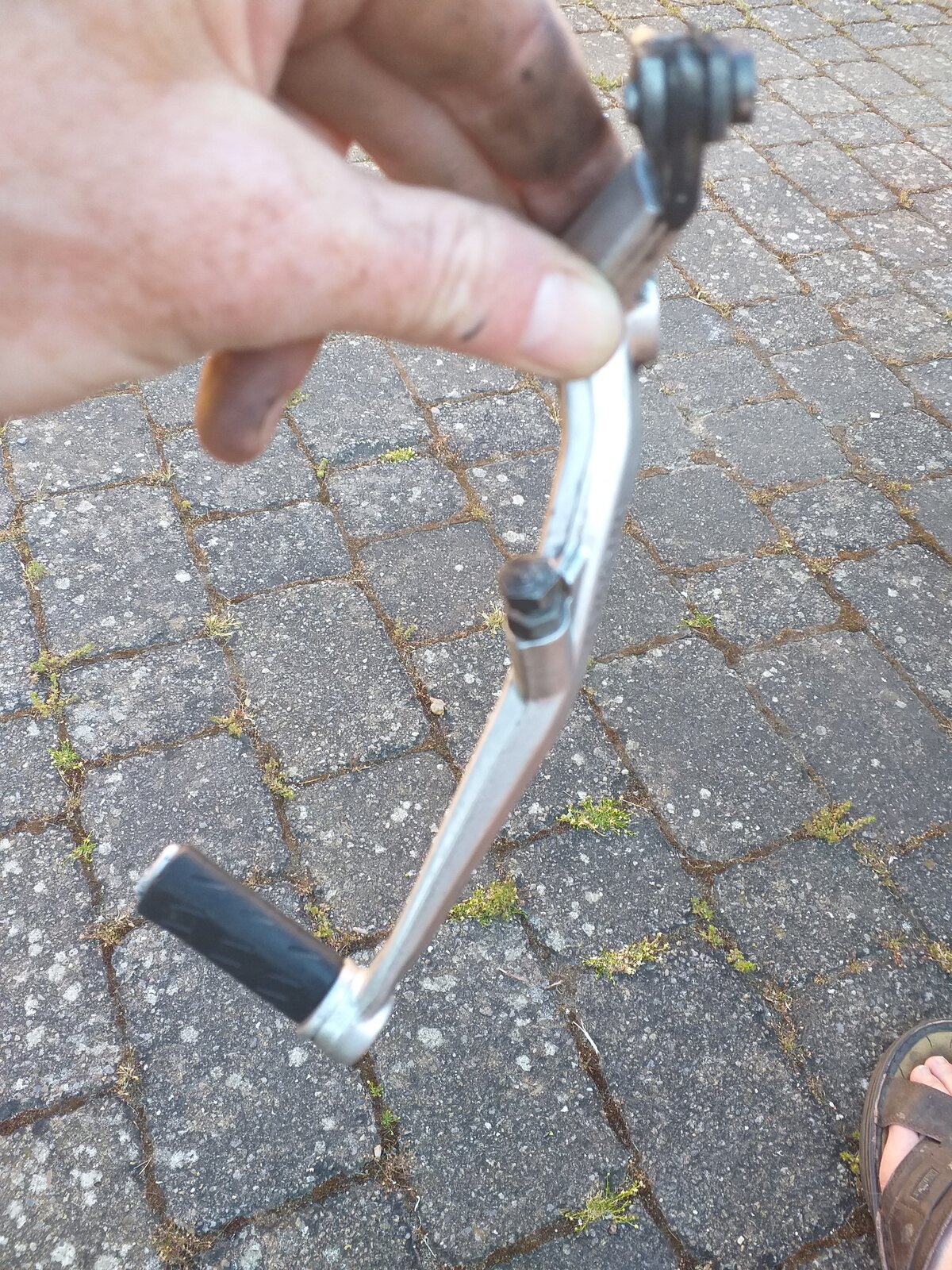

  1. Hi all
    Bit of metal ground interface issue.
    Popped it off to straighten....thing is what is designed bend and what have I done?
    Seems to have three bends in it
    Rough idea of unbent one would help. Even a pic on the bike
    Ta

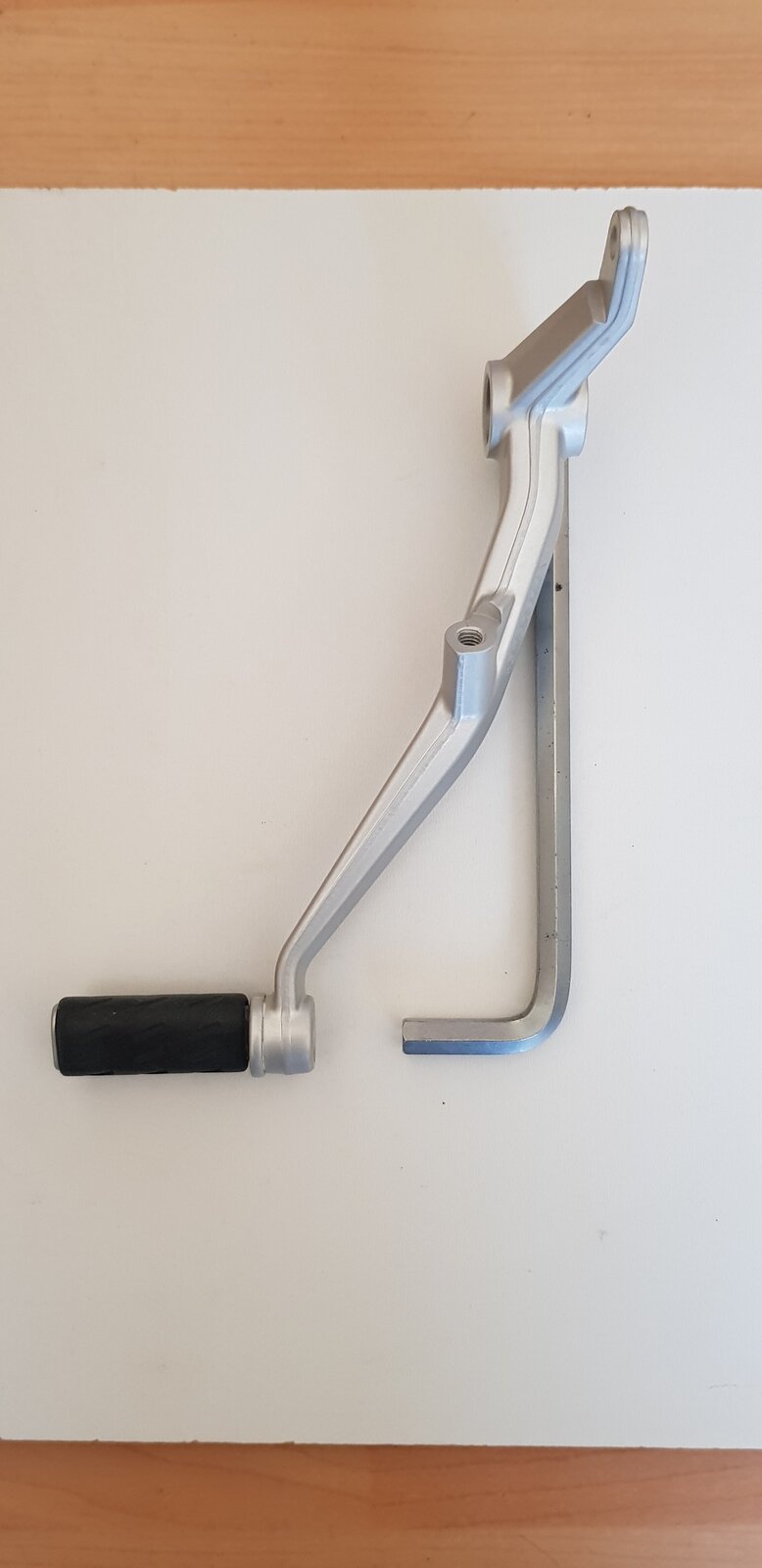

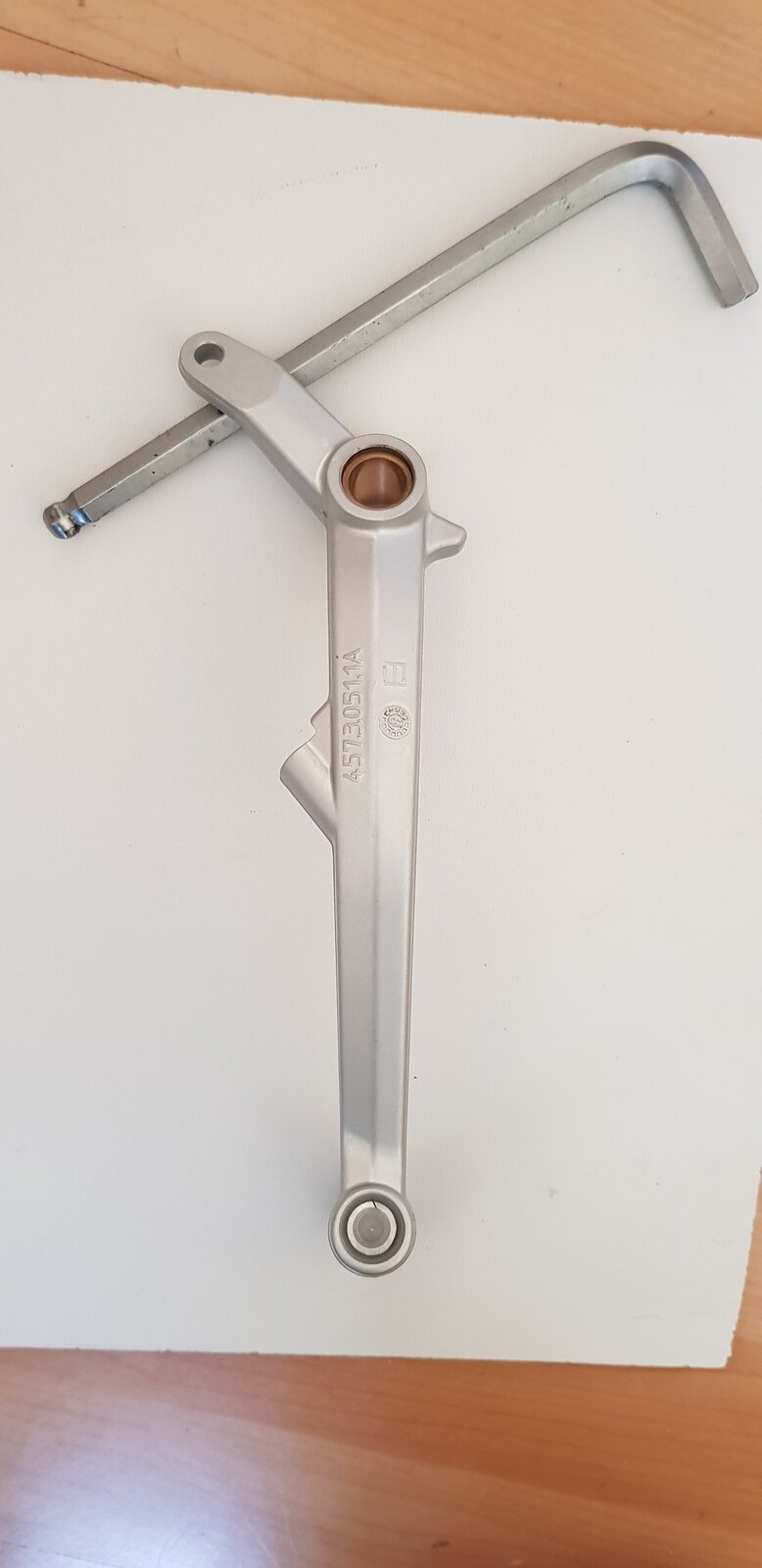

  2. Just put the car away so can’t get at the new brake lever I’m going to fit to her Diavel tomorrow. I’ll post a picture for you in the morning. Andy
  3. As a rule, the foot joggler should always be parallel to the pivot shaft.

  4. Thanks guys
    brilliant - 90% certain it's all bent at the end by the the foot joggler. And 100% certain it will snap off when I go to straighten it.
    I chickened out and refitted it for the MOT - and passed. Figured no lever worse than a bent one....
    Will give it a warm up and try to gently persuade it back in line. or buy rear sets.
