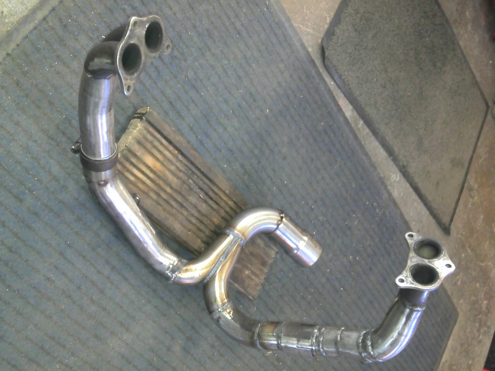

  5. To date about 50% of the 2 in to 1 conversions we've done are for S2R or S4R converted rear ends. All have been based on standard header sections (to save costs)
    The picture is a part built item for an ST4 engine which needed more adjusting than most for the rear section. If you start with an S2R standard header system it is even easier.
    Most fabricators will build a system based on imperial sizes (metric is more expencive) the closest is 44.5mm (1 3/4 inch) also the wall thichness is usually 1.5mm so the internal diameter is 41.5mm in round numbers. You can go thinner guage but avoid riding over a kerb or sleeping policeman.
    41.5mm internal diameter is enough for your engine especially if you want to maintain low to mid range.
    Hope this helps a little.
