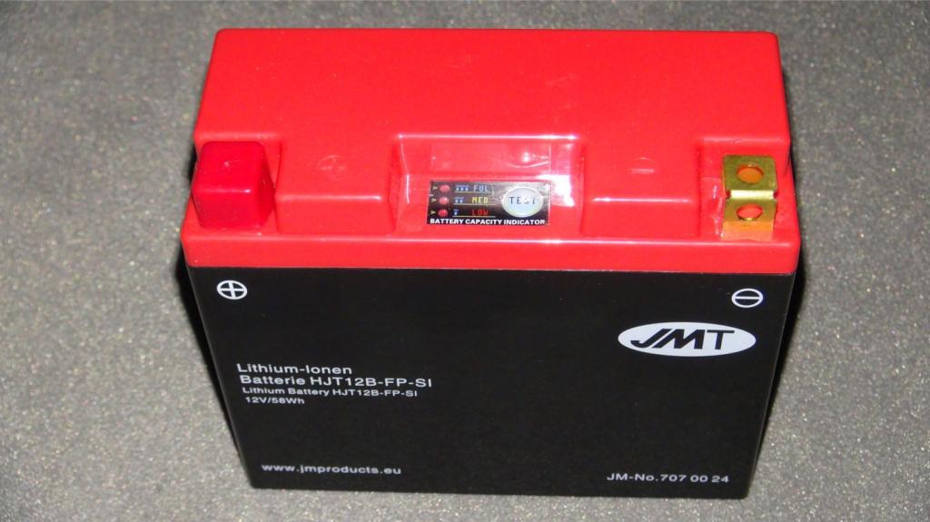

  2. The standard Yuasa YT12B-BS never ceases to amaze me that it manages to turn this twin lump. A fairly common upgrade on the Aprilia's was to swap out the 12 for a 14. The dimensions other then height are the same and you get more cranking amps. However, I've not seen anyone post with issues that the the 12 is not up to the task. So sticking with the standard would be my choice.
    Don't be tempted with the lithium models as they are only really suitable for warmer climates.
    #5 Piero, Feb 10, 2014
