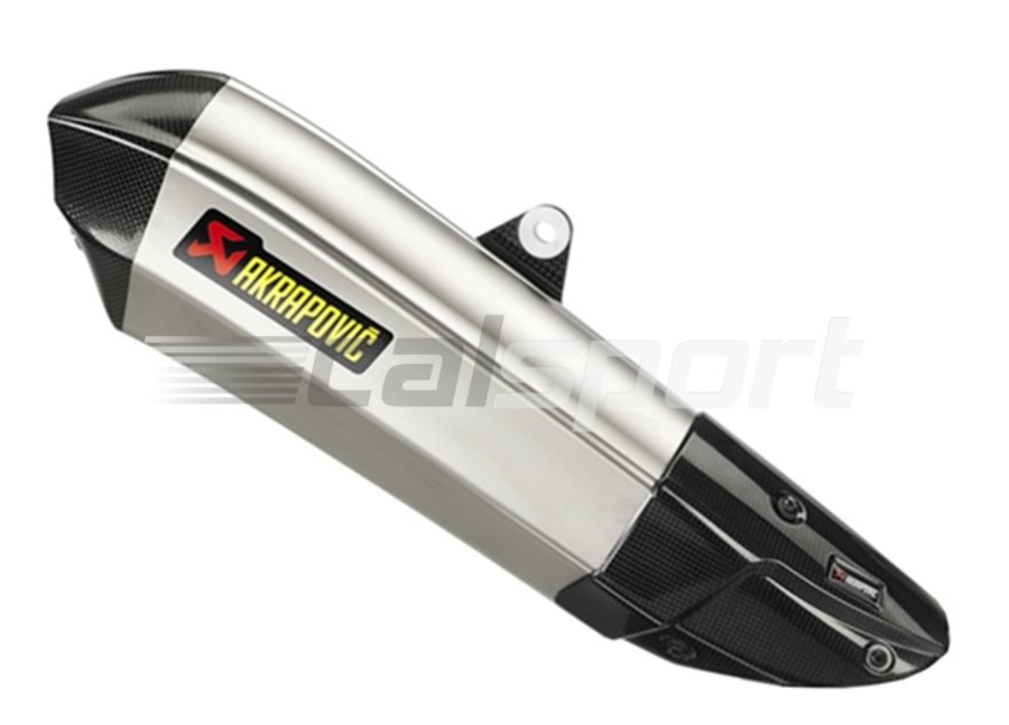

Hi Guys What's the best end can to fit to a 2016 Pikes Peak multi that has a de-cat pipe fitted? Standard Termi is making it run a little rough and backfires a hell of a lot. Trying to avoid a ECU reflash if possible. Looking at a Akrapovic S S-d12so7-hhx2t with DB-Killer but quite expensive. Any advice would be great. Steve
if its back firing, are you sure there isnt an air leak in it somewhere ? I would check the header nuts are tight, and any of the fixing brackets arent cracked. A change of silencer is unlikely to affect the running of the bike IMO, because they all pretty much have the same diameter internal pipe, and are all straight through, so little back pressure difference. I have a QD silencer and decat pipe on my 2012 bike. Quality is great and had it over 6 years now, but the alloy end caps are due another powder coating. Also, the central mounting point on the decat pipe broke off once, and then pulled a weld creating a hole which made the bike pop back on overrun. As a consequence I simply don't use that bracket now. I think that Akra looks great. The cost of silencers has gone crazy for the amount of work there is in them
