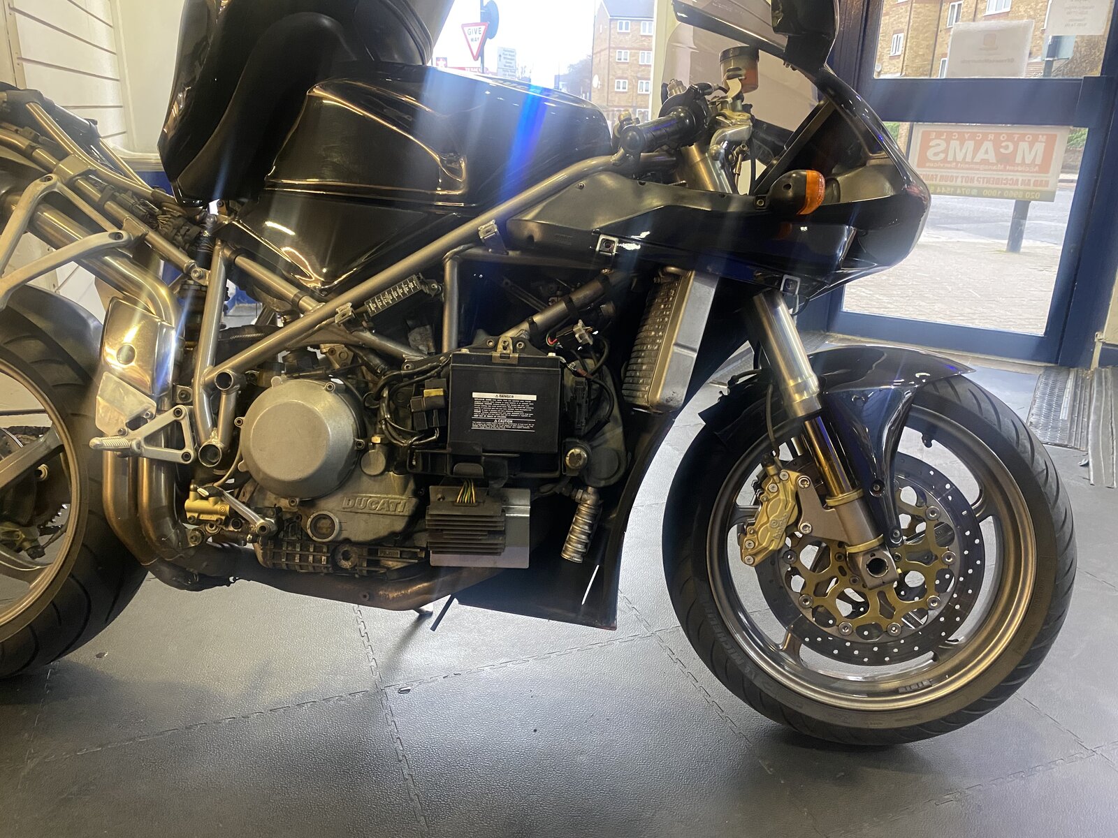

  1. There’s a number of screws and fasteners on my bike which are tired, but perhaps none more offensively than the screws holding on the callipers.
    Where does one go to replace such things?
    Thank you!

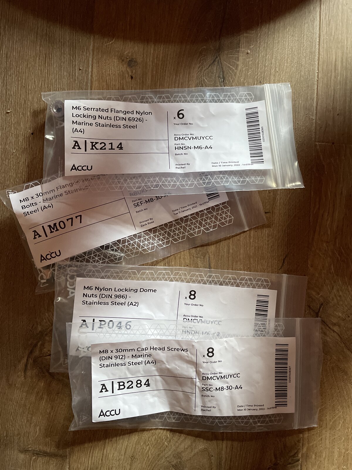

  10. i did the same recently
    i used these guys for anything critical like caliper bolts
    https://raceboltuk.com/motorcycle-k...ss-steel-brembo-caliper-pinch-bolt-kit-p27067
    and accu.co.uk for all the non critical socket heads.
    they will have a stainless options in a2, a4 marine stainless or titanium. various washer options, ie square chamfered thinner, or integrated. i got a digital micrometer from toolstation and took out the guesswork. best £19 i have ever spent.
    i ordered up a bunch m6 m8 socket head in varying lengths.
    Russ

  12. image.jpg oh btw they arrive like this from accu so easy to find and select.
    Russ
