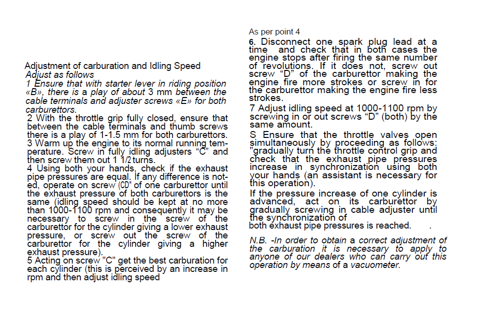

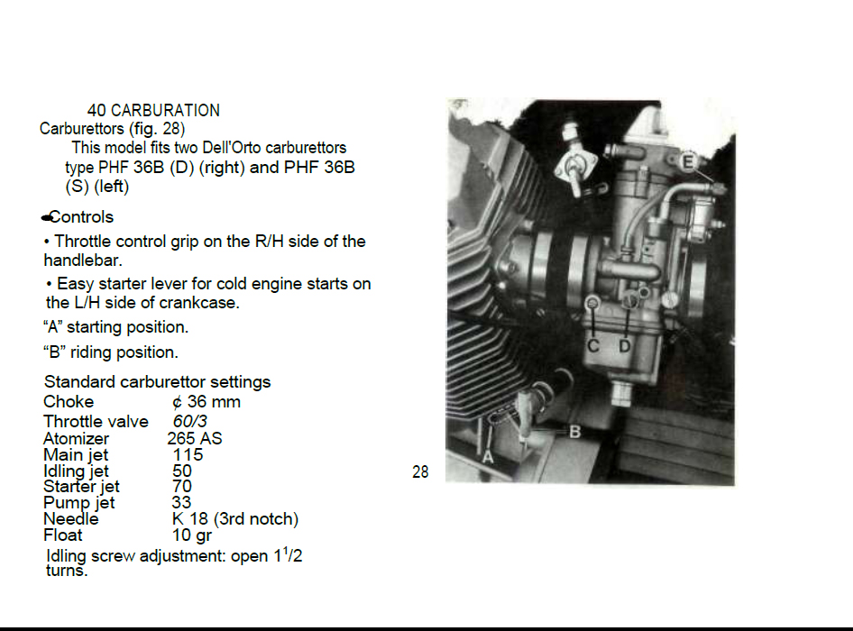

  18. I assume you have been to this site.......??
    Bevel Heaven - Vintage Ducati Bevel Drive Motorcycle Extravaganza.
    These extracts from a Guzzi owners handbook might also help......
    On my Guzzi I used the same method, but with a Gunsons Sparkplug thingy as well........I think that's why I could get it idle at such low revs........I would use the same on my SS if someone hadn't nicked the Gunsons sparky thing.
