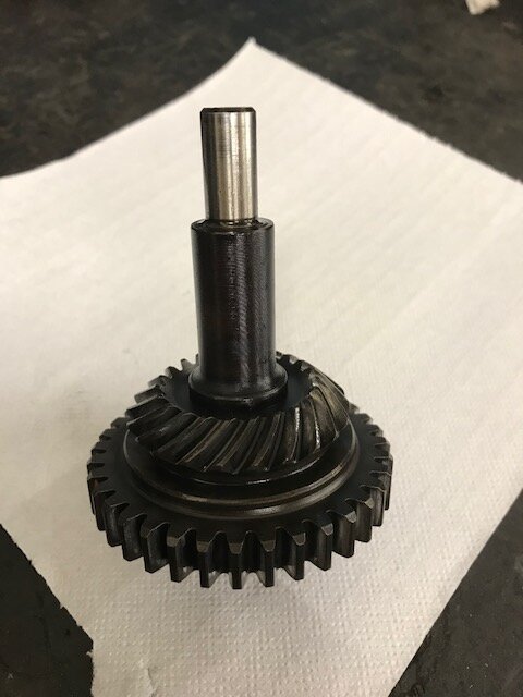

Hi guys - I am aligning the mesh of the lower bevel gears on a Darmah. What puzzles me is that the parts book does not list shims for the shafts that run in the bronze bushes in the crankcase, above the R/H main bearing. I know that rocker shims will work, and I can adjust with these to get the correct mesh. I assume those of you who are familiar with these engines have noticed shims behind the gear shafts, or have I missed something? Here's a pic of the shaft in question: Dave

when you say "shaft in question" I take it that you mean the one in the video and not the one you first mentioned. I can see that designing the set-up with shims only on the former makes perfect sense (and I think this is what you meant) because with the latter (your) shaft, you have to deal with the age-old problem of shimming for correct bearing clearance/end play for the shaft itself when assembled with the carrier making it impossible to additionally shim for bevel clearance at the same time unless large diameter shims also introduced either side of the (separate) bevel gear/shaft.
I can't recall ever finding those shims inside a square case motor and... I've built dozens of them without any bottom bevel or bearing problems to date, over the last 42+ years. Steve R
Part 24, "washer" comes in five sizes. The drawing is not very good as it does not indicate that these "washers" can go on the spindle either side of the bevel gear. https://www.ducaticlassics.com/parts/900-sd-and-ssd-darmah/engine-gearbox/bevel-gears-valve-timing

Just checked and unfortunately it looks like the Bevel Heaven forum is 'Temporarily Unavailable' hence the file not found. And doubly unfortunately I can't for the life of me remember exactly what the informative answers might be either... ho hum My motor was rebuilt by Tony Brancato and that's exactly what I found on mine i.e. no shims on the internal spindle, and how I reassembled it and I've had no issues. I'm thinking it might only require shimming on one side because of the action & forces produced by the meshed bevels.
