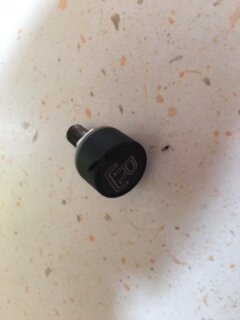

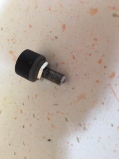

  1. I just had a set set of PR5s fitted and used the Michelin offer of a free set of TPMs.
    On fitting them I noticed that the large plastic head mounted on the 90deg valve stem would foul on the brake caliper on the front wheel. Glad I noticed that before wheeling the bike!
    The rear valve stem is vertical and with the TPM installed it looked OK to miss the caliper. Oh foolish me! I didn't actually check the clearance.........................
    This morning I was off on a ride out and pushed the bike out of my garage. A loud hissing sound told me I'd f####d up and sure enough the rear valve stem was snapped clean off, the culprit being the plastic TPM sensor. So be aware, the TPMs don't fit, take the £30 cash back instead.
    I need to get it fixed before next week as I'm off on the bike to Scotland on Tuesday. In common with many on here the rear wheel nut refused to budge with a long breaker bar. So I am now waiting on a Clarke CEW1000 impact wrench (as recommended by this forum, £65 Ebay) to arrive Wednesday/Thursday so I can get the wheel to the tyre shop.
    It's turned out to be an expensive exercise.
