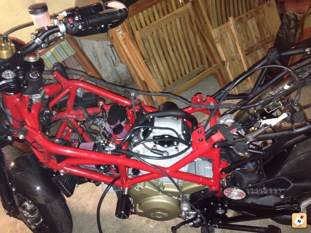

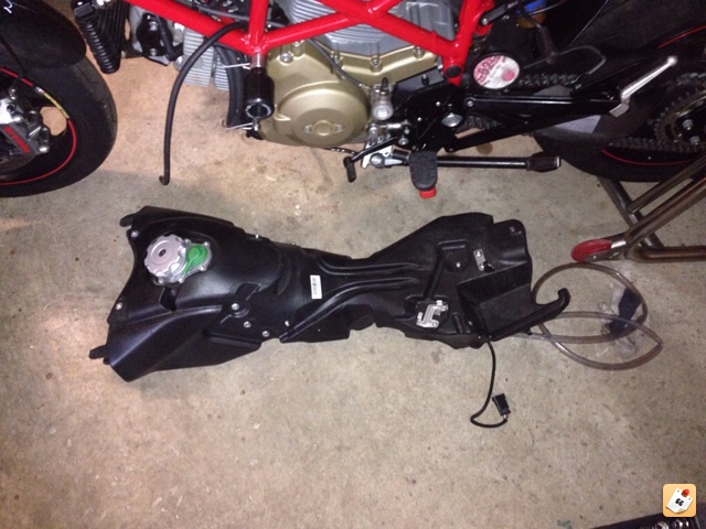

    So this is the old tank successfully removed;
    And this is the air box out and replacement filters on:

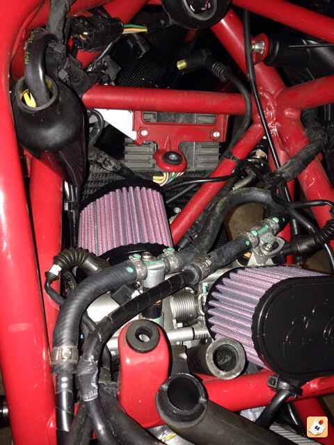

    And as you can see the filters on the breathers:

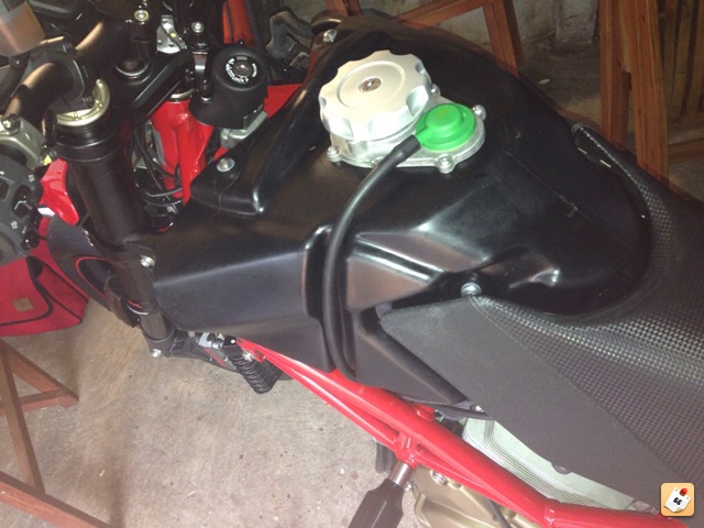

  2. Job done:
    Now where could I go with 200 miles in the tank:)
    Side covers to go on but not till I've fitted my temi.....
  3. Nice. Will you have to get it tuned to go with the new filters and termi
  4. According to the people who make the tank it works fine with the full termi although I'm presently minded to get some dyno work done. I've heard there's a place in Bristol that's not bad so will get it done either now or in the spring as I have a feeling the salt trucks will be out in the next day it two and my hyper is allergic to salt!
  5. very good brasso , so go on then how much for the tank and filters and so on ??
  6. All in it was £750 including delivery from over the pond and tax. I could just about justify the spend as I fitted it myself - probably mad but I've spent more for less in the past!
