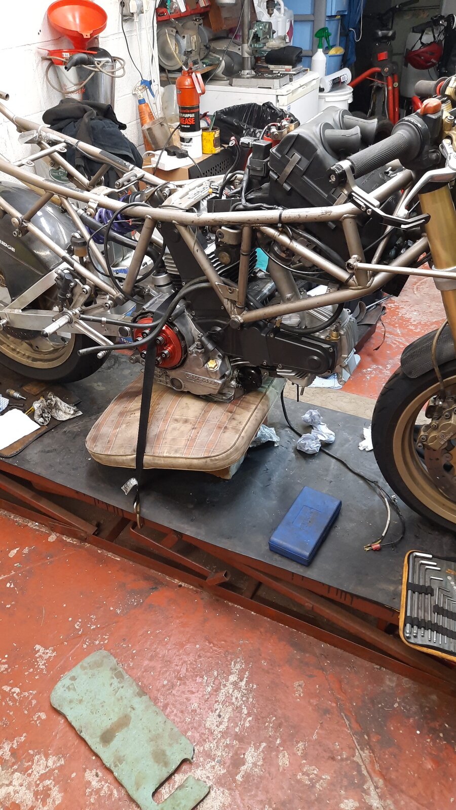

  14. There should be an old vid when I fitted the mod to the clutch attached
  15. just a photo - no link to video
  16. Bugger !!
    I'm in the garage today & will make another vid & stick it on YouTube later on, after renewing the brake fluid & oil, ready for Oulton pk on Thursday.
