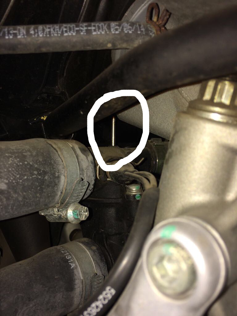

    Today I took my bike to the official Ducati service center and on the way I had the same issue. First time I managed to wait for a bit and restart the bike, but the second time the bike just wouldn't start and had to be towed to the service center(luckily I wasn't far off). The mech who did the initial inspection claims that the cooling system has somehow failed and that the thermostat has broken out of the casing? He showed me a longish silver rod sticking somewhere under the tank.

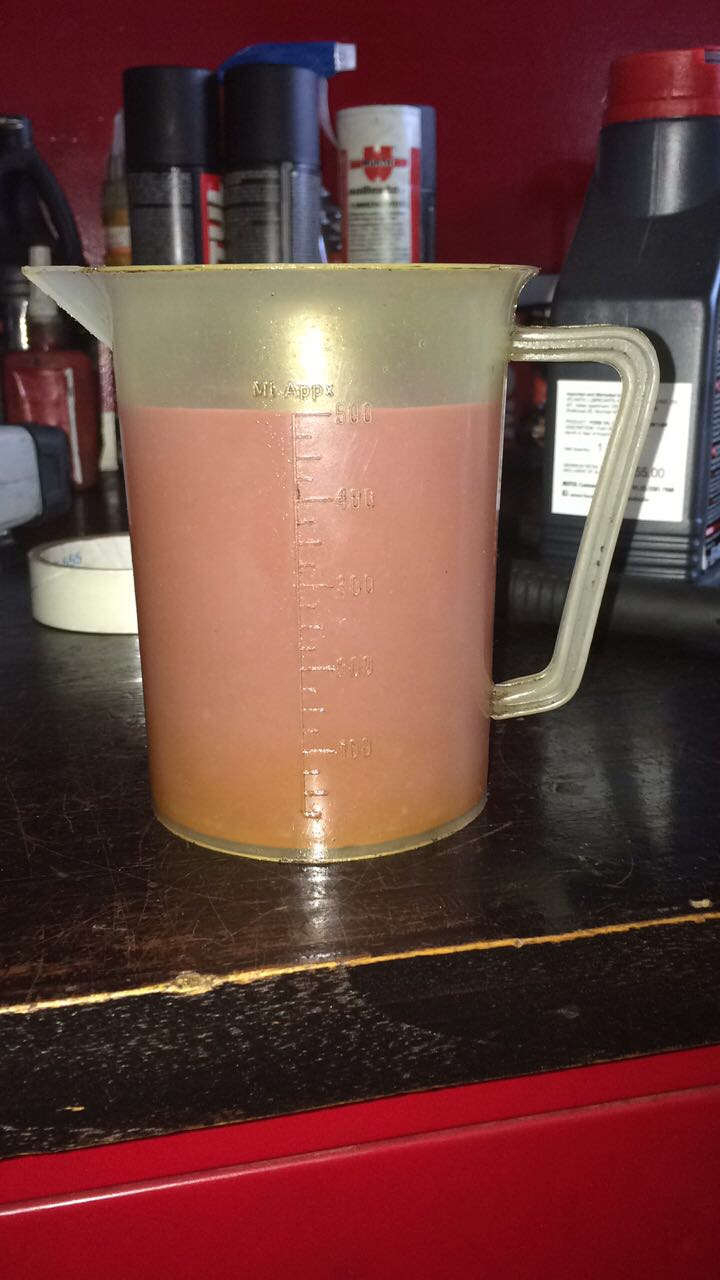

  10. The contents of that jug reminds me of....

  14. 007756EB-5F0F-4149-8D1E-0C946EB4CFB4.jpeg This is the damage. It seems the thermostat has busted out of It’s case... Not in stock and has been ordered.
  15. Looks relatively cheap/easy fix...:upyeah:
  16. depending on who is fixing it :eyes:
  17. No warranty...
  18. Hoping for this... if the damage is limited to this, then the cost shouldn’t be exorbitant.
