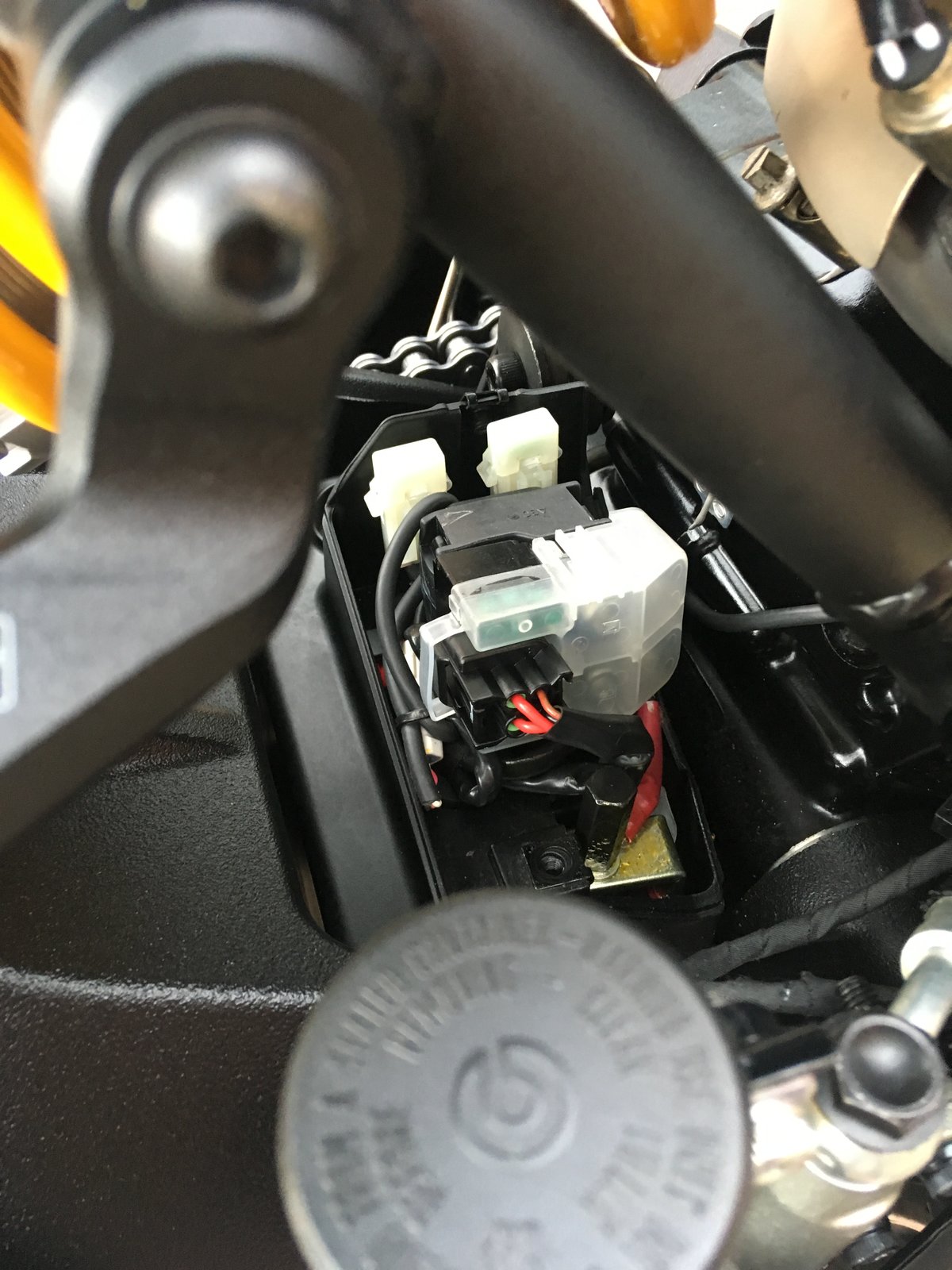

  7. You mean these in here?
    Thanks
  8. Pulled the starter motor boot off and it was full of white grease and was dry so don’t think that was the problem.
    Will have to just give it the NHS bed bath next time

  15. The dash went blank (which it always does while turning over) but abs light stayed on
    Could definitely hear (and feel) the bike crank over and a rely clicking somewhere near the front of the bike
    I checked the battery box and solinoid etc and all were dry and with clean grease From the factory. Pulled the boot off the started motor and again this was bone dry and had plenty of grease on it and connecting was good.
    I think it was ignition that was the problem it was definitely turning over.
    Spoke to the dealer I got it from and they said it could be anything and not uncommon.
    Spoke to my local dealer who I trust a hell of a lot more and he said the thing would need to be under water not to start and he’s never heard of this before and most likely is a duff battery even though it read 13.1v
