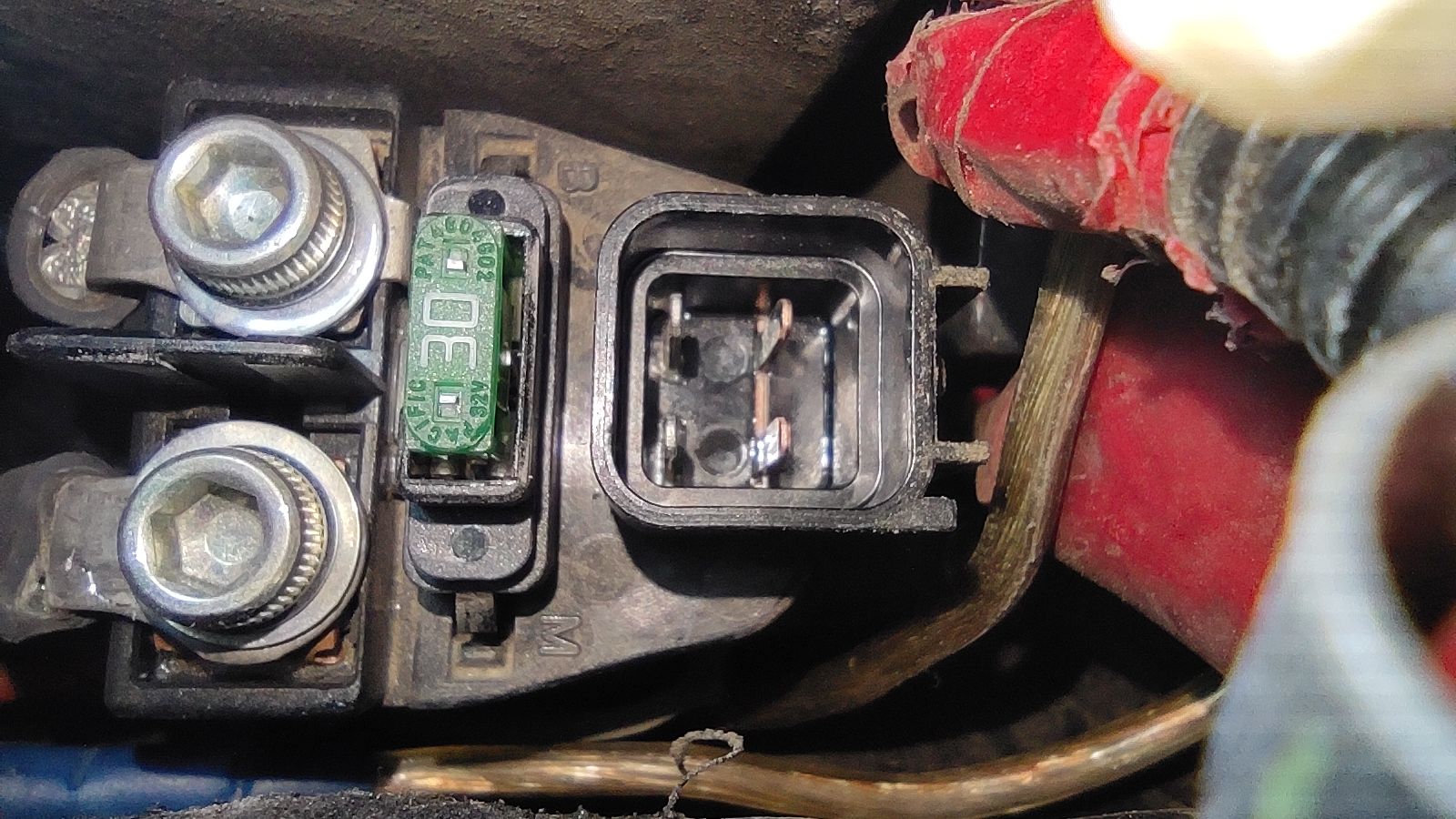

So, attempt #1: I have accessed the solenoid to take a look. As you can see in the picture the contacts are in mint condition which I find very encouraging for a 12yr old bike. So it seems that it is in good working order (although at this moment nothing tells me that its relay is working). As @Keith_P suggested I shorted the terminals on the left and the starter motor is working as it cranked the engine. I didn't want to risk my pliers or a fire so I didn't leave them shorted, waiting for the motor to fire up but the starter motor is working and the battery seems to be up to the job (although it was a bit lazy which I find normal to be honest for a bike that was standing still for 8+ months). I also tried to jump start using my car's battery, to elliminate a defective battery which again did nothing using the switch. So: 1. Battery seems fine (at least it cranks the motor) 2. Starter motor is fine 3. Solenoid's condition seems immaculate I didn't have the time or the daylight to go on and fiddle with the switchgear on the handlebar but so far it seems it's either that switch or the relay.

There’s a wiring diagram here albeit in B&W but the wire colours are written on them and you’ll need a computer screen to view it on (or print it off). Did you check the 30A fuse in the photo is good? There’s a relay switch (under the 4 prongs exposed in the above photo) it may help to give it a gentle tap at the same time as pressing the starter button - it’s a 2 person job really as you’ll need to hold a long screwdriver against the body of it and tap the end of that - it could be the relay internals have seized in the open circuit position during the layup.
Yes, all fuses have been checked. A seized relay would be the last thing to check for (but yes, it's a possibility). I would try tapping the relay while pressing the button but as you say it's a two person job (only because you really need two hands to hold the relay and tap it with something heavy at the same time). The wiring diagram shows only the connections as a schematic, not the actual pins, if that's what you suggest. This is going to be step 2 but I will do that during the weekend. Definitely need the calm, time and daylight of a Saturday morning to do that.
