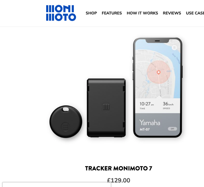

  5. You should try a MoniMoto tracker, no installation or wiring needed. I have used one for over 4 years and it's works brilliantly. Only €39.00 subscription a year.
    https://monimoto.com/uk/shop/

    As someone said above - have also used a monimoto on my R6, great bit of kit and recomend them as a quick option. However think for insurance purposes it has to be a hard wired tracker to count from what I understand but could be wrong, been a while since worked in insurance now
