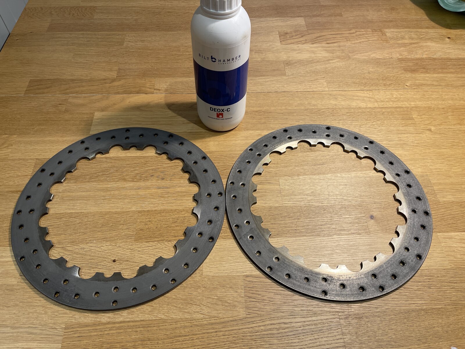

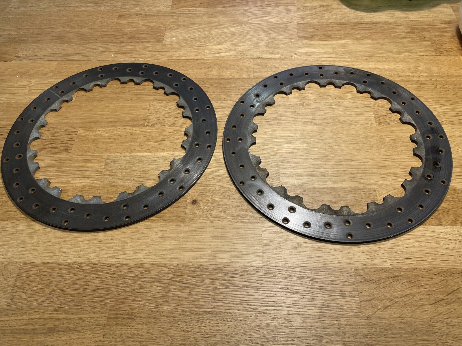

Always used phosphoric based rust converters in the past but today tried some DEOX-C (water based) rust remover today to remove rust from the holes and inner circle of some cast iron discs. It worked a treat after just 3 hours soaking. The friction area should clean up after some use.
