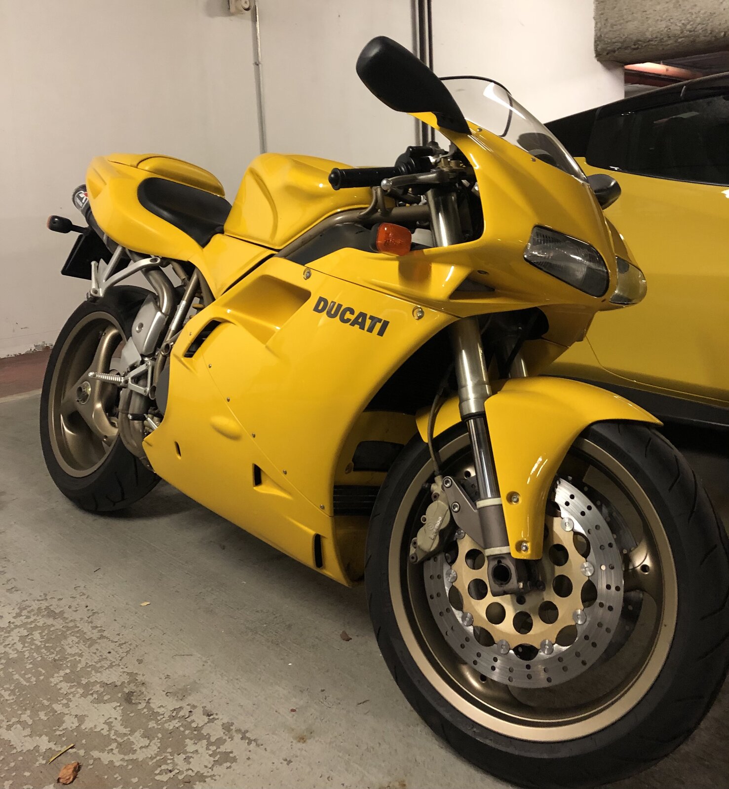

  1. I’ve decided that I’d like to convert my 916 from Biposto to Mono and so have researched all the options
    The simplest way would be to reuse the biposto subframe but the holes where the rear foot pegs attach would remain visible which I’d prefer not to see. So I decided to do it properly and source OEM parts where possible

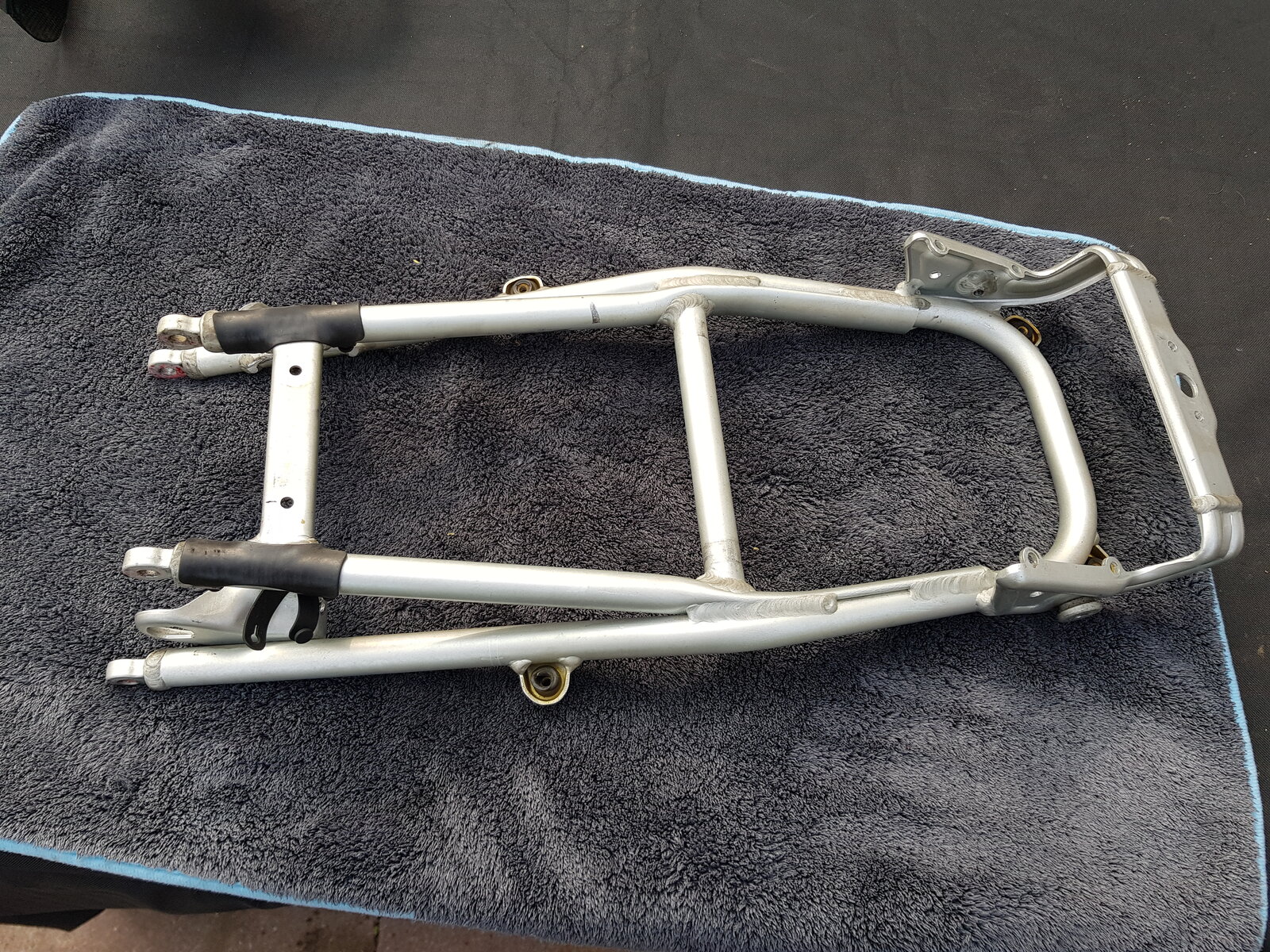

    Next up was the subframe. Turns out there are two versions depending on which ECU you have P8 or 1.6M ECU
    I bought the correct 1.6M frame from @final_edition

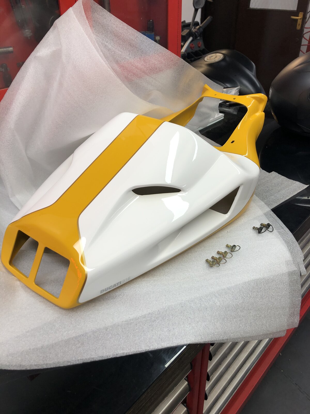

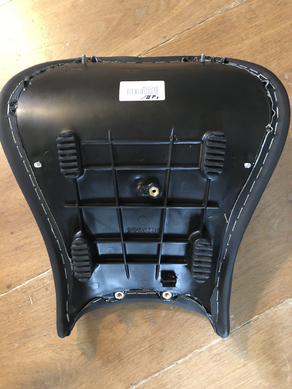

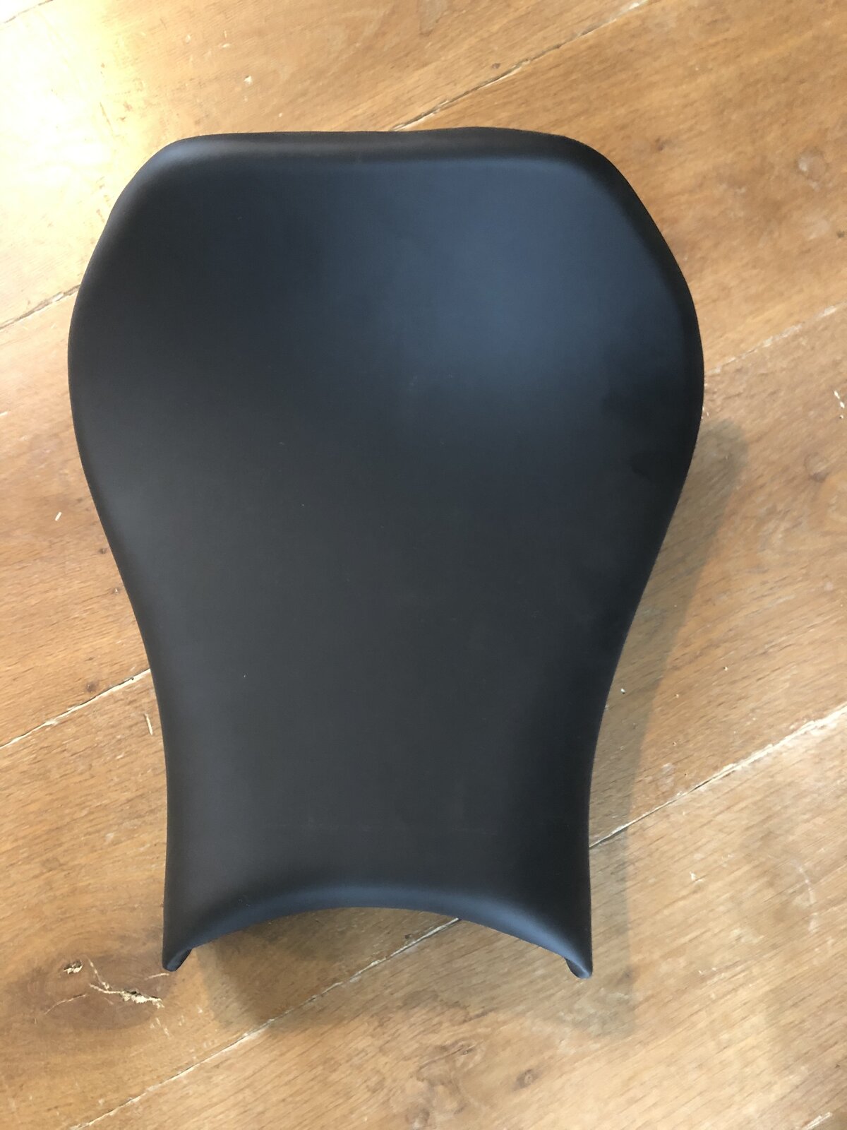

    Next up was the mono seat which differs from the front biposto seat with a higher profile at the back. Found one on EBay
    6F933CB7-48C7-417C-BA13-D33EF422C139.jpeg F0FF3614-9E0A-42E9-9678-0FF720BE96D6.jpeg

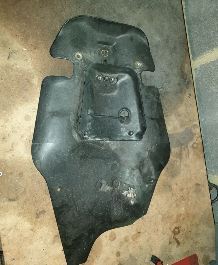

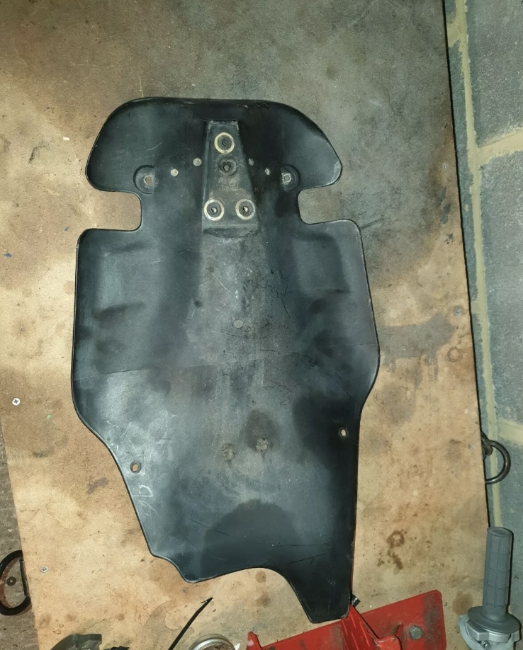

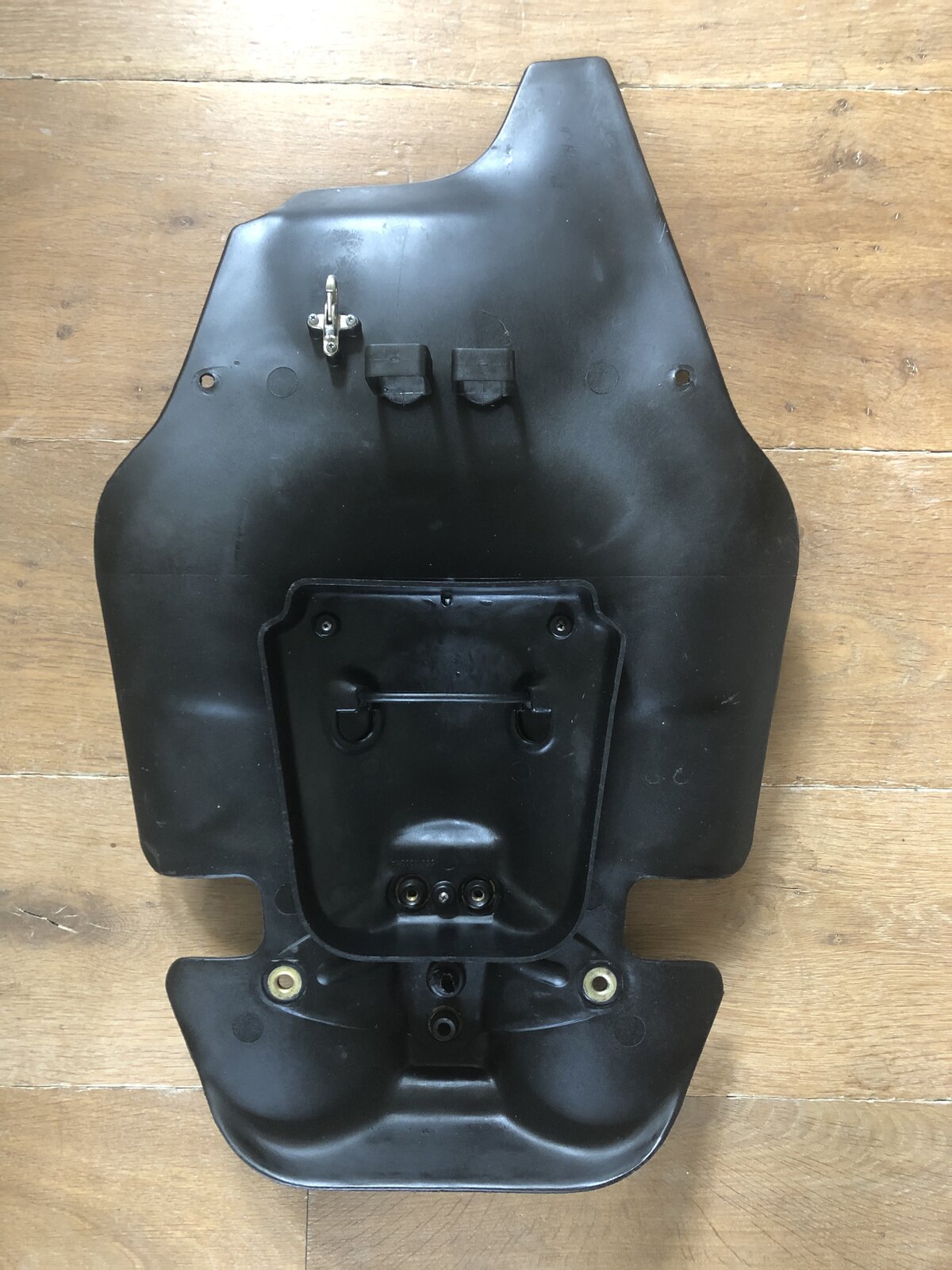

    The only remaining major part I needed was the mono undertray (I’m told you can reuse the biposto one but I didn’t want to make any non reversible alterations to the original seat which I will keep so the bike can be returned to stock in future) Anyone that has looked for mono undertray’s recently will find they are not cheap, typically £190 to £300 whereas you can get a biposto version for £25. Demand and supply in action!
    Anyway I got lucky and I found one on eBay for £50 ....
    87A827C4-4E21-4B99-B0B7-FB722CDBD919.jpeg E8819243-57AA-41FD-87AC-491BA8429A92.jpeg

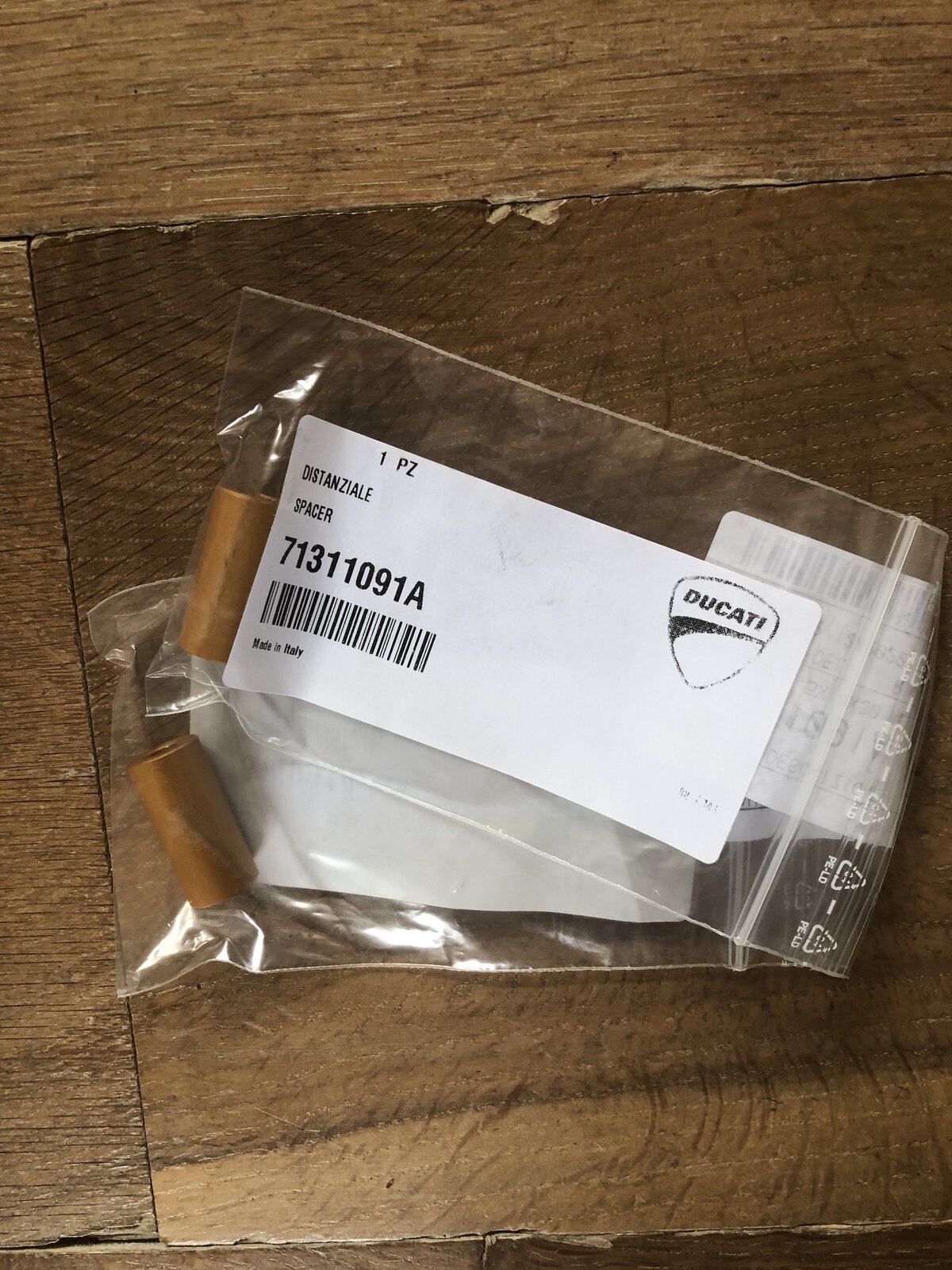

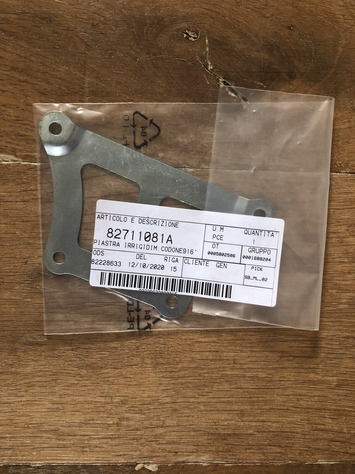

    There are a number of pads, brackets, fitted mesh parts, which Craig at Moto Rapido is sourcing for me.
    In the meantime the seat is being repainted to the correct shade of yellow. Before and after pics to follow once fitted .....

  10. Cleaned up the undertray ...

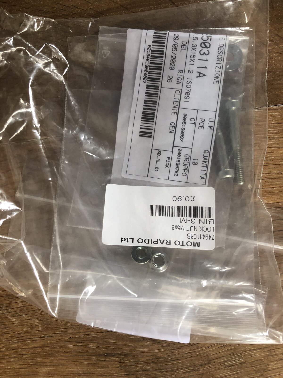

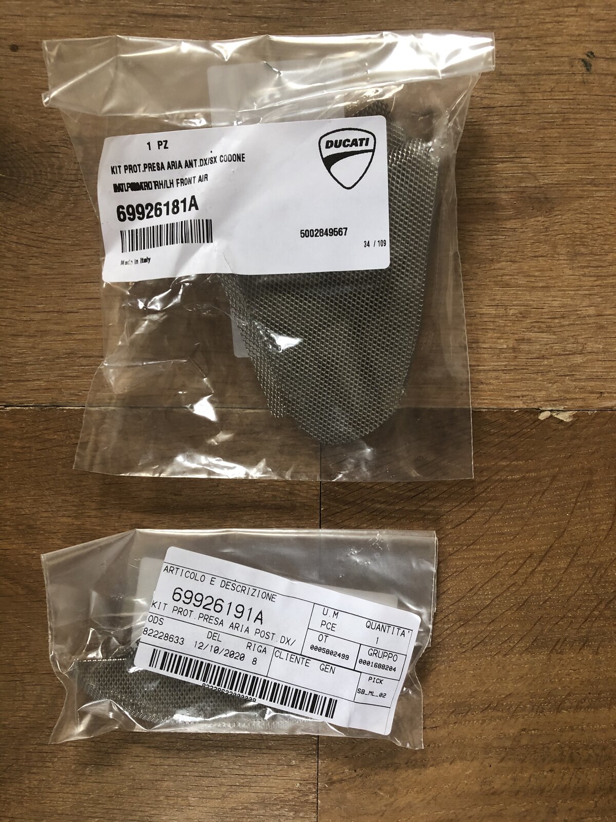

  11. Delivery arrived from Moto Rapido
    BC5C9E45-A40C-4BA1-81F6-1A58114E9FFC.jpeg 50007310-1A9C-4A54-A30D-689CF0CD2BA0.jpeg A46E7287-850A-457F-8A2A-EC90AEC55E57.jpeg 8E40898D-85FC-4EC6-B1C8-9D06BCC48DE6.jpeg

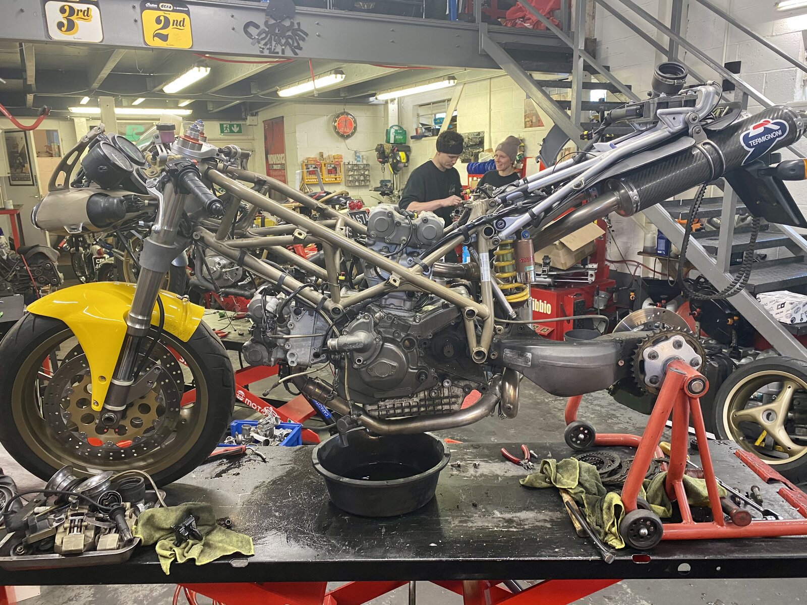

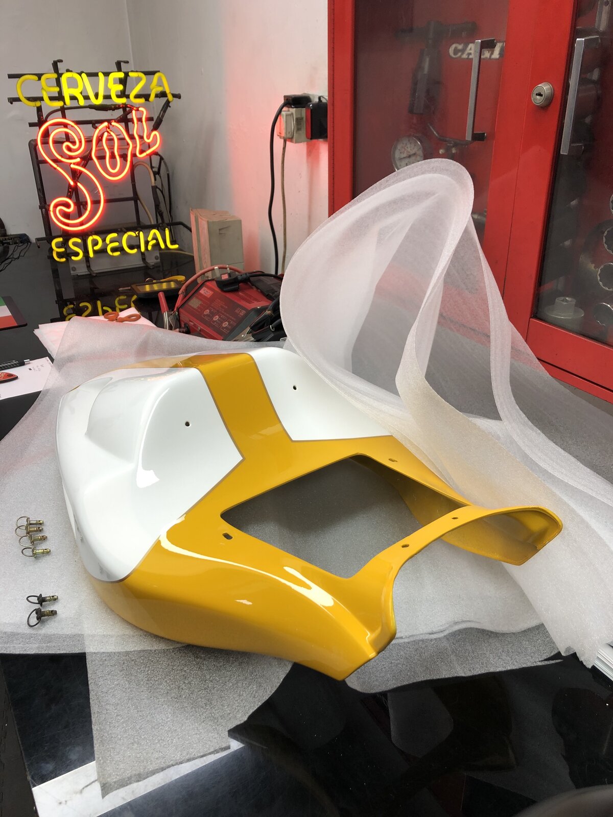

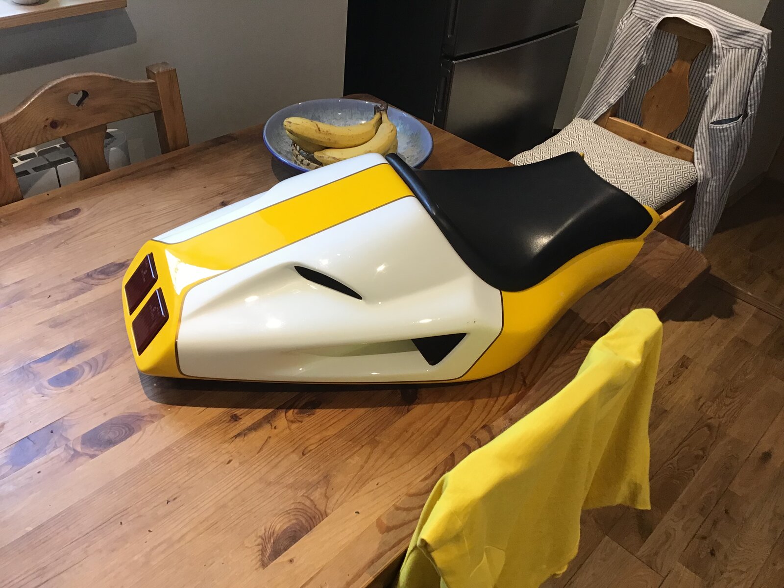

  14. So the seat came back from the painters
    AA9404C6-BEA6-43EC-ABCF-AED583FDE2B1.jpeg 54F160FF-6BE3-4021-9DB8-2B2D40188D4B.jpeg
    And as Cookster predicted the wiring loom was too short to fit the ECU so the bike was sent to Ray Petty at Meccanica to have the loom extended.
    Once completed I arranged for a courier company to collect and deliver the bike.
    Unfortunately they dropped the bike whilst loading it into their van :(
    So it’s being repaired/ repainted and whilst at Mechanica Ray is tidying it up :)

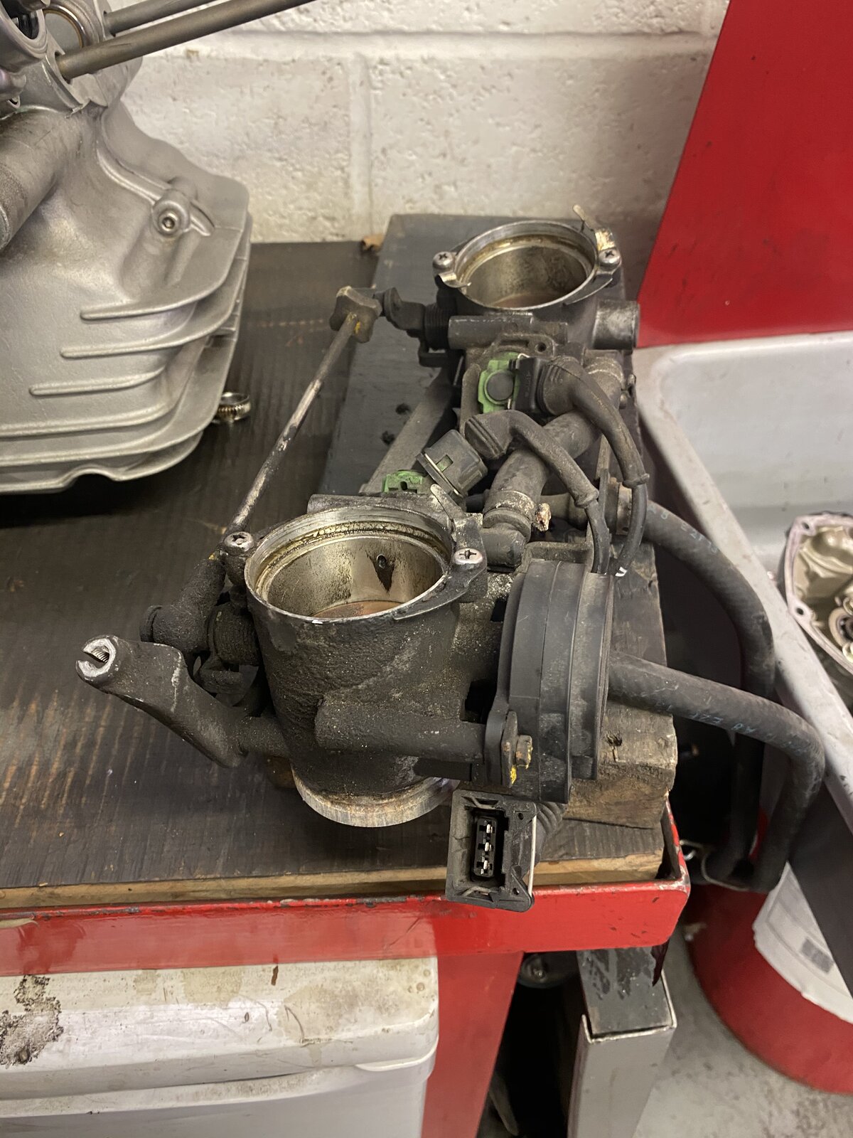

    D163EED7-5ABC-40AB-8EC0-A9D400DA47EF.jpeg 936BDAF7-0683-4AB0-8279-EA0369470145.jpeg

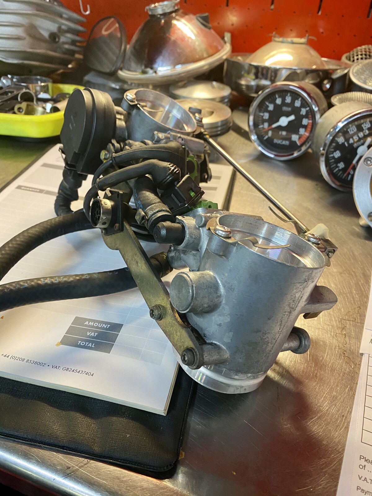

    Throttle bodies (before and after)
    #16 Shorty4045, Nov 20, 2020

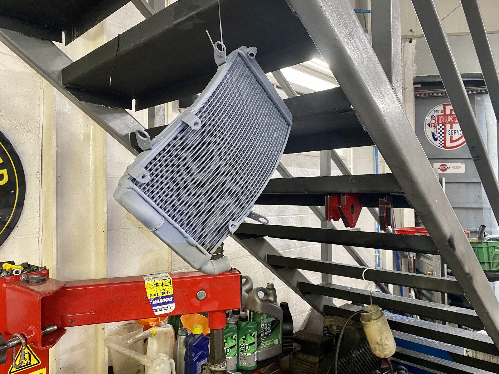

  15. E38F45DA-E0D8-4003-BA20-0F26BAED23E5.jpeg D3067BD8-21DA-4117-ACCF-B0D90C5B9033.jpeg BC261A28-A950-441C-9C2B-6886577D3336.jpeg
    Radiator was replaced some time ago but with a black one for some reason. Ray has had it painted silver as it should be

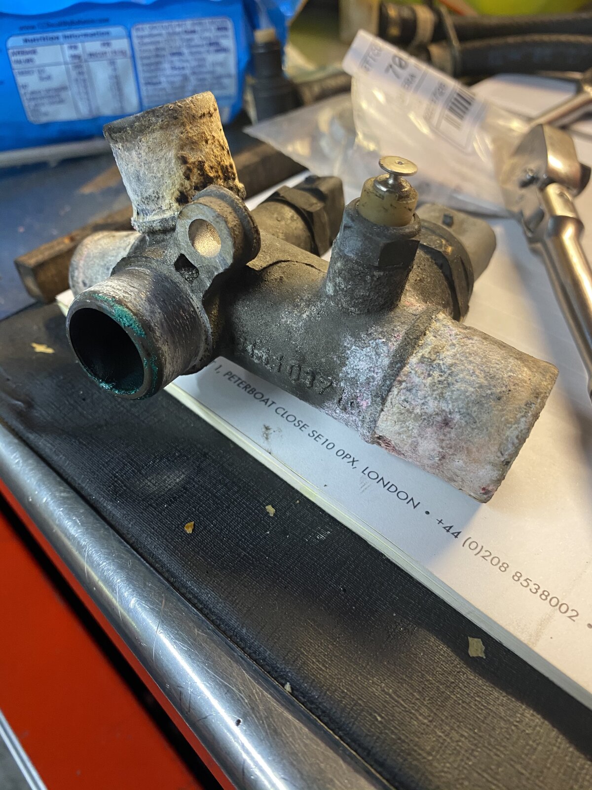

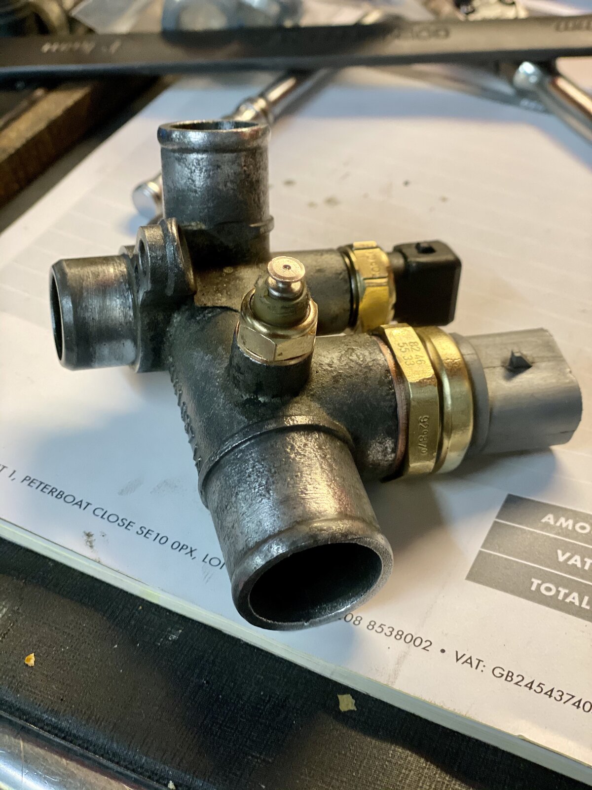

  16. E25EE67A-CBE5-4BB2-BE2C-2E2670CE689D.jpeg 19B3680D-959E-49ED-AE4D-A4D3E9109456.jpeg
    Main coolant junction, before and after... the corrosion was causing a slight coolant leak..

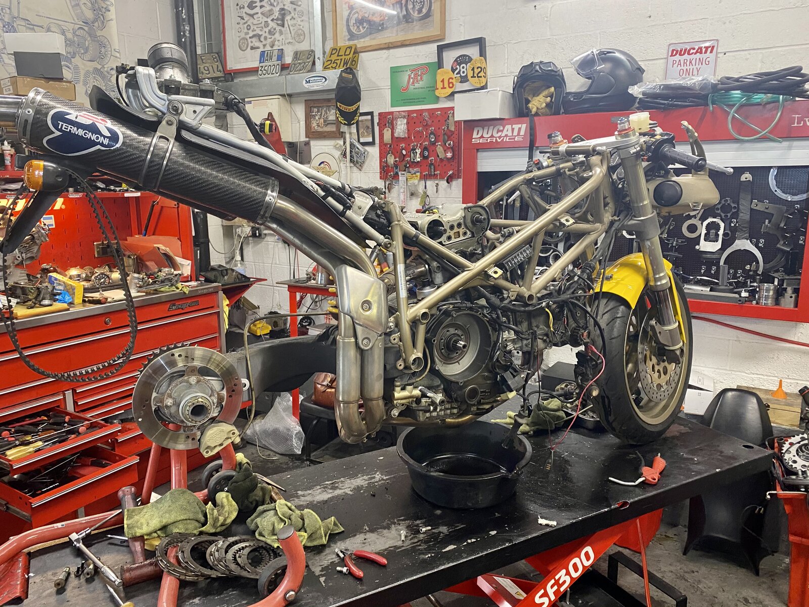

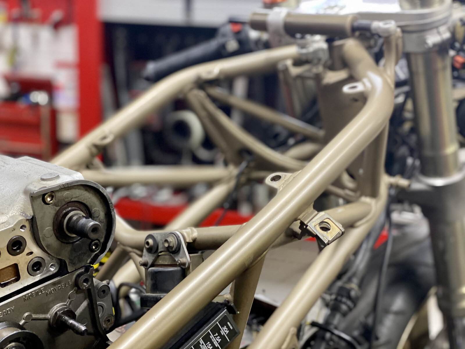

    Chassis deep clean :)
