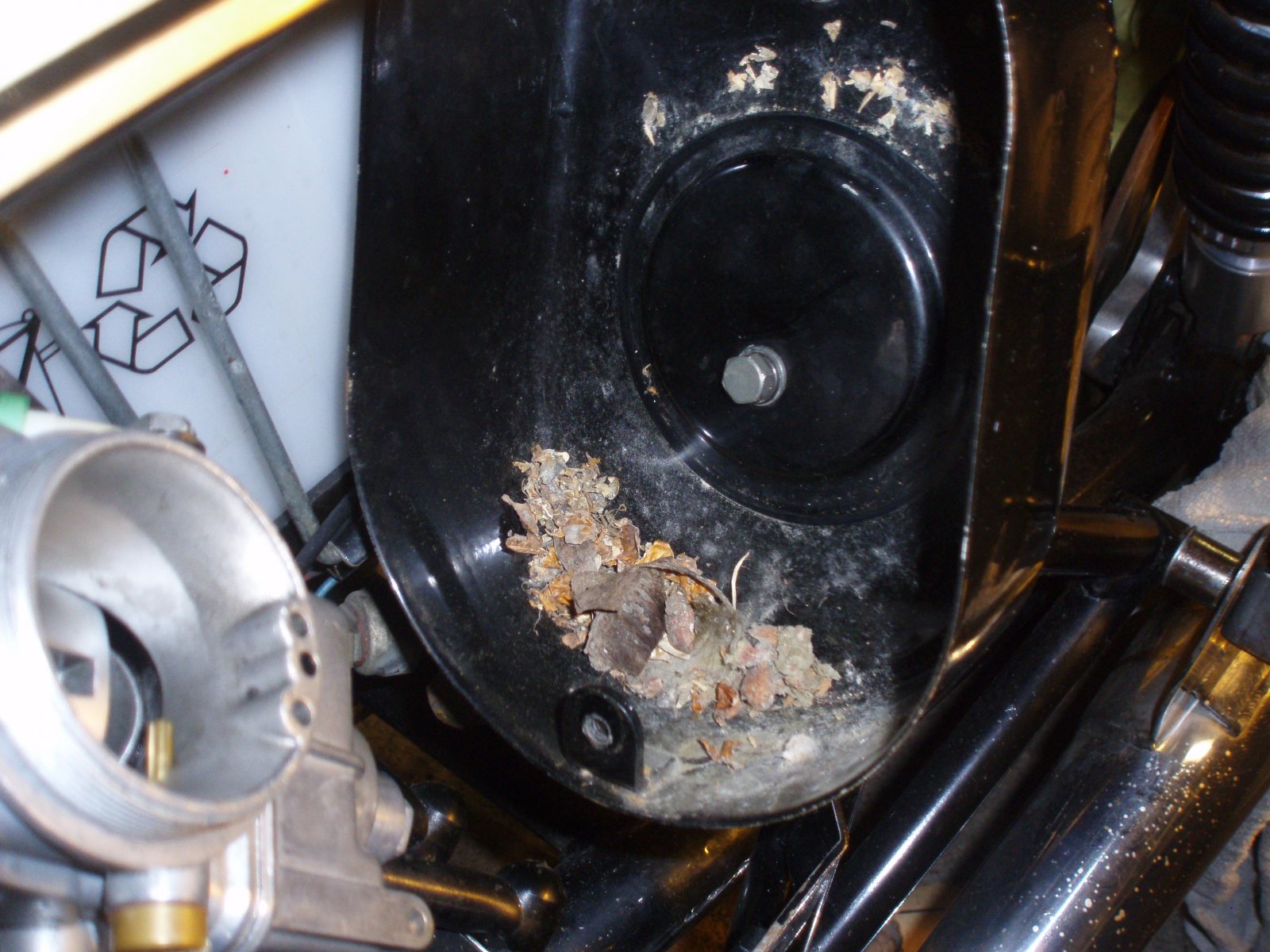

  1. The Darmah arrived last night, and it is in amazing condition. It has had a top-quality respray; and the FPS rims are perfect, not a mark or ding to be seen. All the rubber ware appears to be as-new, even the top airfilter box breather looks brand spanking new.
    I would guess that she has had a lot of money spent on her around ten years ago, as the zero-miles tyres have 2005 year markings. Small things give a hint, all the fasteners are coppa-slipped, no odd sizes or different lengths to be seen anywhere.
    The front brakes have pumped through OK, but the rear master cylinder requires new seals, on their way from Mdina.

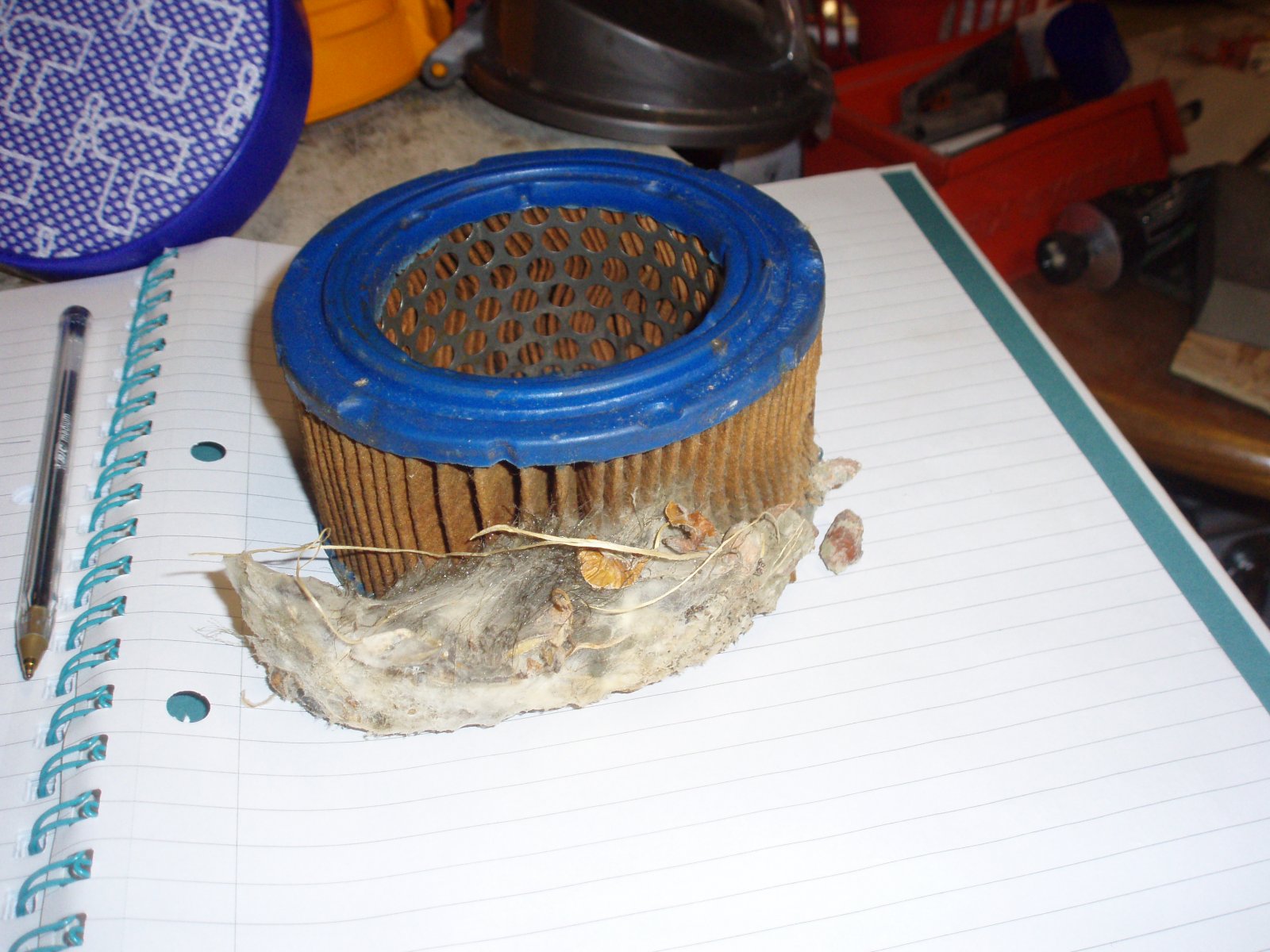

    I will also need to order some new airfilters, a mouse made his home in the rear air filter box a long time ago, the peanuts were quite mouldy and to be honest, I have tasted better !!

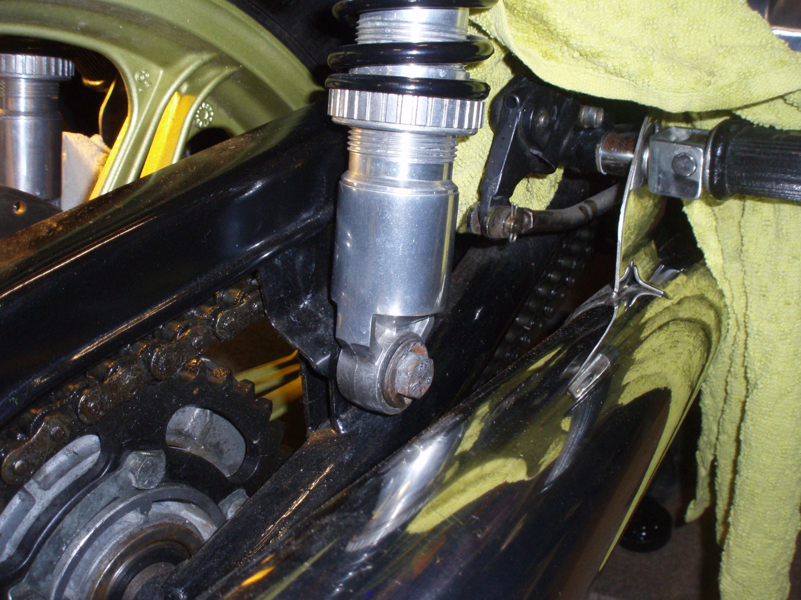

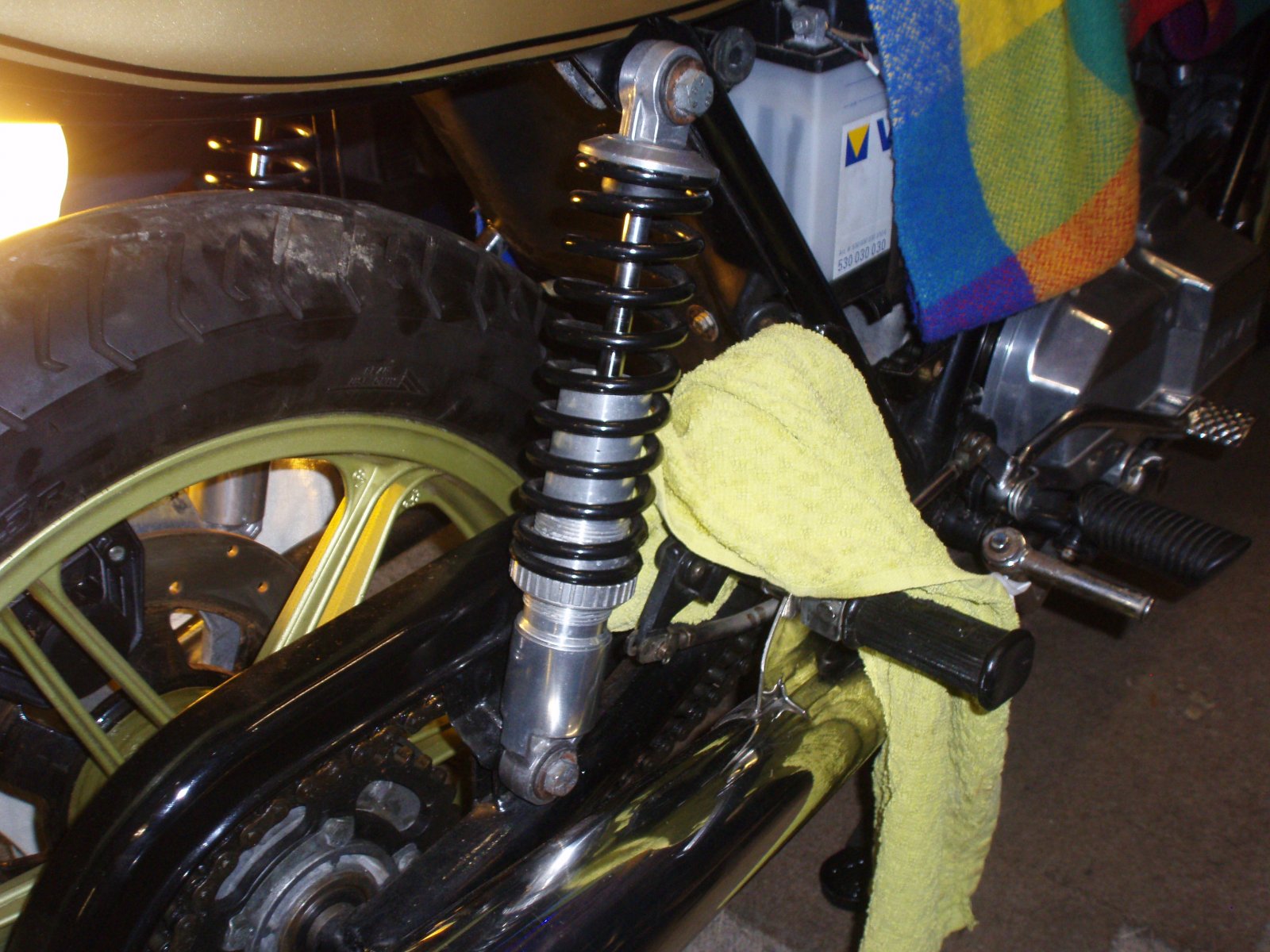

    The only thing non-standard so far are the rear shocks, they look to be a quality item, but have no name or brand marks – any ideas ??

  2. Konis?
  3. No, don't think so.
  4. I have a pair of shocks exactly like that. I got them off Bernie Adey (Spares'N'Repairs of Watford) in 1981.
