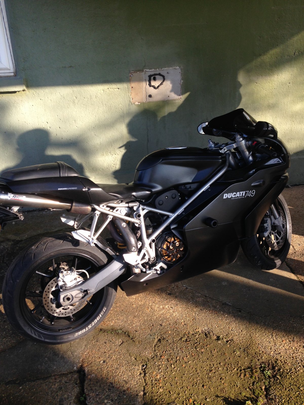

  1. Having just bought a 749 dark, 05 but with the grey swing arm, I have read a lot about the differences in the updated black arm. I have come to the conclusion that a rider of my ability would know no difference, however, as it is a dark model and the wheels have already been sprayed black, the grey arm stands out a bit. Is it a fairly easy job to change to a black swing arm or should I just get it powder coated black?

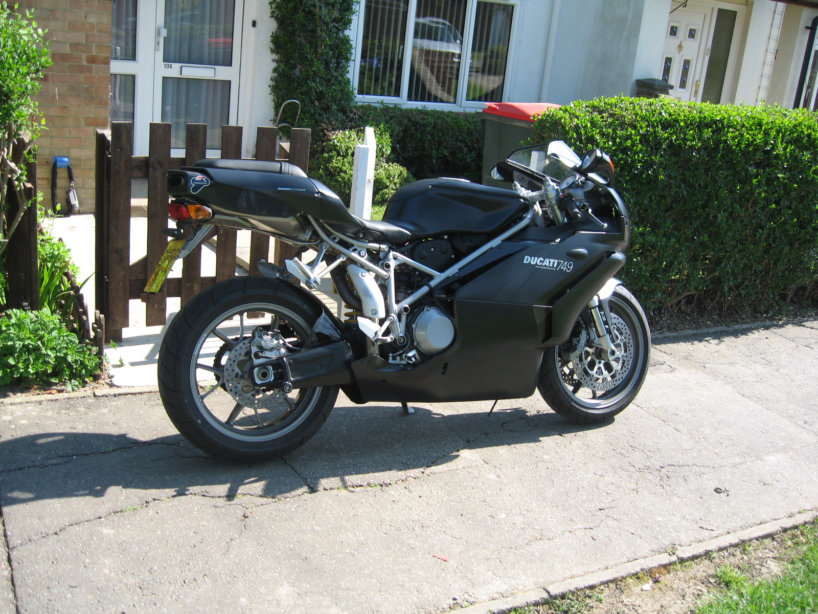

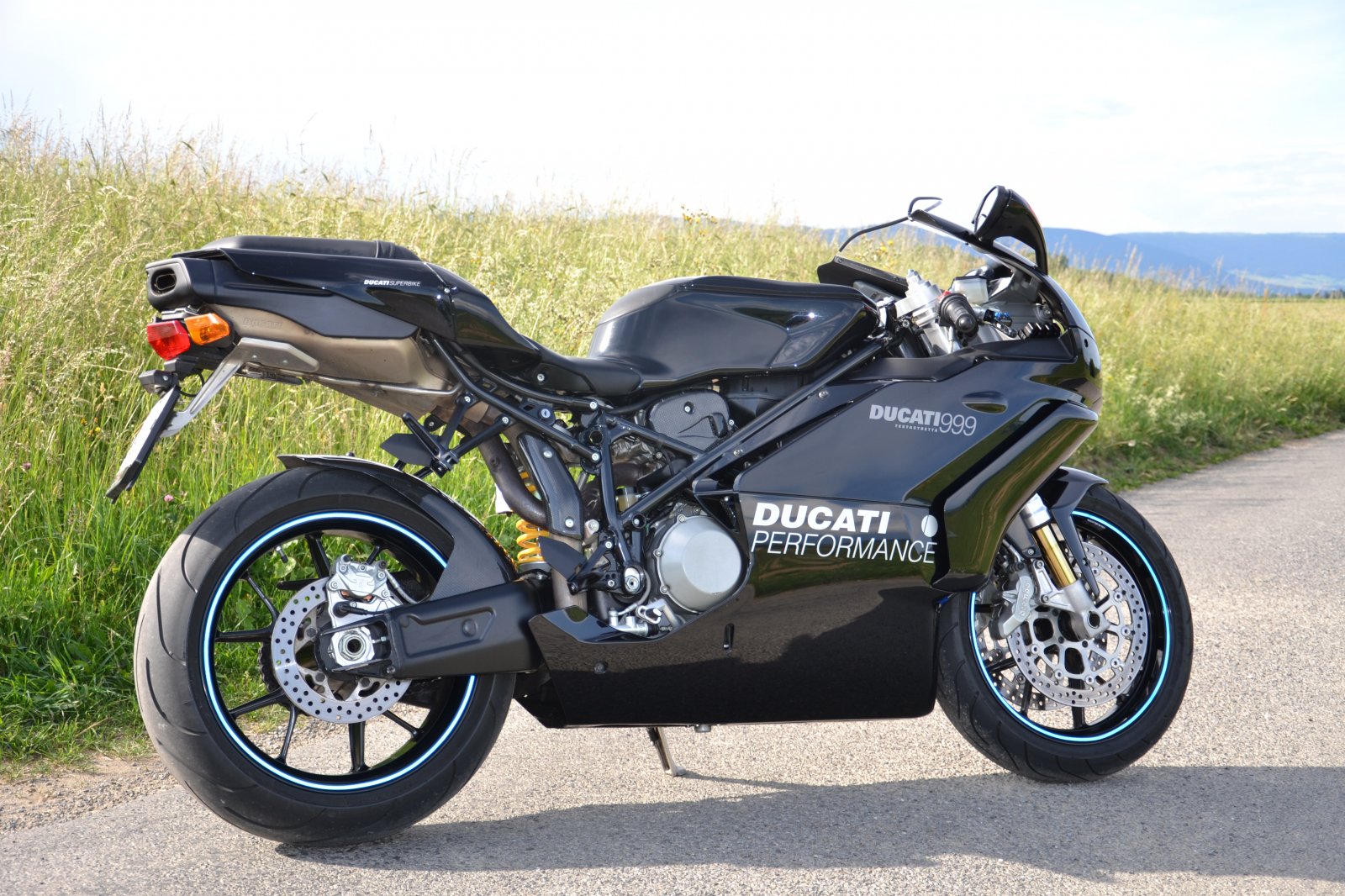

  3. I had a 749 dark 2006, black swing arm.
    And I have attached the demo I took out which was a red bike yuk but again a black swing arm.
  4. So which swing arm have you got, the one like my first pair of pics or like this?

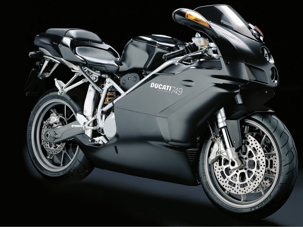

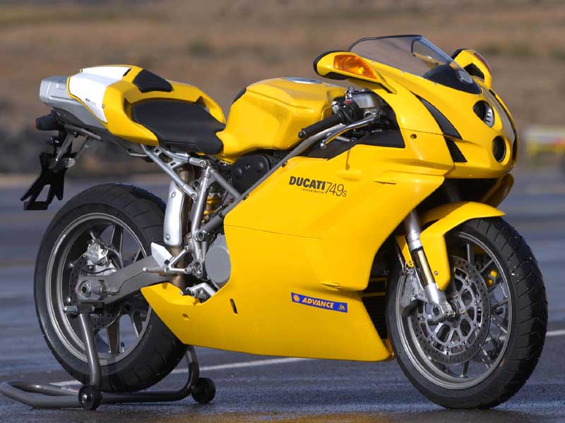

    The yellow / white with grey frame and cast swing-arm is one of my favourite combos. Would have to see pictures of the 749 Dark to pass judgement (ahem, on the original point at least :Angelic:). If it's got a grey frame I'd probably leave the swing-arm as it is?

  12. Well thanks for all the replies, even if they havent actually answered the question! I have read that being an 05 it should have the black box section arm but I must have got one of those inbetween bikes that just missed out. It does have the grey frame, but I've had the wheels sprayed black and with a few carbon bits I think the grey arm looks out of place.
    Just wanted to know how easy it is to remove the swingarm myself and get it powder coated really. Didn't realise the newer black swingarm wasn't really much of an improvement. Thanks for the info.

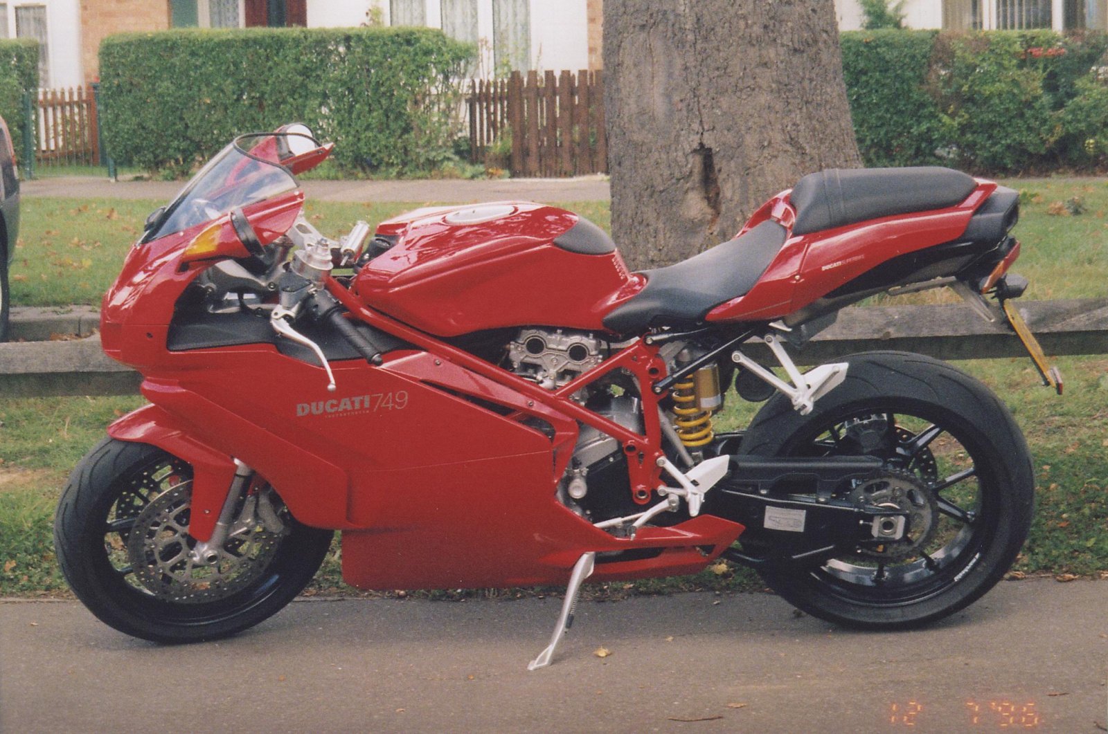

  14. very nice mate,,,,, I notice your bike also has the earlier fairing , so grey frame and swing arm are in keeping with that model .
  15. Oh didn't know that the fairings changed as well. Wonder why its an 05 plate then? Maybe it was late registered?
  16. That's a '03-'04 model which has been registered '05. It has (had) the grey wheels, frame/subframe and swingarm and also has old model belt covers and fairing.
