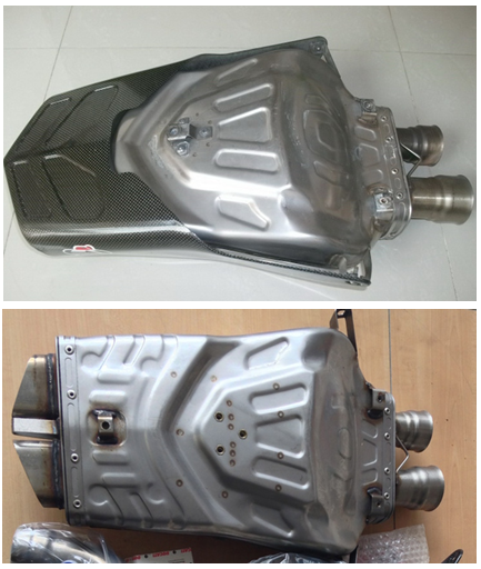

Just had bad news from my mechanic, bike is currently in for a service and he's just told me my termi box has been extensively welded in the past ,which I already knew, and it has fractured yet again, he's had his top man on it and has advised me its past repair...:anguished:. The cheapest second hand box on ebay is in Holland for the best part of £600...something I cant stretch to at the moment,looks like my only option is to refit my standard exhaust for the time being, i've never ridden a Ducati with the OE exhaust on it, how much quieter than the termi can I expect things to be?....

There seems to be a version of Termi with what looks like a larger brace plate spot welded under the top mount. I guess that would make this type a bit more resistant to cracking at least from around the mount on the top anyway.

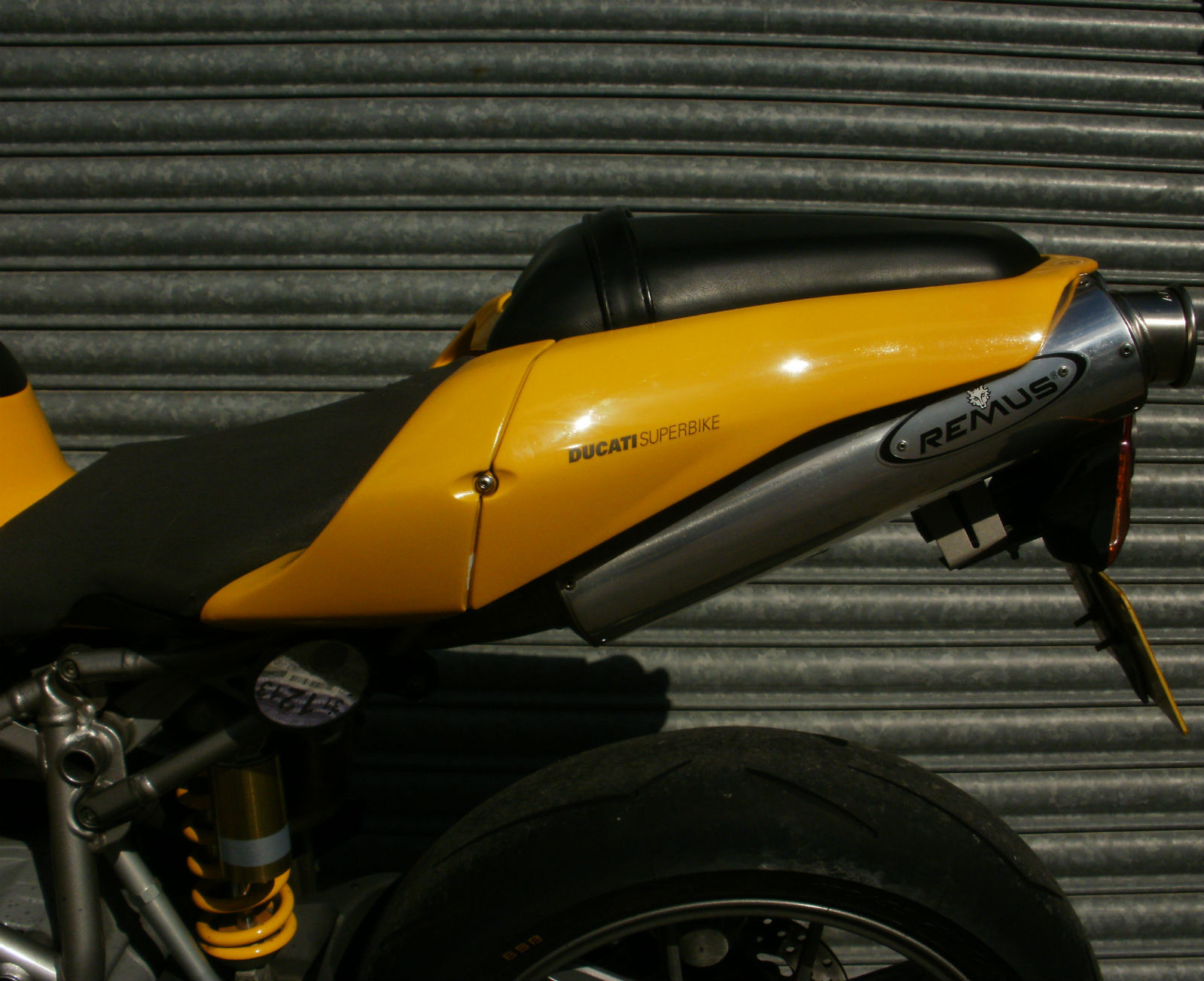

The ones in my profile pic are also stupidly loud, almost sound like completely open pipes, they came with a baffle that just made them sound awful so I ended up modifying the baffle with some perforated stainless tube. Now have a nicer deep tone without the all out noise. Slightly off topic now

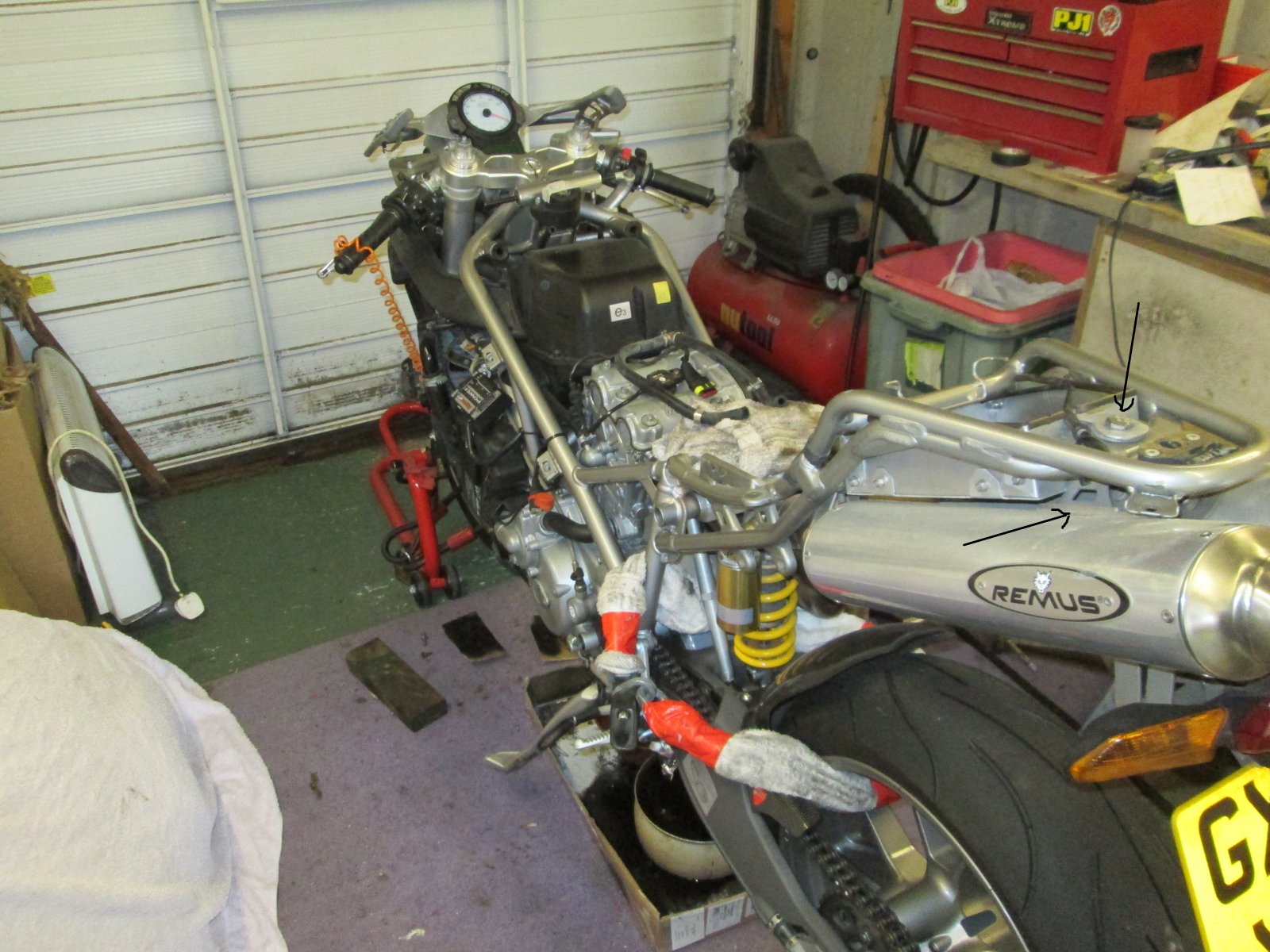

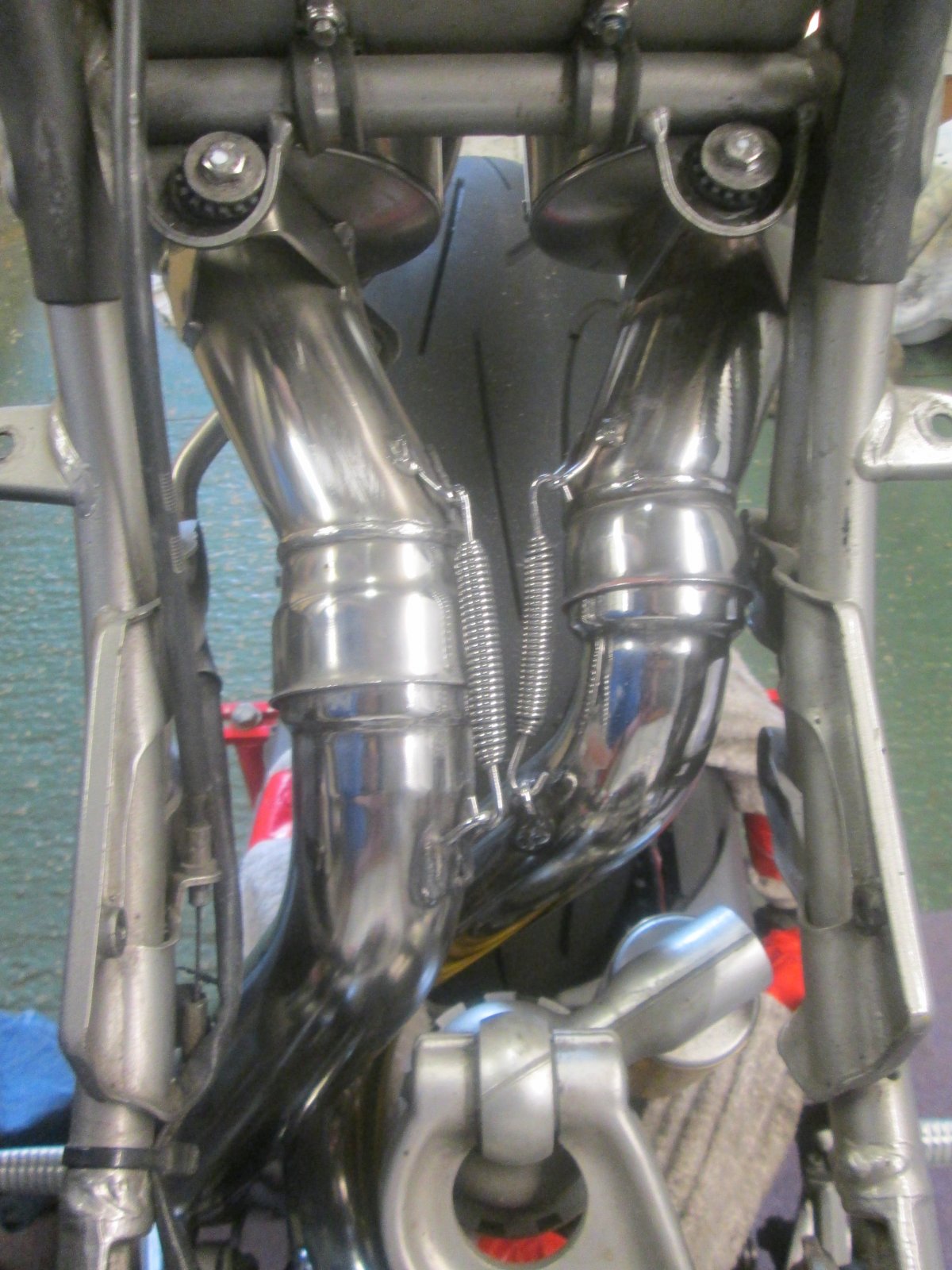

These are the only pictures I could find of the mounting points, they look like they might be the same for both. You would have to consider how much of the silencers will stick out from under the tail piece, on a mono there won`t anything to cover the tops of them like there is on the Bip. You can sort of visualize this in the second picture. Do you have any pictures or measurement for those baffles? Mine are just a disc on a bracket with a hollow tube through the middle, they were just a stop gap to get through a noise test.
