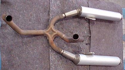

Standard exhaust? I might be way off here, but I’m not convinced that the open crossover would favour one cylinder out of one exhaust outlet completely, so if one cylinder had a problem, wouldn’t blue smoke come out of both exhausts to some extent? Is it possible that some oil has got into one of the silencers from the outlet end?
