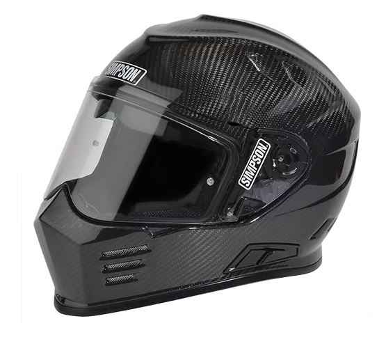

    I’m not sure I want to buy anything that would give up when wet, and my helmet at the moment is a Carbon Simpson Bandit, which fits me well and I’m really happy with, so don’t want to change it just yet.
    What was the fit issue?

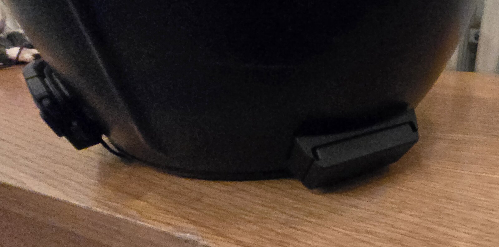

  10. The main thing (and only simpson owners would know) is the base of the helmet is very straight....if you put your simpson on a table (theres not much of a gap) between the table and the arch of the lid - the problem with the Senna was that it protruded down by about 3/4 of an inch...so when you put it on a table it rested on one side...and would scuff the bottom of the Senna. The mounting system of the interphone is on the side so, no issue. This is mine....

  12. It looks like the mount still sticks below the helmet lip :( Andy
  13. Thanks Andy.
    Looks like I'm going to have to rethink this!

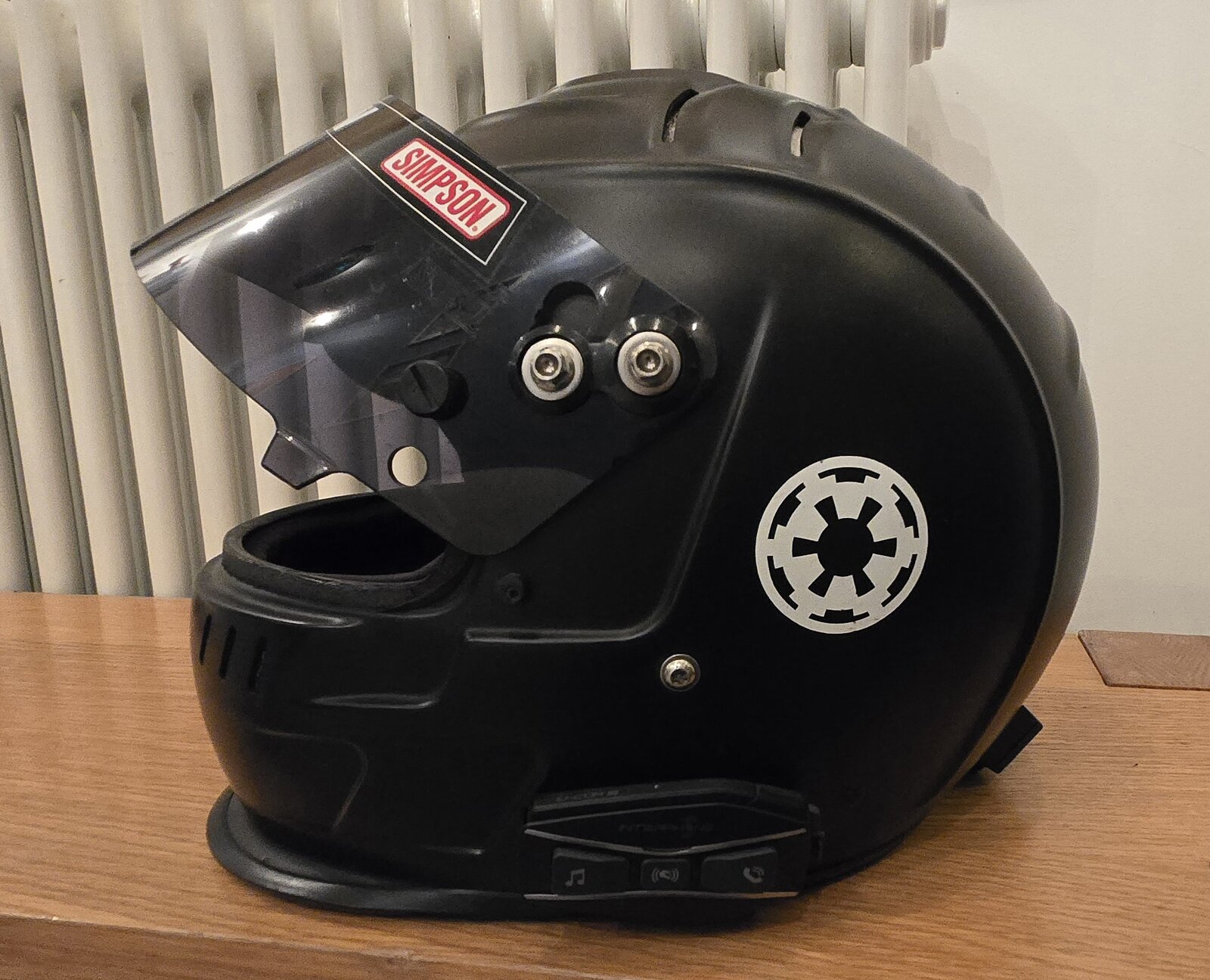

  14. I got my ucom16 in behind the lining...ill post a picture of mine later on.
  15. The only tradeoff is the battery round the back which i can live with...
