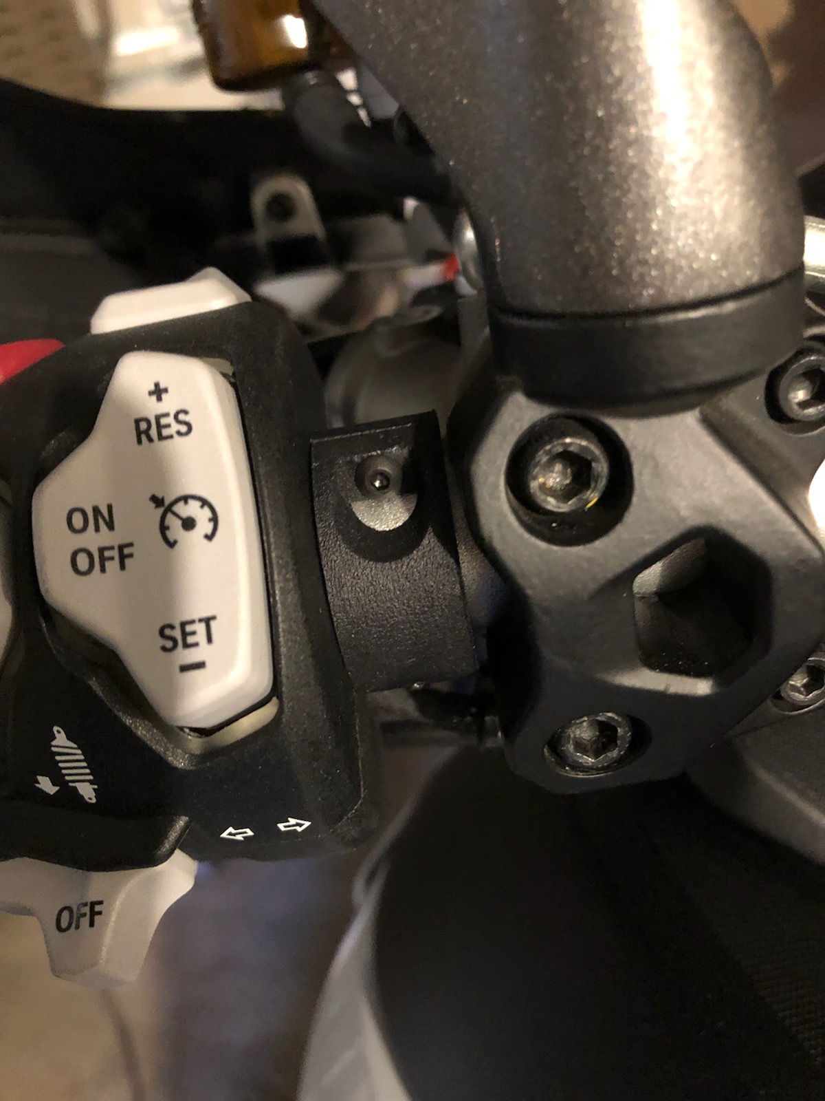

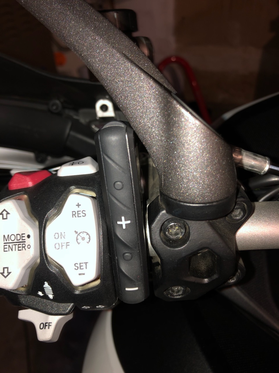

  1. recently had friends design and 3D print a set of spacers to allow the placement of a Schuberth RC4 remote control on the left handlebar of my 1260 Multi.
    the fit and finish of the parts is perfect ... and they work brilliantly. the spacers were required, as the RC4 is designed to fit on the grip ... so the diameter is too small on the bare handlebar.
    now it's much easier to control the Schuberth SC1 headset with the RC4 remote, rather than trying to fumble with the really small control buttons located on the backside of the helmet.

  2. here is the .stl file, if anyone wishes to 3D print the parts for the spacer.
    i used M3 x 8mm button head screws ... so one would need to tap the plastic parts to accept them.

  5. Fantastic! Just had mine 3D printed and installing tonight. Much better option than on the grip which always annoyed me and was in the way. I had mine printed online for about $20. You don’t need your own 3D printer. There are plenty of companies online that offer the service.
