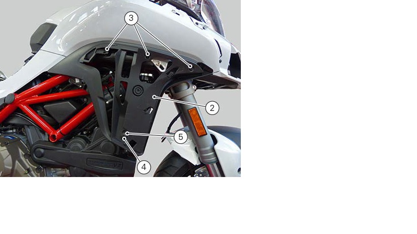

  5. Does this help?

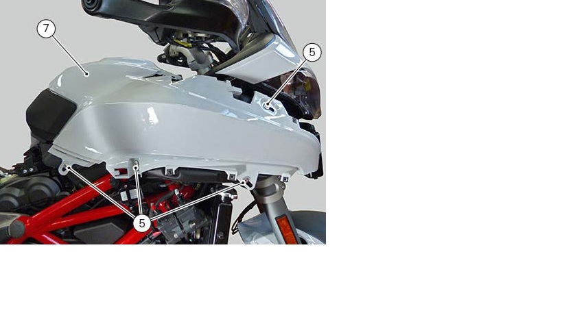

  6. Or this maybe?
  7. It does because I can see the side panel doesn't appear to connect anyway to the tank cover
  8. Paul, just sent you a pm.
  9. That's right. The outer (painted) side panel only connects to the inner (black) side panel. And the inner side panel is what connects to the tank cover.
    When reassembling, if the inner panel is not aligned exactly right, the outer panel will never align correctly.
