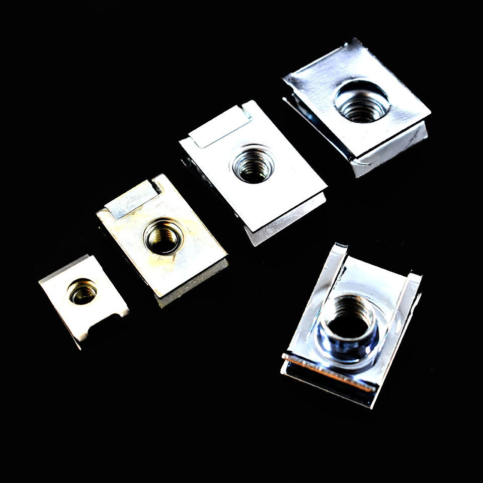

  3. i changed them for the 748E Base model fairing screws as it doesn't have Duz fasteners as standard.
    i also changed the back plate to a screw plate, from the Duz version.
