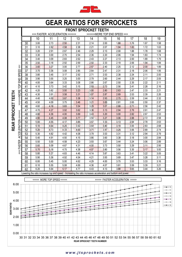

    I've made a mistake and bought a chain kit for hte 1098 with 15t front and 38rear. OEM the rear is 39. Since front is much cheaper, can I just put a 14T front sprocket and leave the 38t at the rear. This way I will up the RPM slightly. Will this work :)?

  2. Don't you go up on the rear down on the front?
  3. That's why I'm thinking about putting a 14T sprocket in the front, thats one down from the oem setup and just leave the more expensive rear sprocket at one less, that combination will give me a slightly lower rpms.

  5. Surely you are not gaining anything dropping the front and rear?
  6. The 1098 has six Cush drive/ bolts whereas the 848 has 5. Unless you have a quick detach sprocket carrier (such a Renthal, STM etc) it won’t fit.

  8. [​IMG]
  9. Bloody hell you're right, yeah this won't fit :D Does any of you perhaps know if the EK srx chains are any good? Thinking of buying it off of ebay with a both sprockets and carrier and just be done with it.
