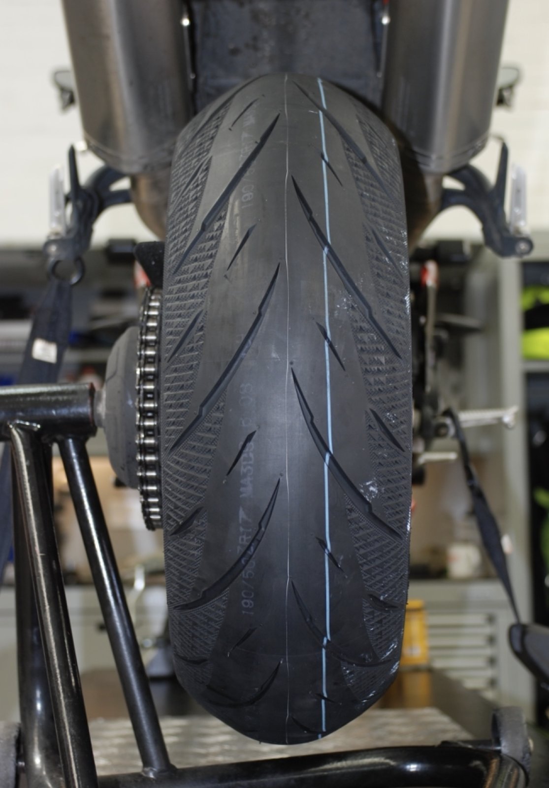

  1. After a heated debate with some friends including an ex-racer about what tyres to buy - s21 was the biggest opposition - I wondered how bad could bad tyres be?
    At Motorcycle live this year you could get Mitas Sportforce+ tyres for £99, I bought mine in march for £120 a set rather than going for what I actually wanted... Out of stubbornness that people don't know what they were talking about!
    After a summer and some quite spirited riding around the west coast of Scotland, The Answer... Honestly not that bad. The big downside is wet weather performance, in terms of feel in the dry I actually dare I say... liked them? they have a very stiff sidewall so give quite a bit of feedback and have a very very round profile which made my bike quite tippy but felt nice on the side of the tyre.
    Would I buy them again? Probably not, I mostly do fast road riding or trackdays so for me I'd rather have premium rubber under me but I was pleasantly surprised by them I have to say. Lesson learned, Explore!
  2. Personally I hate the profile of touring and sports touring tyres for fast or track riding - they are way too flat in the centre and seem to take forever to get the bike to turn.
    I use 180/60 profile on 999s and like it a lot. It does raise the rear of the bike around 10mm (vs a 180/55 or 190/50) which also helps the bike turn in better but may/not be to your liking but it's easy to adjust using the ride height adjuster.

  3. I've seen that website a while back actually, does it work??
    I think i'm the same as you, the s21 seemed almost square next to the Mitas! And next to Pirelli superbike slicks they are even worse!

  5. Yes, IMO it does help to squeeze the narrower, taller tyre on f you cant get a wider/taller one. KR 195/65 may be a shout too.
    Those touring tyres are too easy to get to the edge of when riding in track mode. :)

  8. Yes. Not a fan but thats not the profile, they had epic turn in, but the way dunlop grip. I preferred 200/60 pirelli, but you cant put that on a 5.5inch rim like the 195. Mike has run them for years and years

  11. I’m still using Maxxis Diamonds at £135 a pair. Love those tyres and they’ve a properly steep profile to them.
