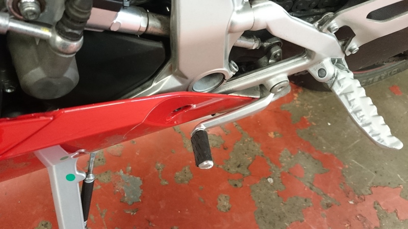

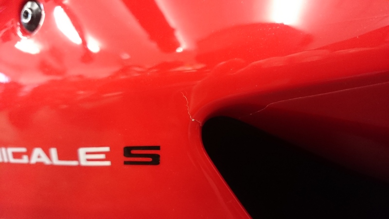

  9. So, went to see the stricken patient today to inspect the damage and have a chat with the service guys. Before I arrived, I was aware of the clutch lever and bar end being scuffed, as well as the steering pins being sheared off.
    I got there today and was shown that the gear lever was bent which in turn has impacted the lower fairing. There's a small crack in the left middle fairing and a scuff on the left mirror plastic.
    So far, the parts bill comes in at £1450. Labour will likely take that to the £2k mark. Silly AA man!
