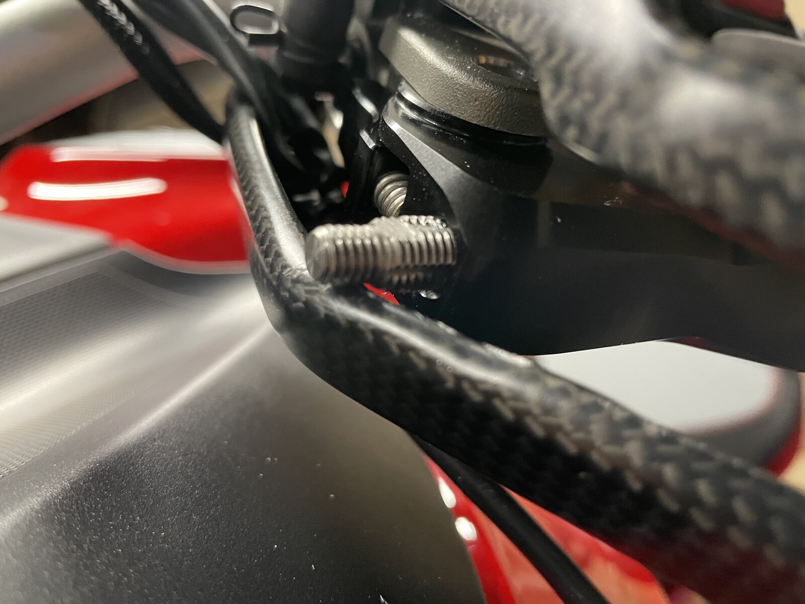

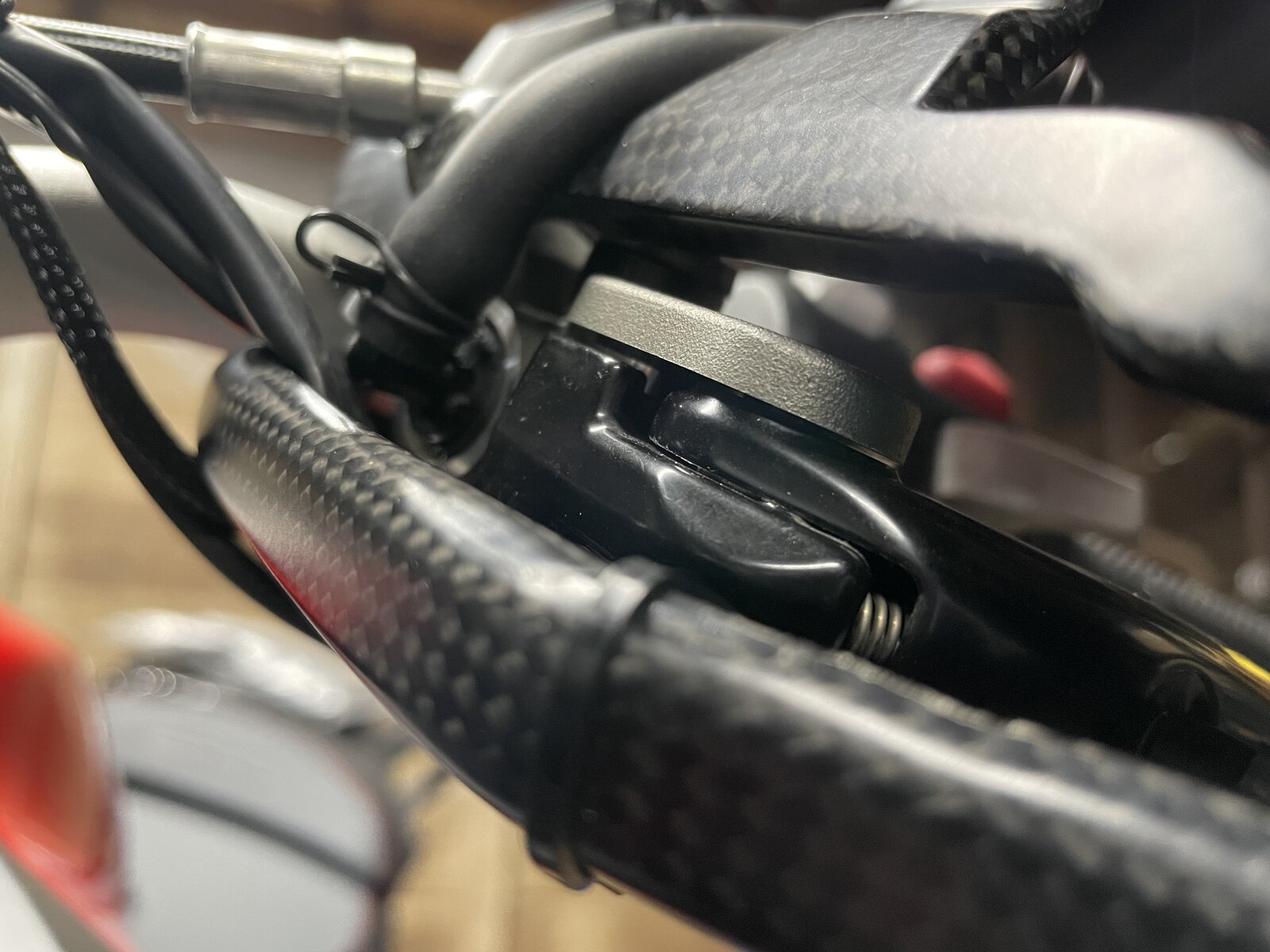

I couldn’t get the boots out, but I did get the plunger in with the ring pliers. Unfortunately, the adjustment knob hits the hand guard, so I am not going to be able to use my expensive CF levers or the anodized aluminum ones that are en route. I contemplated ditching the hand guards, but I like warm, protected fingers, plus I just paid plenty for the CF upper & lower hand guards and don’t want to have to solve for turn signals and reservoir mounts. I’ve thrown enough good money at this issue and I’m going to try to get some of it back.

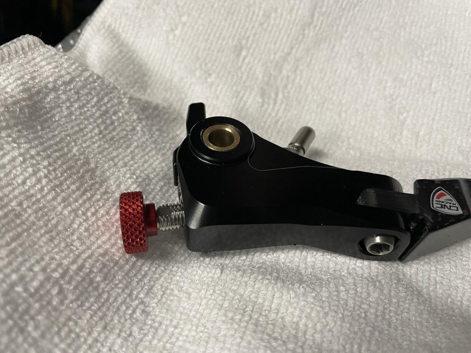

That threaded section sticking out doesn't look right. You say it is the adjustment knob but it is not a knob. It shouldn't be sticking out like that. Did the lever require some assembly by yourself? I'd like to see a picture of it off the bike as it is difficult to get context form the picture you posted.

It’s the shaft for the adjustment knob; the knob screws onto it. The stock lever’s adjustment knob is in a different place. Here are a couple of pics to illustrate - one of the CNC lever showing the knob on the shaft and another showing the space that doesn’t exist for it between the lever and handguard.
Yes I see now. I've never seen an adjuster like that on a lever. I wonder if they said it was suitable for your Multistrada? If so you have a good case for returning it for a refund as it plainly won't fit.
It’s supposed to fit the Multi - they mention that it might not work with handguards, but it’s in reference to the length of the lever (they even state it at 190mm). Length is not the issue here though.

I agree that it doesn’t look like the adjustment screw would work with the guard. I’m sure it needs a ‘top’ adjustment. Do you have the option of returning the levers and getting the Evotech or Gilles levers?
I have another package coming from CNC with another pair of levers that I expect will have the same issue; if so, I will ask for a refund of both.

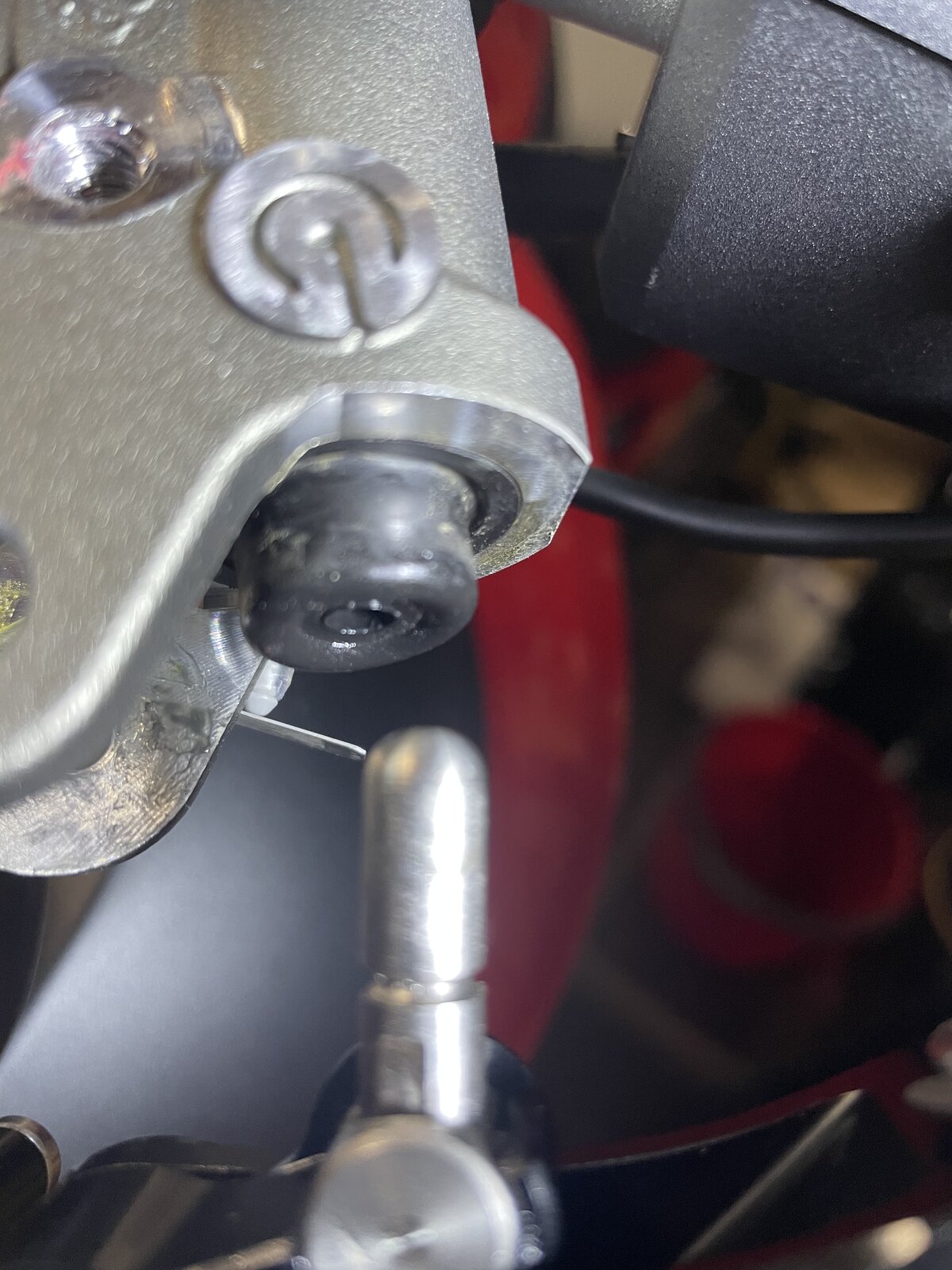

Your brake cylinder boot doesn’t look right to me, I have same levers, I’d take boot out and refit before it splits... just saying, trying to help
Does your sit further up the pin?... I greased them before putting them on and they went in quite freely. I did think the looked ‘pushed in’ but guessed that was how they should be ??
