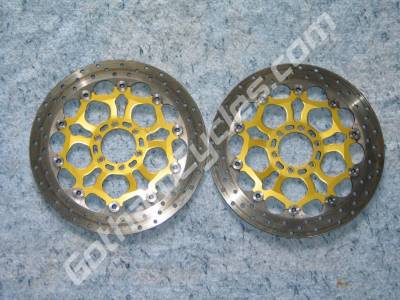

  3. There are a few different centres, as Steve says, which are all "semi" floating but have different weights.
    The first is the "pepperpot" as shown above. These are the oldest and heaviest design.
    Then you have the "straight" spoke design. These are lighter than the pepperpots. I believe these are still steel centres.
    They are the most common model and replaced the pepperpot design around 2000.
    The latest and lightest are the "snowflake" centres, which look like this.
    These were mainly used on later "S" and "R" model bikes. I believe the centres are alloy which makes them very light.
    You can also get the fully floating cast iron disks which were fitted to early trick models like the SP/SPS bikes:
    For all of the semi-floating models you can replace the rivets to make them fully floating, but to be honest I doubt you'd notice the difference!!

  7. 998's used the snowflake design even on the base models and they are alloy. The ones above are sometimes described as a keyhole design, they were fitted to 996's. The snowflake has straighter spokes

  12. Ah yes, forgot about those!
    I think those triangle design ones were fitted to some 996 and certainly the 998 base models.
    No idea if they're lighter than the snowflake ones or not - maybe just a different design!

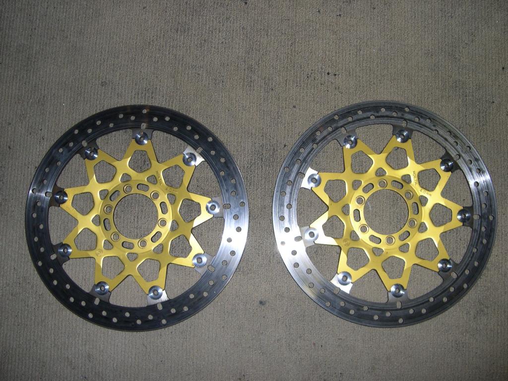

  17. Ok brake disc masterminds....
    Did all the 748R models have the 15mm off-set whether showa or ohlin forks?
    I'm looking at a set that the seller says are from a 748R but is a bit unsure how to measure/check the off-set.
    They look like these.... Which look the same as the ones fitted to my old MY2000 748R.
