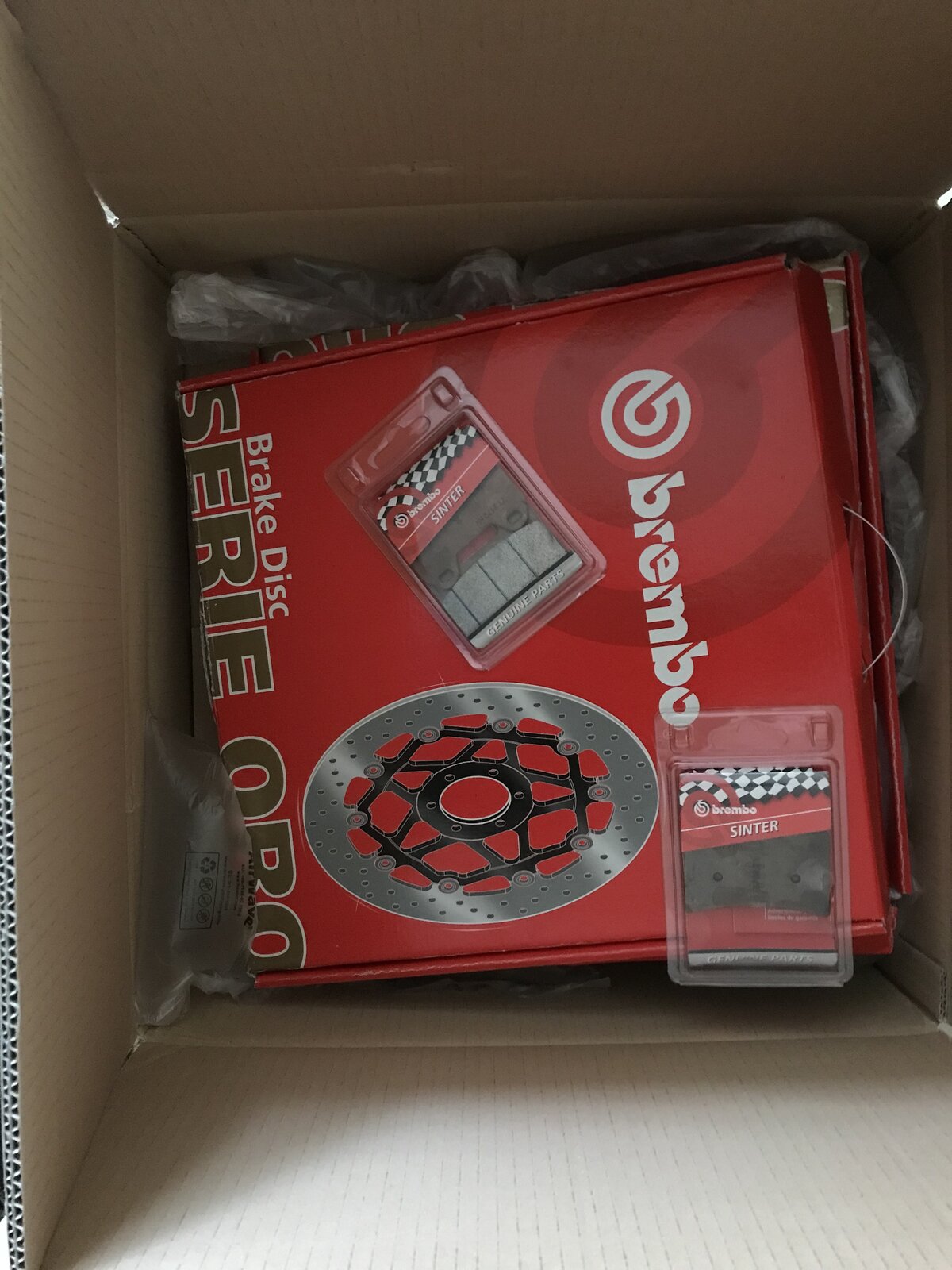

  5. Arrived last week and going in this Friday. Luckily I was in Europe for a couple of weeks so ordered them from CarpiMoto, they arrived in 3 days, well packaged, excellent email communication , great price!! Cost me £20 to book a suitcase on Ryanair to get them home.
