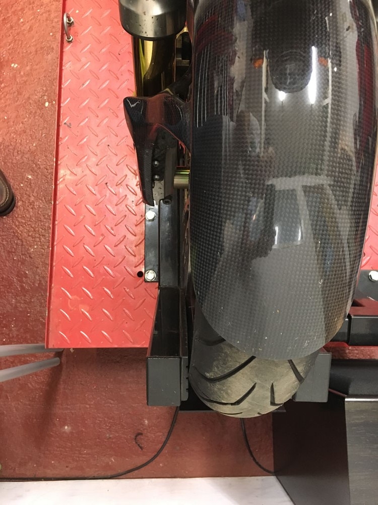

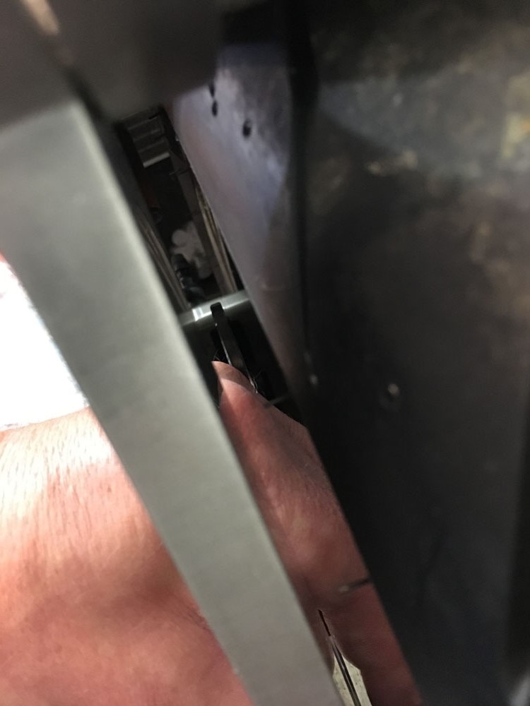

  8. A picture is worth 1000 words, they say;
    10mm offset disc;
    Straight edge on disc face to show how far 'out' from the tyre - around 3mm when central (full-floating disc);

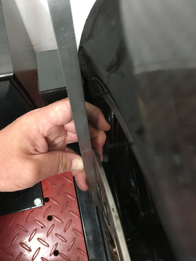

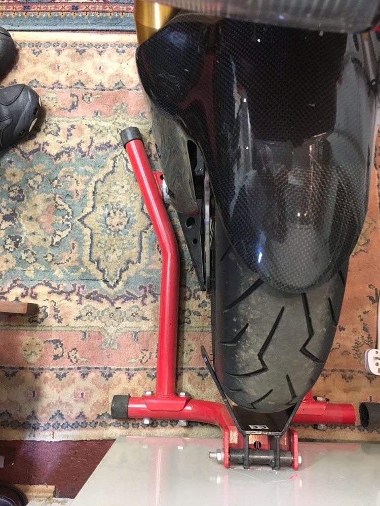

    15mm offset disc;
    Straight edge on disc face to show how far 'out' from the tyre - around 10mm when central (full-floating disc);
    Summary; the 10mm offset disc sits just outside the tyre, although only the outside edge is in direct airflow whilst the 15mm disc sits fully outside the tyre, despite it also being 1mm thicker than the 10mm disc.
    As an aside my old Guzzi discs are 50mm offset and sit 20+mm outside the tyre but it is a narrow wheel and tyre so the overall track is still slightly narrower than the Ducatis.
