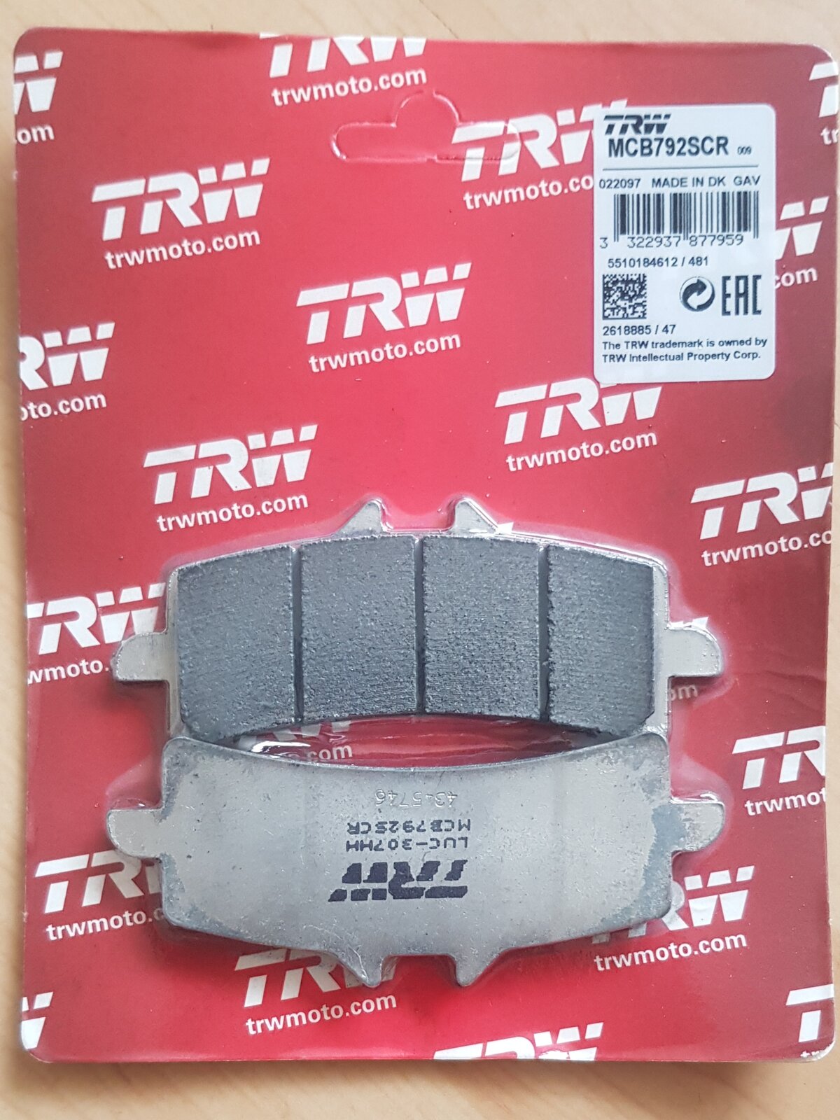

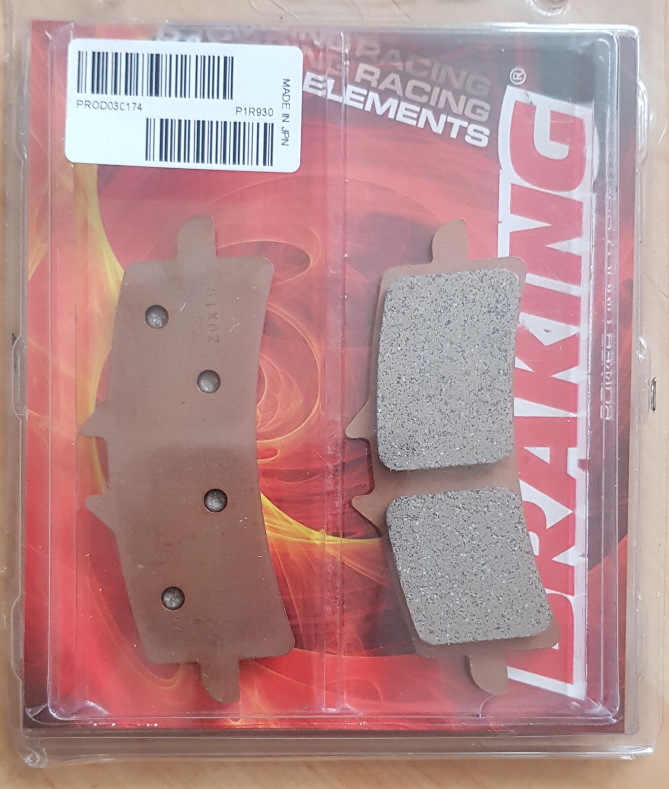

  11. Just had a look in my pit bag and I have these for my M4's.
    These should look familiar (SR's) but from TWR.
    And so should these (Z04's) but supplied by the Italian company Braking and made in Japan.
    Not tried either yet but as I'm very familiar with the Brembo SR, maybe start with the TWR's. Andy
