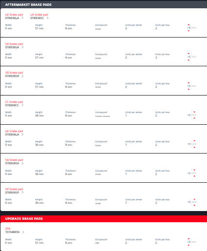

HI, I was looking for brake pads for my 2021 Multi V4 and I went on the Brembo site. They seem to have so many options that fit the bike. Does anyone here know what the below codes are for and the main differences between them? Thanks.
The codes SA, SR, CC etc refer to different materials for the pads for different situations/uses, there are also front and rear pads. If you follow this link it should take you to the correct page for the different options for your bike. I don’t think the ones you lost above are right . https://www.bremboparts.com/europe/en/catalogue-bike/ducati-multistrada-v4s/20761 37SA are the sintered pads for the front and are the ones you need imo. ps if you click on the brake pad codes in the above link it opens up the technical spec sheets and you can read about the differences.
