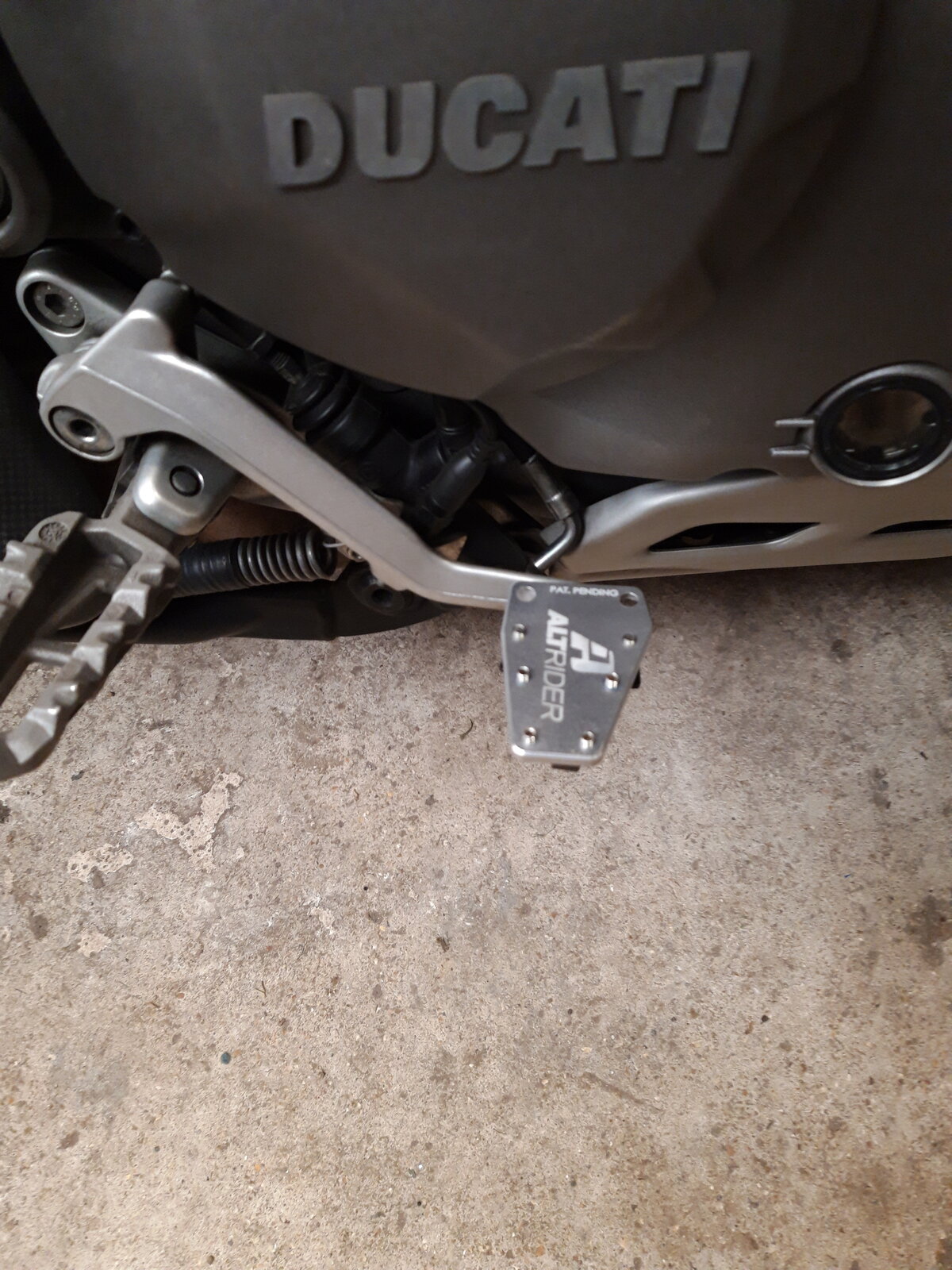

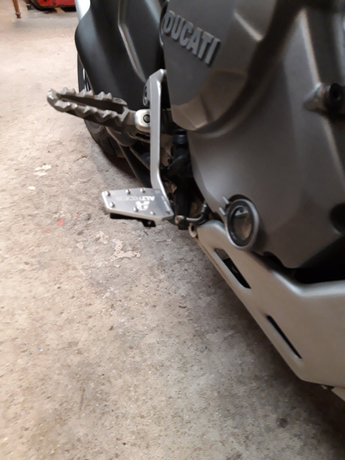

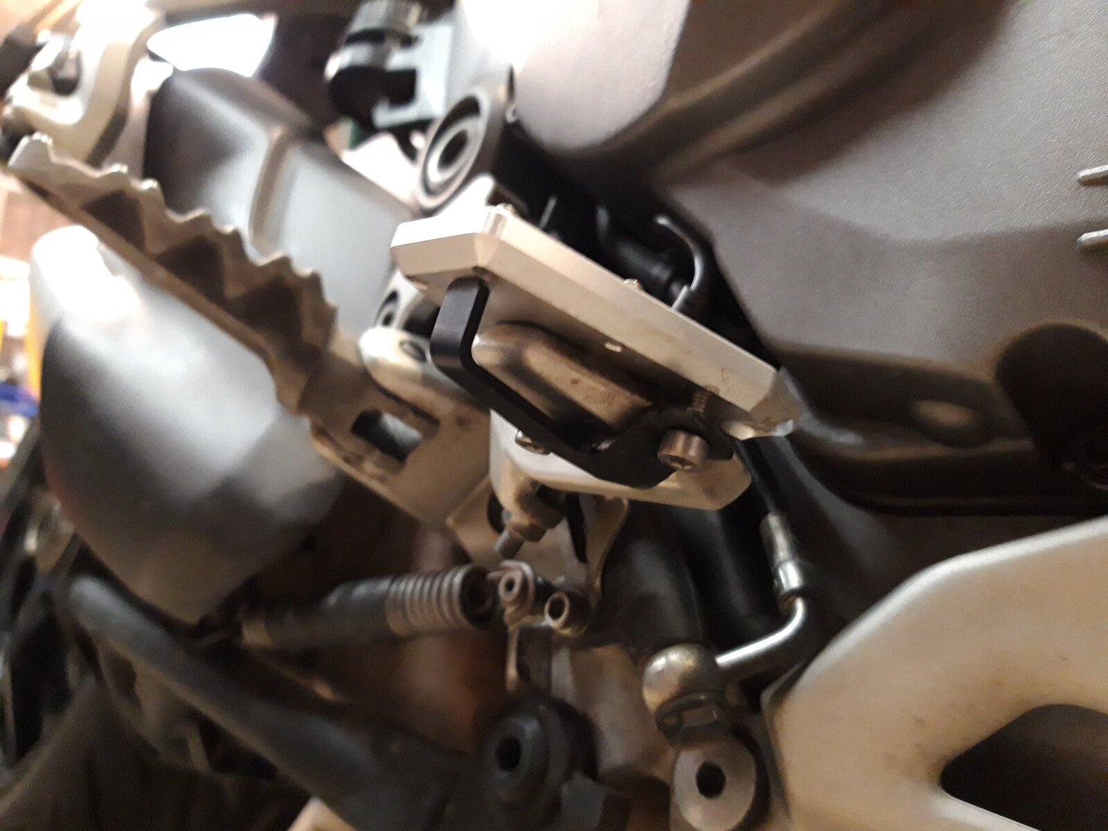

Tried out the Altrider brake pedal mod today. It works a treat. The brake pedal is now where it should have been in the first place!
Both. I now don't have to twist my foot inwards or down to reach the pedal. It raises the height by 10mm. For me it's perfect, my foot goes straight to the pedal naturally now.
Because the main problem I had was the pedal is too far to the left and I had to twist my ankle to get to it. The extra height was a bonus. I could only have achieved height adjustment by only adjusting the lever.

I think it was already wearing off due to me having to turn my ankle in so far. So I might be rub free from now on
For others looking to do this, It might also be worth looking at the enduro lever. Its steel rather than alloy, but the big advantage is the head end can be flipped over so its higher when stood up. Being steel its also easier to bend to suit your needs without risk of snapping. That might give you what you need. https://www.motorcycle.com/blog/wp-...Multistrada-1260-Enduro-STATIC-OFFROAD-18.jpg
The altrider pad kinda looks OK, but jeez, it ain't cheap Thats a lot of beer tokens for a small plate.
Good option if you can find a S/H one but looking at the cost of the individual parts it gets expensive quickly as you need the whole lever assembly.
