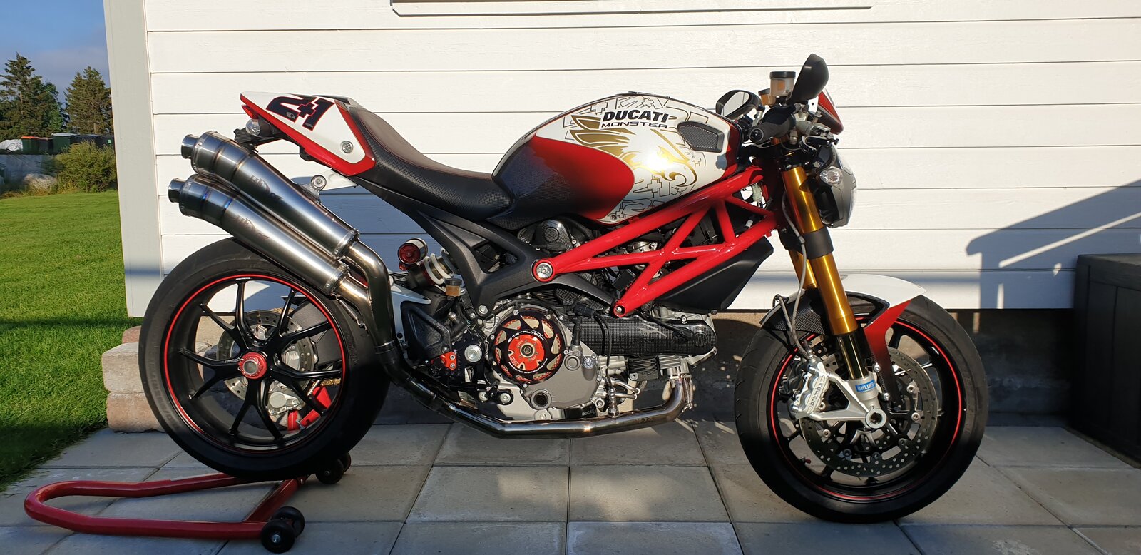

  1. Will be upgrading the brakes on my 1100 RS this winter.
    All of the brakes are original on this1100 S. What is to be fitted are Brembo M4 calipers.
    Then the big question becomes, which brake pump from Brembo should I choose for this setup ?.
    My choice is then between Brembo rcs 19 or rcs 17 ?.
    Next question will be, should I choose corsa corta or not ?.
    As I understand it, rcs 19 works best with original calipers, and rcs 17 best with upgraded calipers?
    I'm going to go for the black M4.
    I will paint the lower part of the forks also in black to match the calipers
    Price is not the most important thing here. I want the best combo.
    It is my canyon carver, and preferably this is where it will be used.

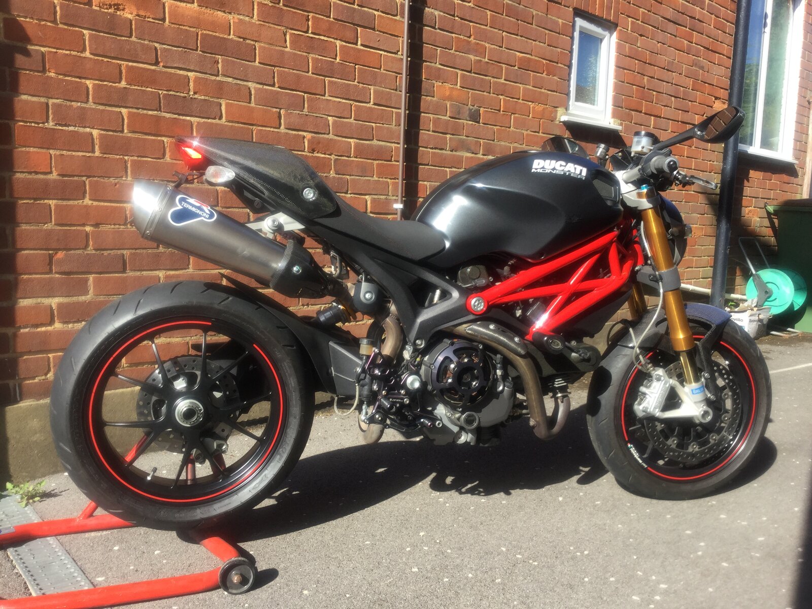

    It would have been nice to see a picture of your Monster RickyX with these rims
  4. Not a very good picture but you get the idea…
  5. Thanks for the picture RickyX
    This looks great

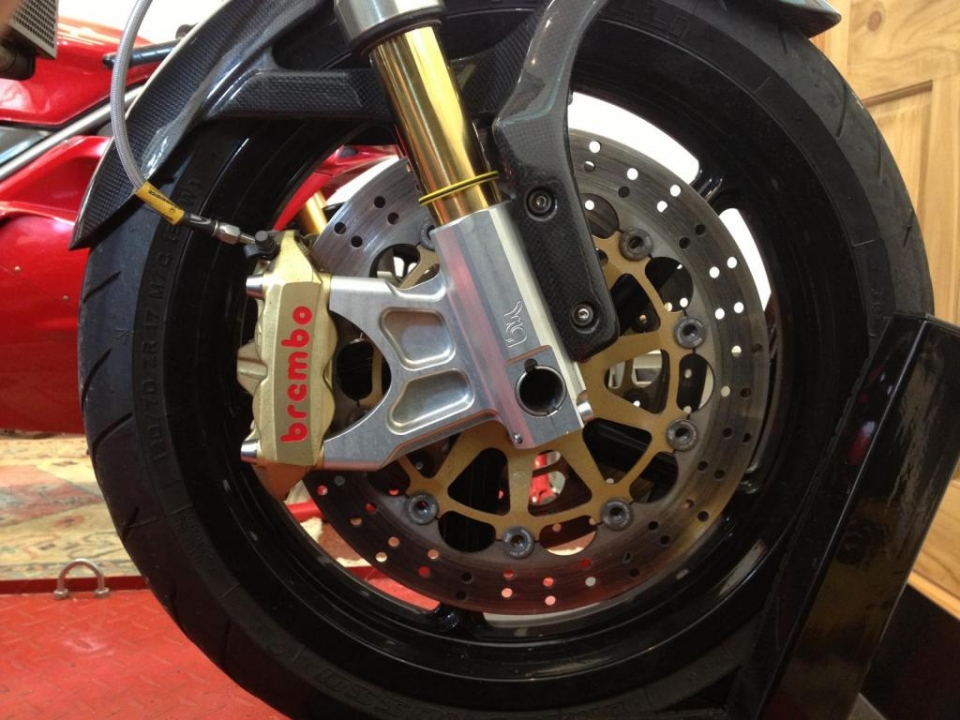

  11. I have the HPK discs and calipers on my 916 along with a 19mm, 20 ratio Brembo master cylinder (not RCS adjustable) and they work very well.
    Compared to the M4 on the Monster, I would say they are more progressive and lack the initial (fierce) bite but ultimately have superb stopping power, I couldn't say if better as both far exceed my needs/abilities. Of course there is also the difference of the bike weight etc. to consider for the difference in feel?
    With respect to the HPK discs, they are thicker than the OEM and so, presumably, handle heat better? Only criticism is that, last year I had to replace the alloy carriers as they had worn badly despite the actual disc having hardly any wear - it seems the, softer alloy, carrier is sacrificial rather than the anodised alloy buttons which (except for one) were fine.
    This is a shame as the buttons would be much cheaper to replace.
    HPK discs with original carriers;
    Wear in the carriers;
    With replacement carriers (different style);
    #11 Dukedesmo, Nov 23, 2021

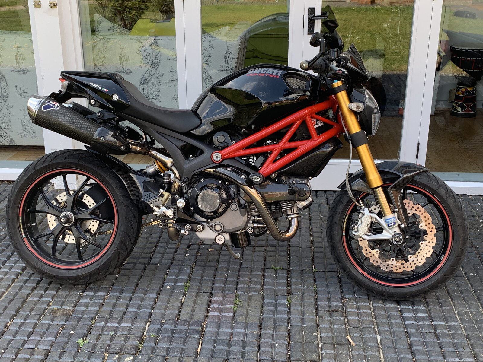

  12. RickyX I just stumbled across this. Here’s my 1100S - wavy discs. Looks just like yours, maybe you are one of the 10 previous owners? 0BBFA025-8228-485C-801D-47CF16774AE6.jpeg
  13. Not quite, but similar-ish.
    That one is gloss black, has original brake calipers, cast wheels and carbon silencers…
  14. Ah. Cant say I've found the brakes 'lacking' maybe I'm not riding hard enough. Would love some lightweight wheels though.
