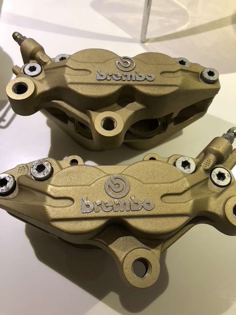

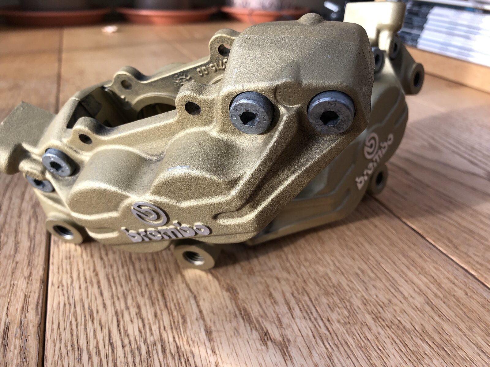

  1. The 996 SPS "resto" is slowly progressing. Attention has now turned to the front brakes.
    Callipers are off, new pads & seal/piston service kit ordered and new Hel "race" set up brake lines ordered.
    I have spent a day "toothbrushing" the callipers and assorted bolts with soapy water, Gunk & brake cleaner. As you can see from the photos, it has made a small difference, but not really what I want, having removed the whole lot.
    Is there a smarter/cleverer/more effective way of restoring the callipers ?
    Many thanks, Paul.

  16. Well, here they are, better, but not perfect.....
