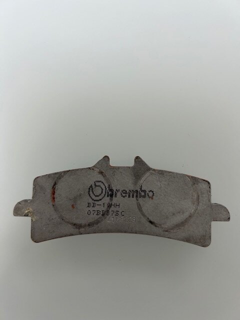

  1. I don't like the way the pistons appear not to fully cover the pads. This is the OEM original pads. Is there an issue?

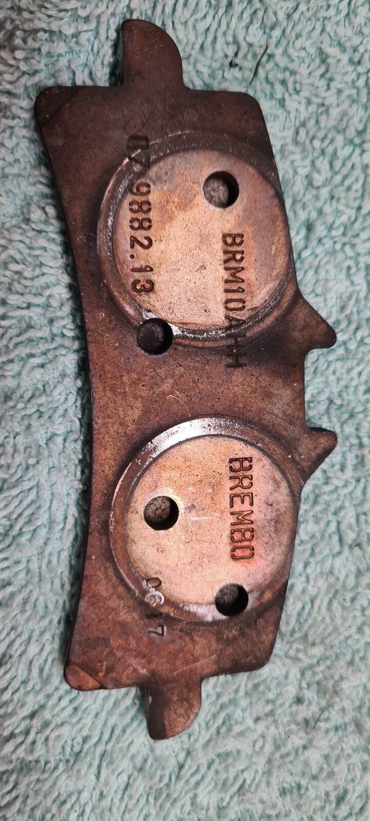

  2. Here are a pair from my panigale, looks about the same

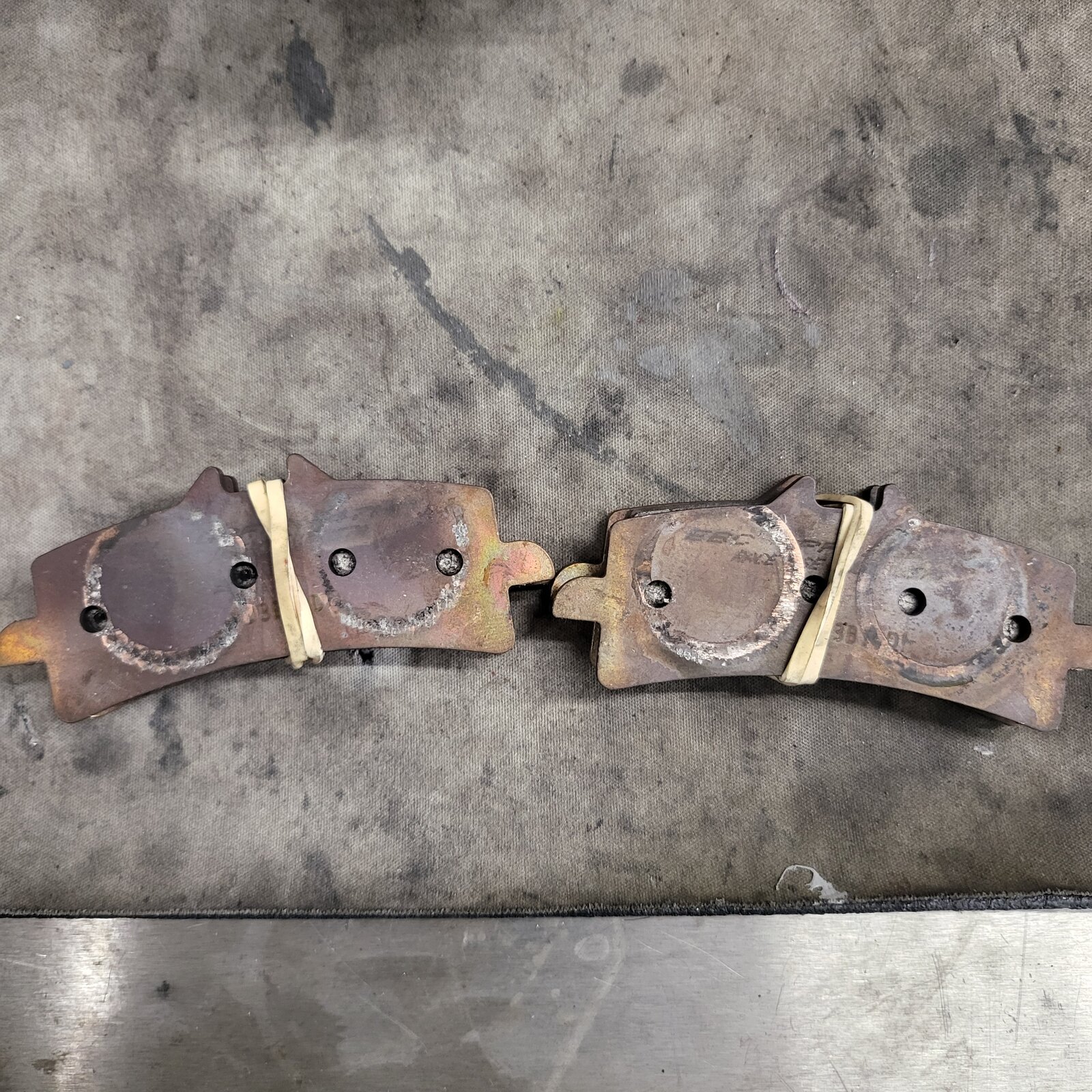

  3. Next time I’m in my garage, I’ll have a rummage, pretty sure I’ve kept some used pads for emergencies. The M4/M50 style of Brembo caliper pretty much constrains the location of the pad so as long as you are getting the level/feel of braking you’d expect, I’d not be concerned. Andy
  4. It's the same on my v4. I suspect it may be to allow flow of hot air formed from pocket in piston/pad
  5. So "they all do that" Thanks for the confirmation.
    Not great though, is it. What, 15% of the piston not making contact. Must have some twisting affect and reduce performance

  7. I would suggest also it’s to allow air to escape, bearing in mind at prolonged braking, the air pressure in the piston hollow will increase with heat. This at best would probably cause pad fluctuation.
    drilling the piston edges will be a lot of extra time and money so this is easier to do.

  11. Years ago, a lot of car manufacture would do the same. It was to stop brake squeal by slightly loading the caliper piston unevenly, thus stoping vibration. Squeal is just a very high frequency vibe. Later they moved on to stainless steel backing shims between the piston and the back of the pad, the shims had a D shaped cut out which cockled the piston ever so slightly.
