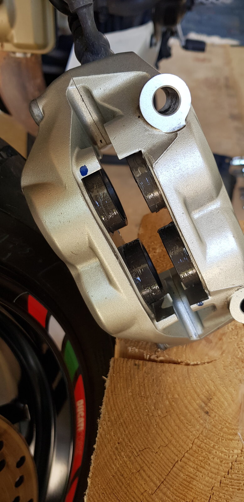

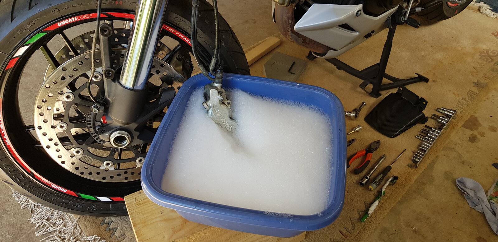

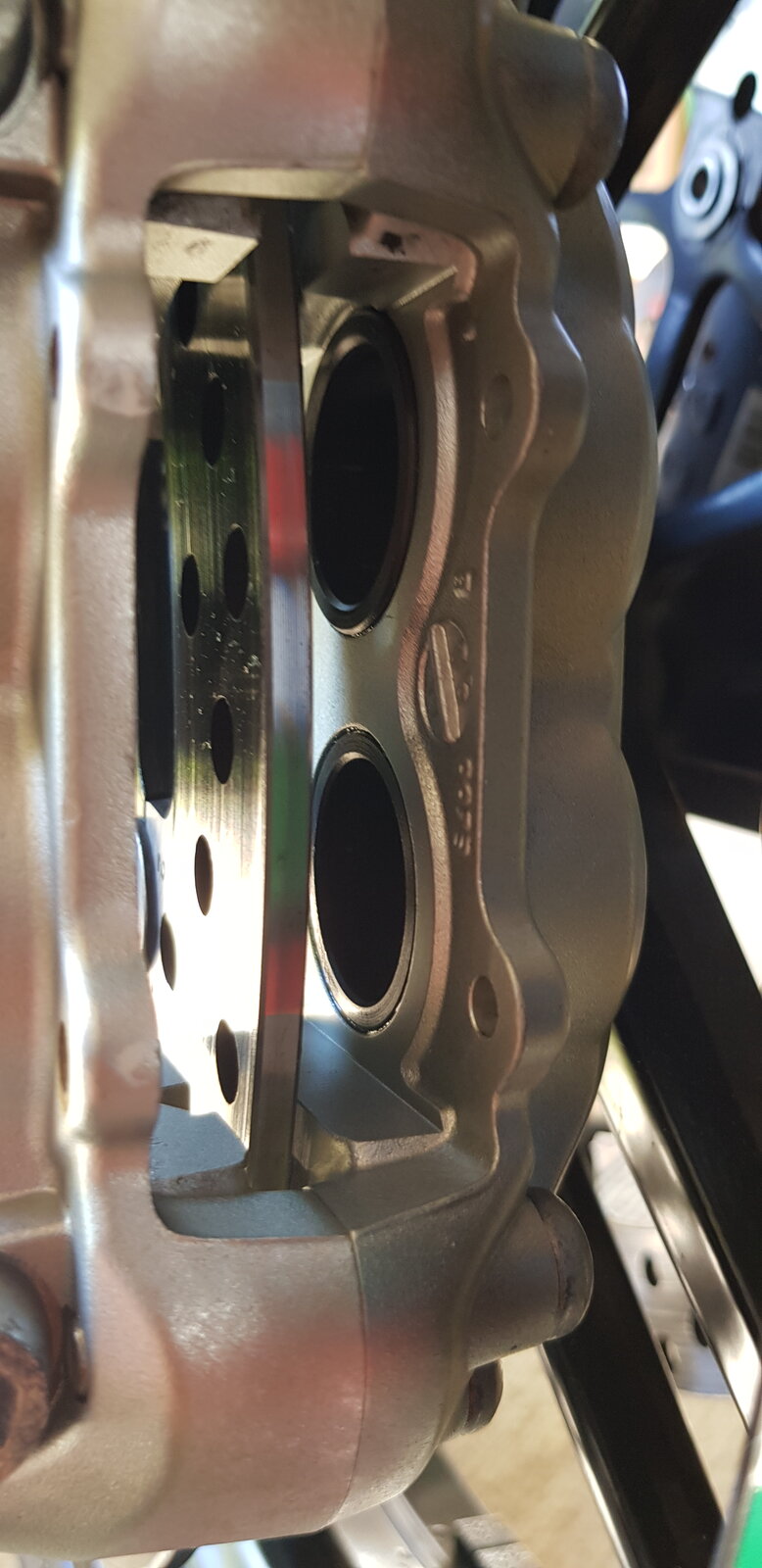

    Still not happy, I decided to remove the front callipers (brake fluid had been changed by the dealer at the Desmo Service) and check the pads and test for smooth piston movement. I found that only one piston on each calliper was moving (to my satisfaction) smoothly, so I thoroughly cleaned both callipers and each of the (eight in total) pistons. Once everything was clean and dry I lubricated each piston and then very carefully worked each piston in and out by hand until they moved smoothly and all four pistons in each calliper worked in unison.
    Now I have to say I am a professional mechanic, 35+ years, but even I had an unexpected problem with one of the pistons “popping out” during the lubricating and freeing off process. I am lucky to have all the necessary tools and equipment to deal with such a problem, but I do feel this is not a DIY job to be tackled at home unless you know exactly what you are doing and have the equipment and experience to deal with the single most important system on your bike. This is why a changed the post from a How-to, to a shorter information post.

    What did you use to clean the pistons and calipers ?
    Also, what was the issue with getting the piston back in ?

    I would still be interested to hear what you actually cleaned them with, as it looks like a bucket of soapy water :)
    I use water for the outsides, but use Silkolene brake cleaner for the inner faces around the pistons, etc when changing pads. Wondering if there is a better product.

    LOL...soapy water indeed.
    For the exterior clean, I generally use a standard alloy wheel cleaner ( Like Wonder-wheels) or similar but nothing to strong. Then indeed soapy water to dilute - remove the alloy cleaner, then compressed air to get everything dry, and finally as you already know, brake cleaner for the final clean both inside and out.

  9. Carl is there supposed to be an o ring behind the pistons? The same happened to me and I put the piston back in place, but I never checked off there was an o ring behind.
  10. I will tag him but he hasn't been here for 2years
    @CarlD
  11. Hi, just was wondering what an o ring behind the piston would be fitted for?
  12. If I’m understanding the questions correctly, there are 2 o-rings in each piston chamber, an inner fluid seal ring and an outer dust seal ring. The piston slides in/out within the o-rings.
    No o-ring, no seal, dust will get in, fluid will leak out.
    NB in cross section the rings are not circular but trapezoid.
  13. Yes, that’s my understanding of the calipers I have actually seen and stripped. I’ve not seen more than the 2 listed components in each bore. I have seen seals that are tapered and should only be fitted one way around. This type helps to return the piston slightly to reduce the pads dragging on the discs.

  15. Not sure what your after Mike. There are no orings behind the piston, just the fluid & dust seals the piston glides in/out through.
    Of you had a piston pop out just clean it, grease it (with the correct type of grease), push it back in and bleed the caliper of any air.
