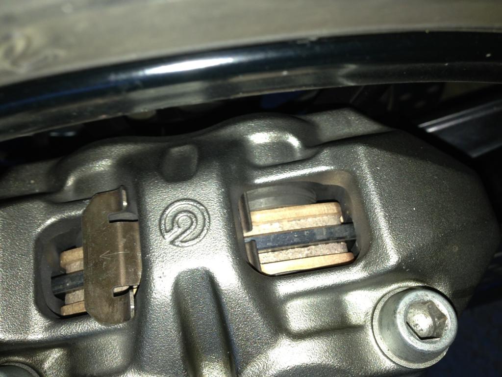

  2. I just had a thought - could this be the pads are somhow binding on the calipers, or I've fitted the pad spring wrong ?
    It was a bit of a game trying to get the spring in, so wondering if its operator error...:rolleyes:
    Daft question, but what if I ran without the spring, can the pads fall out or will they just chatter ?
    Any thoughts, or pictures as to how the spring should be fitted would be great please.

    The spring steel piece should have the long wide end at the same end as the point of the arrow, the two up ward bent pieces pointing out from the disc and against the raised bit in the centre of the caliper, the 2 tongues on the other end fit into the forks in the pad (hope that makes sense).

    No the pads don't really move that freely in the caliper. If I push them back off the disc then I can move them about, but I think the spring is holding them too tight, so experimenting now because i think the spring is fitted wrong. Will let you know how I get on.
  11. Wehey - its fixed !
    well, not completely, but miles better.
    I'm not entirely sure why, but I removed the calipers, pulled the pads & springs, pushed each of the pistons to check none were stiffer than the others.
    I thought the spring might have been wrong, but it seems the wide bits of the springs can't go in the middle cut-out of the pads, because it is way too loose then. It actually presses below one of the ears ( look at this link to see what I mean about cutout and ears: Ferodo Front Brake Pads, XRAC Racing Pads, For Brembo 1098 front brake calipers | ca-cycleworks.com ) and uses the cast web as a sort of pivot point.
    anyway, all back together, quick ride around the block with a few heavy stops, and now the wheel will rotate 3 or 4 times if I spin it when on the stand, rather than one and a half before :cool:

  14. Trying to upload some pics from my phone, thought these were meant to be easy ! Lol
    if I put the spring ends between the ears on the pad, then the spring wasn't really doing anything. It just rattled around itself (this with caliper in my hand, not fitted to bike).
    i may have it wrong, but it sort of makes sense as it holds the pads up to one end, tightly in my case.
    will have another go at posting the pics later.
  15. is it possible to misfit these shims then John? it would serve as a warning to others if it were possible. Have to say it looks pretty foolproof as if you 'splayed' the trailing ears of the shim it looks as though they would be scraping both sides of the disc?
