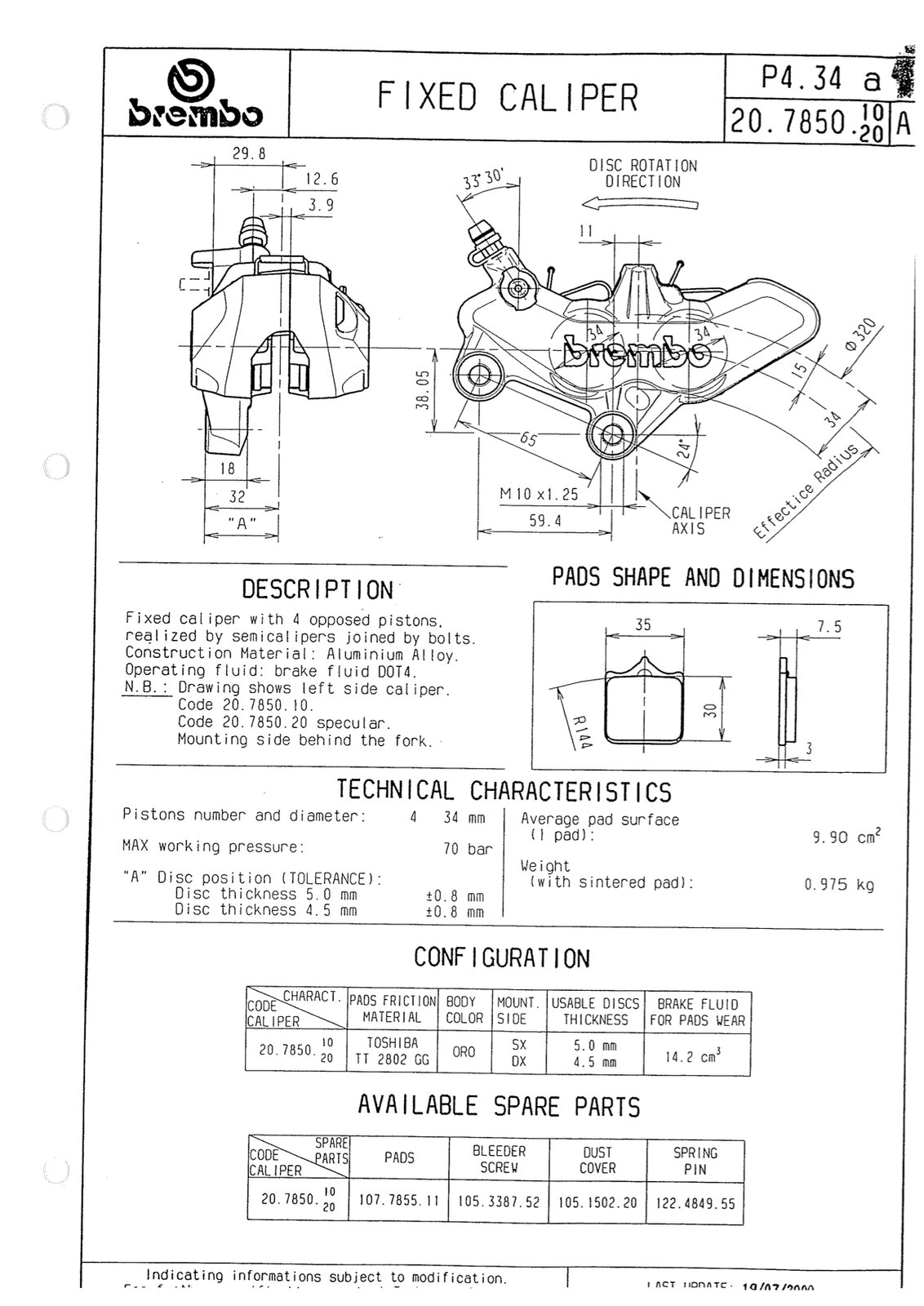

  3. Would you (or anyone else) know how many mm the Brembo front brake master cylinder of the 998S in fact is (factory brake setup)?
    This would assist greatly in searching for an alternative solution.
  4. I can’t remember mate but it has been done / mentioned on here a few times. I’ll see what I can dig up…
