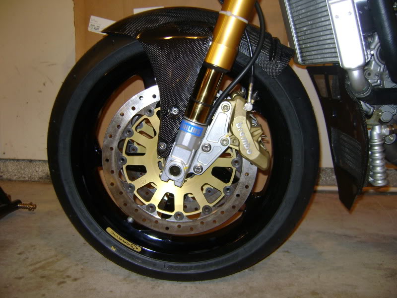

  1. I've been working on a project with a company than manufactures Brembo carriers, with a view to getting some rotors that look the same as the Brembo Narrowband discs - as used on WSBK bikes - but for Ducati road bikes.
    Genuine Narrow-band rotors have a thicker (6mm) disc with a narrower (30mm) track for use with billet calipers. These discs will be for use with regular axial and radial Ducati Superbike calipers.
    The initial motivation behind this was to have a product for the 6 hole, 15mm offset which is unique to the 748R 996R and 998R, or if you want to use Ohlins forks on a 900SS, like I am.
    However, a couple of people have asked me if these could be made in 5 hole, 15mm offset, suitable for 749, 999, S4RS, 848, 1098, 1198 and Streetfighter.
    If there's sufficient demand I guess we could look at a run of those.
    Planned specs (still to be 100% finalised) are:
    • 320mm diameter
    • fully floating
    • Stainless Steel rotor
    • 5.0mm thickness (TBC)
    • 34mm wide friction surface
    • CNC machined aluminum carrier
    • Gold anodised
    Price wise I anticipate they will cost about GBP450 a set.
    Please let me know if you're interested.
