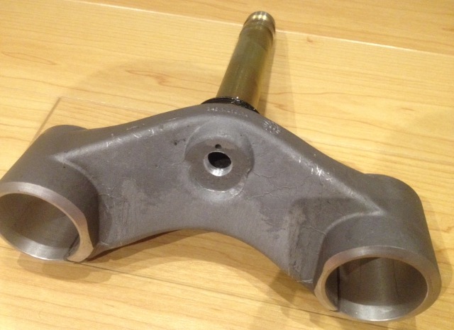

  2. Did you get the set of forks that where up on ebay . I done the swap on my 748s , got p4 calipers and found no difference so sold them on and you can use your standard discs by putting some washers between the caliper and fork leg ( I'll get a picture up ) And before you put your bottom yoke back on drill a hole to take a headstock stand ( that's what i did )
  3. Cheers dave. Already done the deal to include discs and bottom yoke. But thanks anyway! What size did you drill the hole? I've ordered a front stand with 16 MM pin and was thinking about drilling the bottom yoke 16.5?
  4. My mates going to drill it on his lathe using a 3 jaw chuck so the hole will be central to the stem.
  5. I'm using a 15mm pin so it must be around 16 / 17mm
