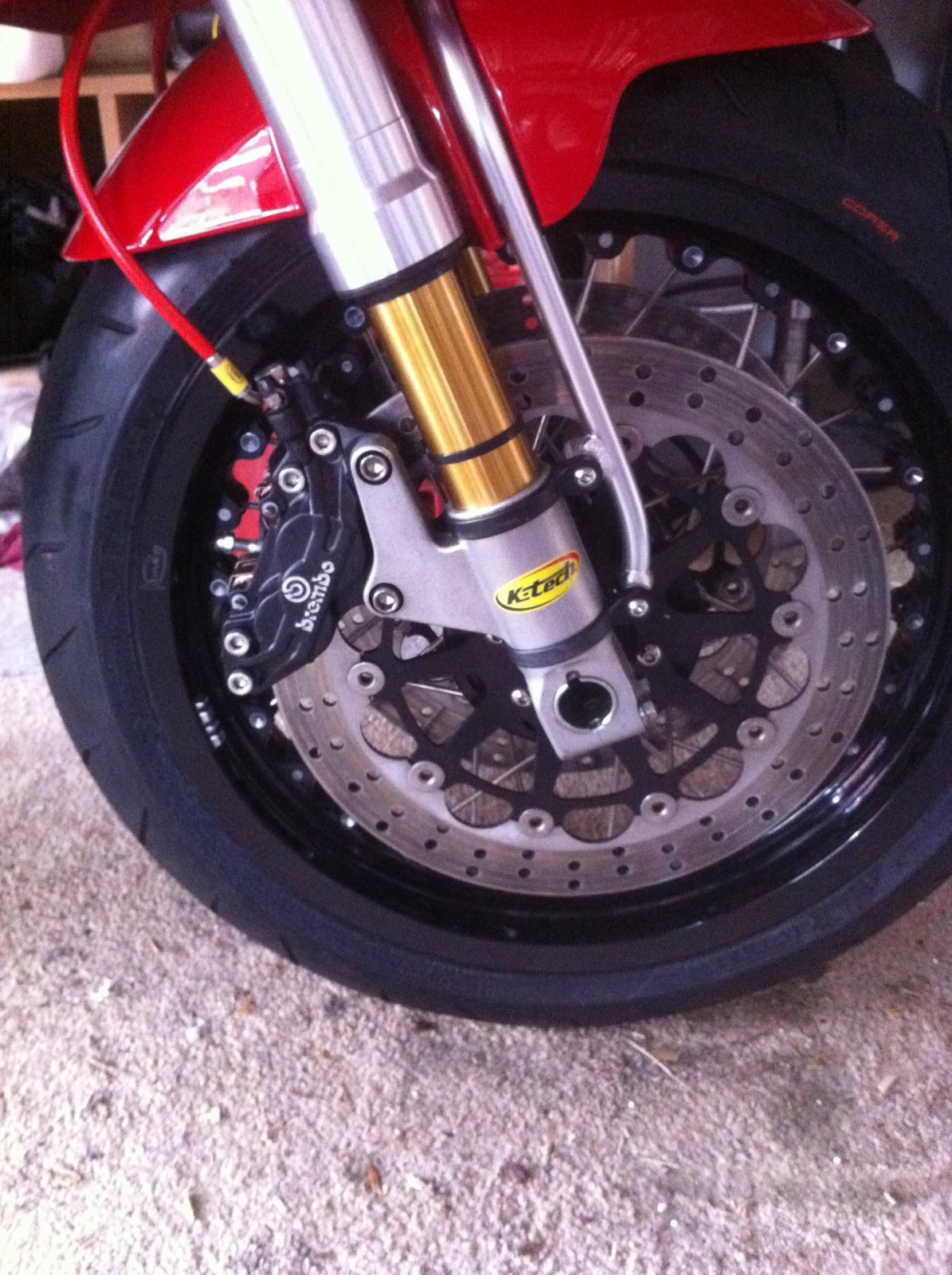

  16. Picked up a set of brembo calipers , machined them to fit and sent them off for full service and refurb , I decided on silver instead of gold. They arrived back today Aghhhhh silver looks like feck all ...... Anyone doing this choose gold, black , red even pink but not silver.
  17. Soooo is it feasible to spray calipers black, if so what paint do you use ? They really need to be mat black though .
  18. Yea it's away back , stripped , media blasted ( think that's what it's called ) re painted and oven baked, basically to factory finish.i think on this bike I can't go half measures.
  19. Brake conversion carried out , just need to bed them in.
